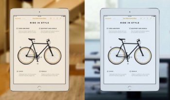

So the wide color gamut is a gimmick you are saying for the 7? The ipad pro uses the wide color gamut and you can see the differences below.
How would the screen be the same color temp if it uses a much higher contrast ratio compared to the 6s. Its been tested by display mate professionally.

So the wide color gamut is a gimmick, the ipad pro uses the wide color gamut.
Wide gamut is not a gimick. Wide gamut also does not mean yellow, green, pink or any other tint. The ipad in your pic is defective. If tint means wide gamut then my iphone 3gs had the best gamut of all time. The tints on screens have been with us for 10 years no gamut needed. Your 7 should look exactly like a 6s, with a bit better and deeper colors. No tint.

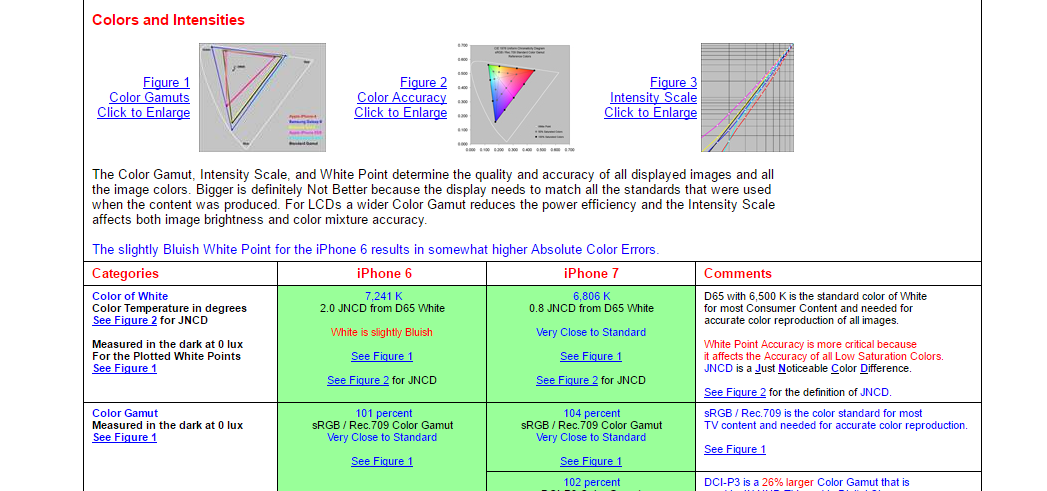

I think you should read the displaymate professional screen test they did. It says right there the 6 is slightly blue-ish and the 7 is more a natural standard white. Its right in the test, two different whites. Aka warmer display.
The iphone 7 has a kelvin rating of 6806k
The iphone 6 is a 7241k
That will be a noticeable difference in white balance. It also says 6,500 K is the standard color of White for most Consumer Content and needed accurate color reproduction of all images. So if you compare the 6s to the 7 sure the 7 will seem more yellow from what we are used to on past iPhones.
Maybe some of this can be fixed software, as far as calibration. Like calibrating a LED LCD TV.

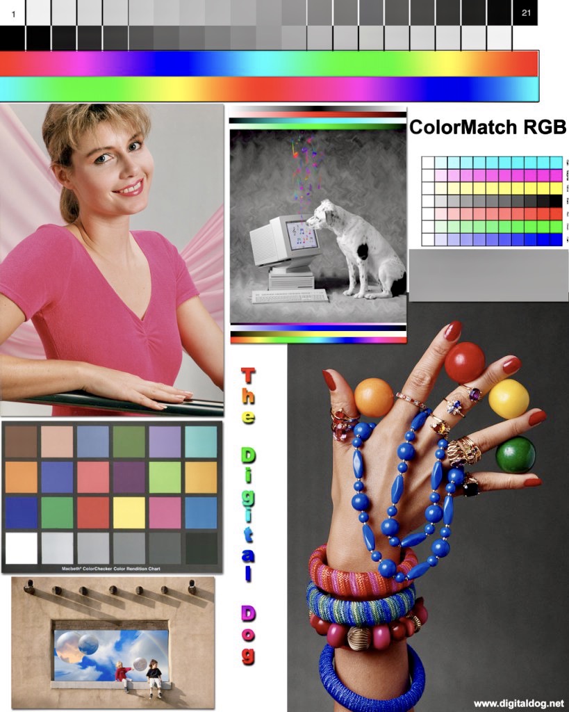

Yeah well I seemed to have fixed my color by calibrating my iPhone screen via this technique:
http://bgr.com/2016/09/29/heres-what-to-do-if-your-iphone-7-display-looks-yellow/
And I used this file to match my desktop monitor. iPhone screen looks great now!

With all the screen variability in this thread alone you are honestly telling me that the one 7 and the one 6s that displaymate got their hands on are the definitive, representaive samples for all phones ever created for those models?
Ill say this again : the displaymate test proved that displaymates 7 was warmer than displaymates 6s. Thats it. Period. It does not mean jack crap for any other phone.
Ill also say this again: 6500k is cool blue and white. So is 7000k. Neither are tinted or yellow in any way. You are 100% kidding yourself if you think 6500k is supposed to look like the phones in this thread, or the ipad in your pic. It isnt. Thats like 3500k. And its also exactly the same defect we've seen for 10 years straight. Apple didnt go warmer 10 years ago, and they arent doing it now. Period.

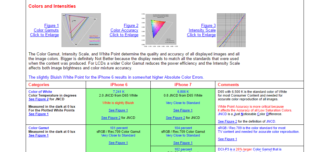

Ill say it again: You dont know that the 7 is supposed to have a warmer screen. The Displaymate tests do not verify this. There is no evidence that the 7 is "supposed"to have a warmer screen.

They have different kelvin ratings. The white balance or point of white is different. How can they be the same?

You dont know they have different kelvin ratings. All we know is that displaymates personal 7 had a different kelvin rating than displaymates personal 6s. So for those two phones only, there is a difference. Get it?
Also if your ipad looks different than others its a defect. its not meant to be warmer either.

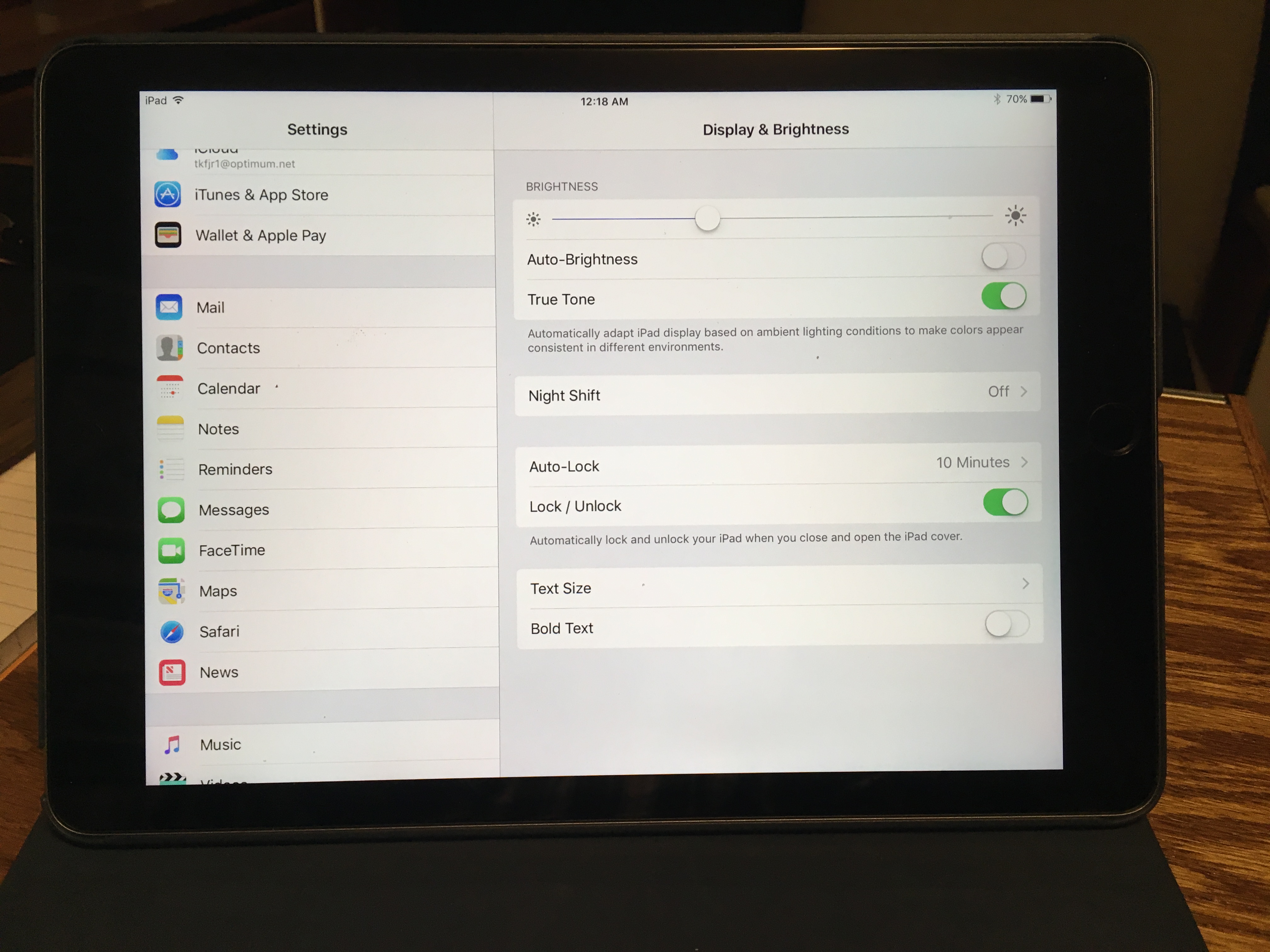

ipp is not yellowish even at low brightness. incidentally that pic is under 2600k LED lighting.
