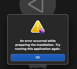

The installer fails multiple times even after a fresh reboot, the fail occurs after the installer runs and you click "Restart", it fails to bless the drive.
"An error occurred while preparing the installation. Try running this application again."
Installer log says:
"Oct 25 15:22:36 server osishelperd[1263]: ====== BLESS STDERR END ======
Oct 25 15:22:36 server osishelperd[1263]: Bless failed with error num: 3
Oct 25 15:22:36 server osinstallersetupd[1243]: -[OSISHelperProxy blessUpdateBundleAtPath:mutableProductPath:enclosingMountPoint:]_block_invoke_2: Error Domain=com.apple.bless Code=3 "(null)"
Oct 25 15:22:36 server osinstallersetupd[1243]: Unable to setup bless on disk."

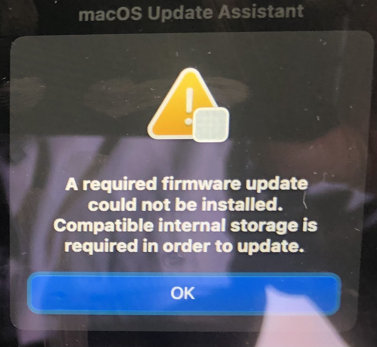

NOT well tested, Apple! MacBookPro11,5 mid 2015 MBP 15".
Zapped PRAM and rebooted into MaOS Setup Utility, apparently with a firmware update, apparently part of the Monerey update process. Got the following, see photo attached. Apple FAIL.

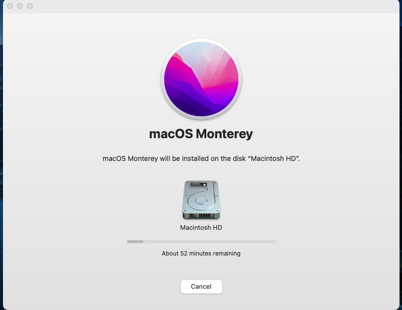

still cannot install (see image, produced after Restart ok)
downloaded installer trice, tried several times in normal mode and safe boot mode
Did first aid on the the components of the APFS drive as suggested above. Returns with OK, though several 'warning:eek:rphan omap mappings found for....."
