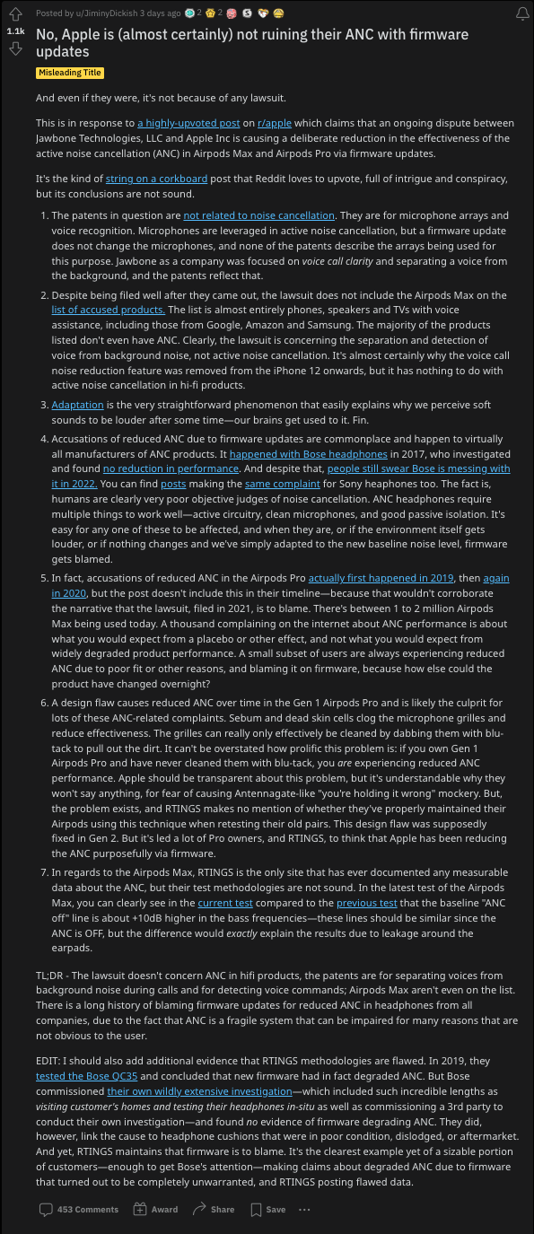

"1. The patents in question are not related to noise cancellation"
Patents: 8,019,091, 7,246,058, 8,280,072, 8,321,213, 8,326,611, 10,779,080, 11,122,357 and 8,467,543.

Those are all patents for DSP processes particular to identifying voice signals and separating voices from background noise, every single one. None of them have anything to do with traditional phase cancellation. You can't bold "noise suppression" without reading the entire patent summary and classification. According to RPX the suits pertain to Google and Amazon voice assistant devices, not hifi devices with ANC.
