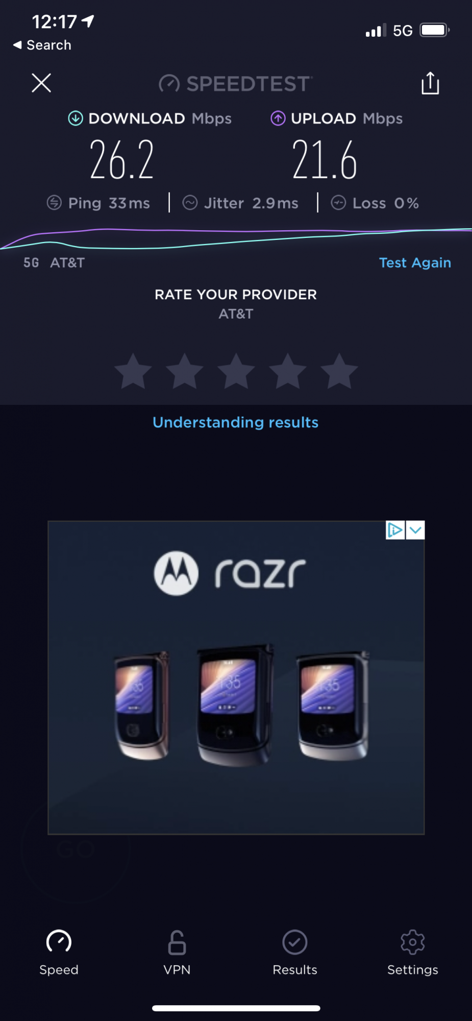

Not sure if this will help anybody, but the rep I chatted with said: "I have updated the device IMEI under the plan to get 5G access." It started working after that.
I’m not too impressed with the speed thus far but I am in my house. Will see if it gets any better throughout the day as I travel.

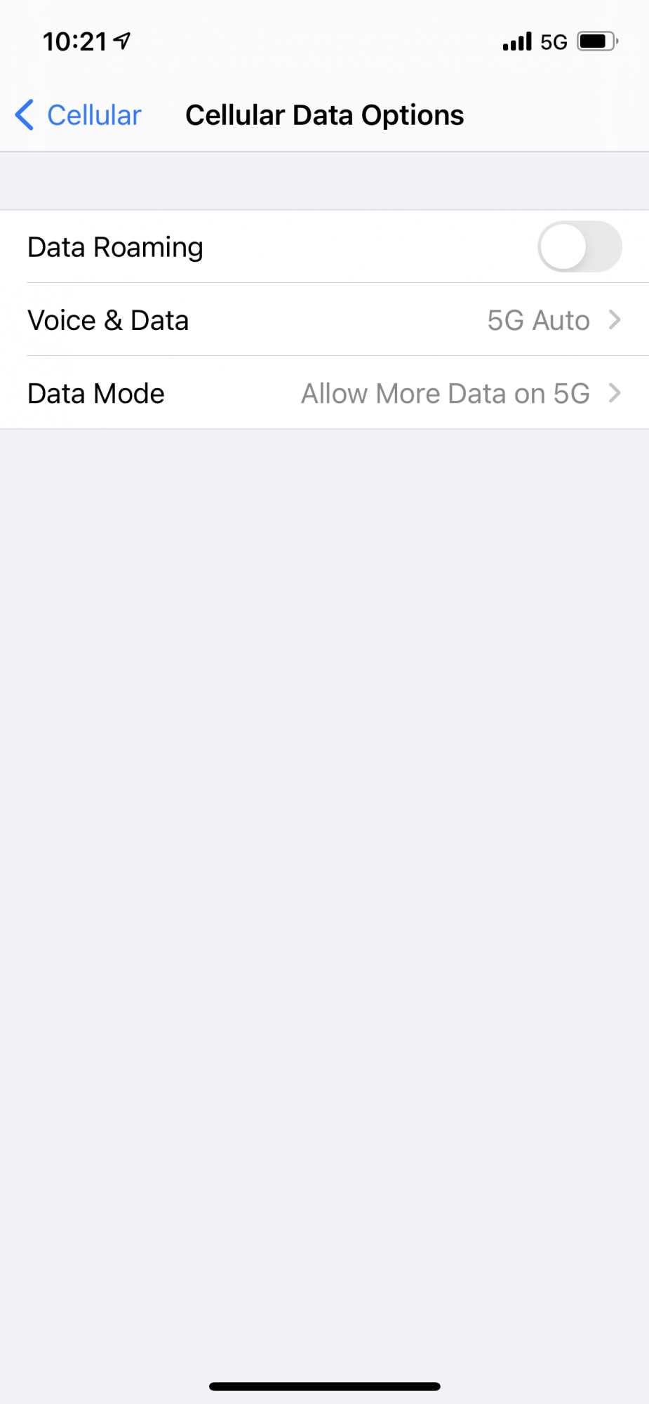

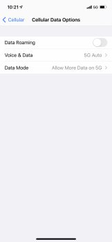

It should look like this.
Just found this. I also think you can do this online? Feel like I’ve seen it somewhere.

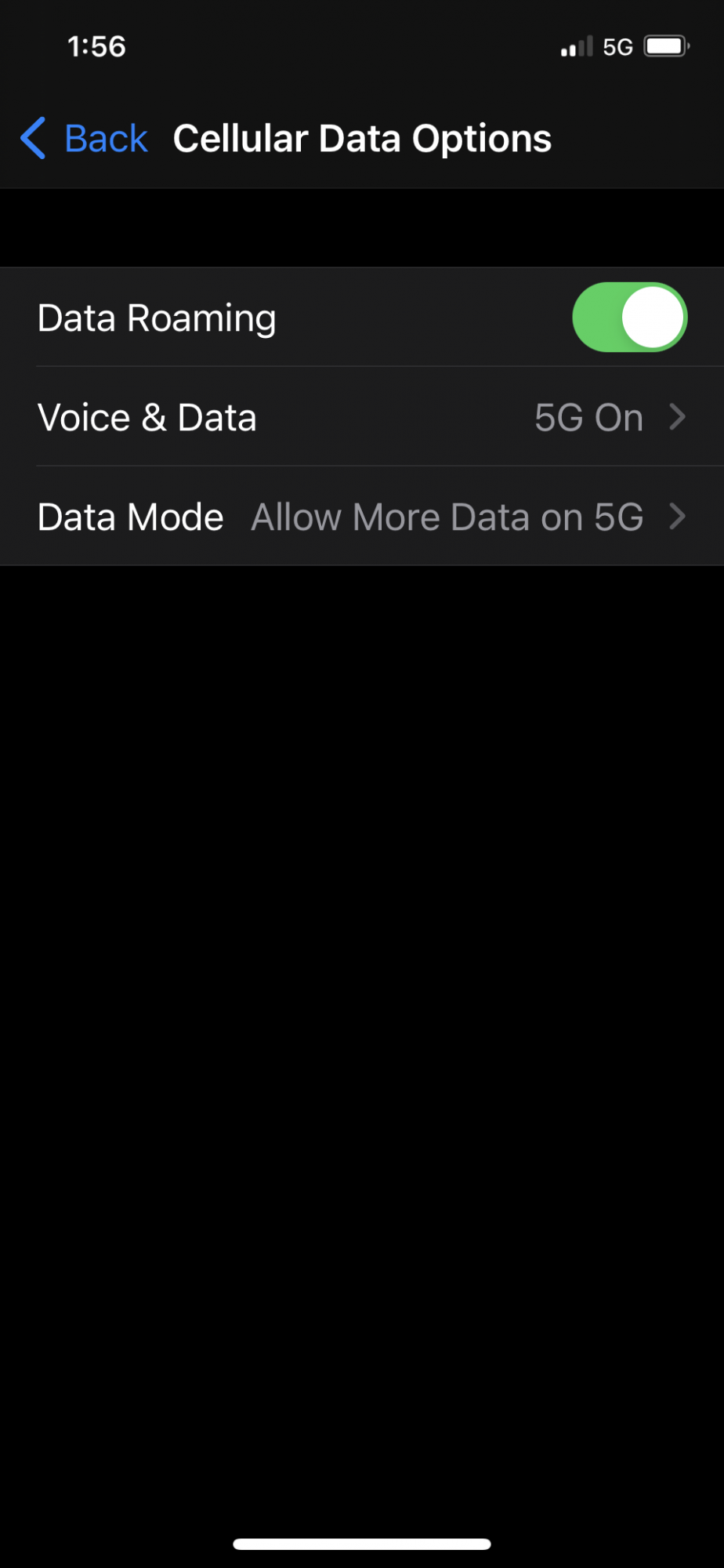

I called AT&T and was on the phone with them for an hour. They finally did this and I now have the option for 5G on, 5G Auto, and LTE. I tried 5G auto and 5G on, turned off WiFi and I still get 5Ge. I checked the coverage map in my area and it shows full 5G coverage. Even went outside still no 5G? I do have the new unlimited elite plan as well.

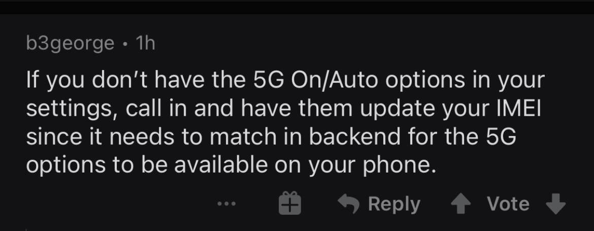

Finally got it to work after 10 hours later. Yes, you physically have to call AT&T and have them update the IMEI number along with the SIM card number. Now, it is showing. I tried all the techniques it didn’t work however after I called them and had it update my IMEI number along with the SIM it did. Good luck to all of ya’ll.
Thank you so much for your post it's super helpful. I did what you said about IMEI number and the SIM card number, rep changed it. Rep also told me that she will need to reset my data plan because it was started from Galaxy Fold last year & she did something to work for iPhone 12 but she did not change the plan. While she was doing that the line got disconnected but she called me back and when I turned off Wi-Fi I see 5G symbol so your post is spot on. You mentioned you cried 😆 I tried to cry but end up laughing.😆 BTW I have the same old orange blue and white sim card from last year. New sim is coming next week but most likely I won't insert it into iPhone since everything is working now. Thanks again for the amazing post! 👍
