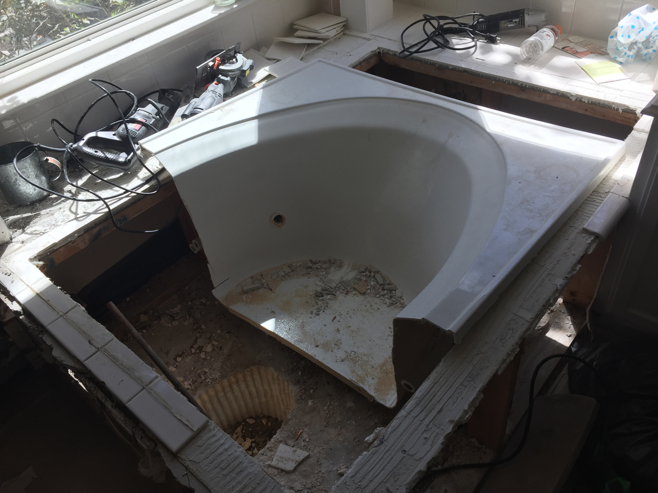

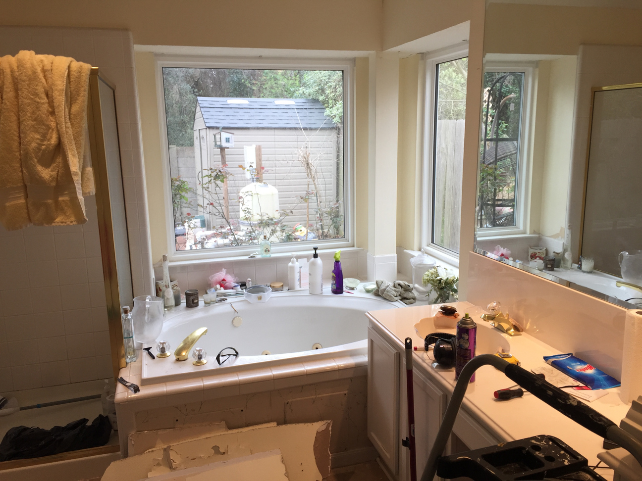

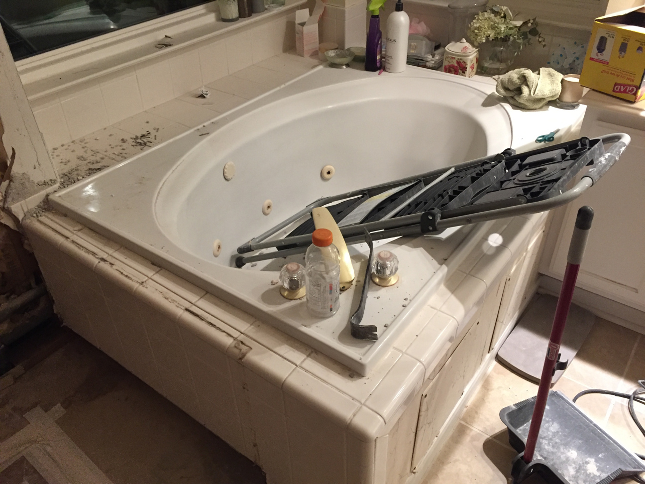

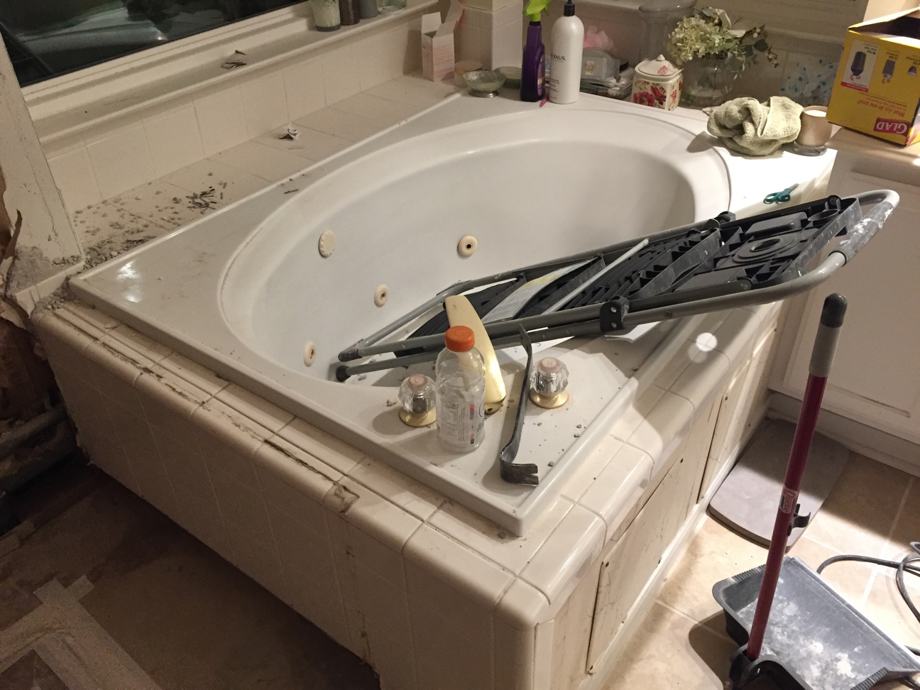

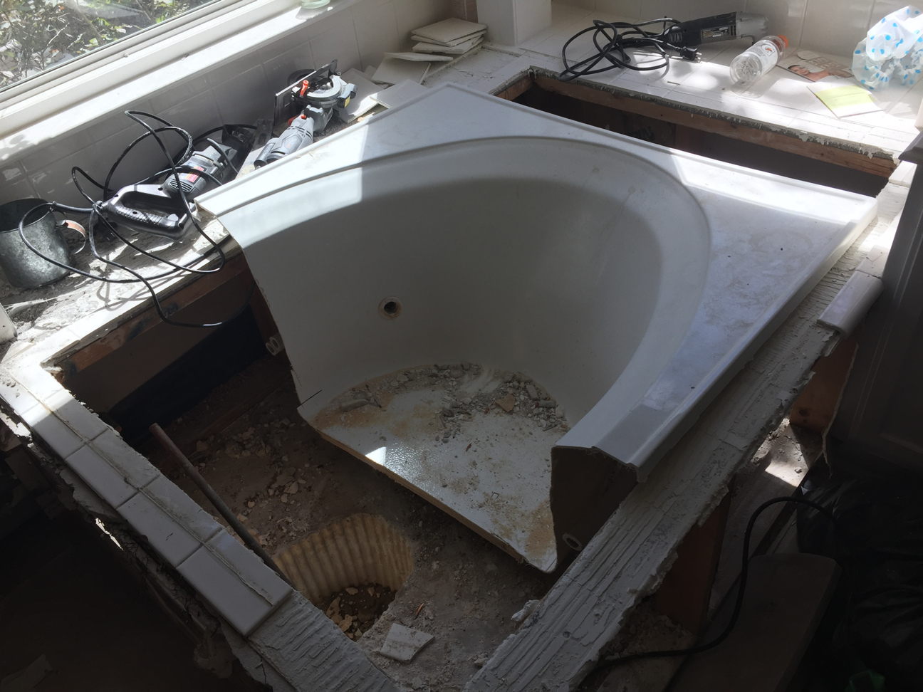

Day 6: Whirlpool Tub Removed
Ran into our first surprise with the realization that the "decorative" 6x5" post in the corner of the tub between the two windows is structural and not decorative... The windows are pushed out creating a space on the outside of the post, where the post represents the true corner of the building. The good thing is that I figured this out before trying to cut it out. :oops: :D
The bad thing is that we have about 4" less on two sides than I anticipated having which, I the new tub should still fit but will be a tighter fit.
The technical challenge with installing a new tub that has a drain in the center vs on the end, is having to jack out the floor to move the drain over to the center of the tub. One question I'll ask is the original drain I assume includes a trap in the concrete or in the sand below the concrete. Should I put a second trap in under the new drain location, or just use an angled piece of pipe to run over from the original trap to the new drain location?
These three items have been a big help (cutting the tub), lower back support, and respirator (a must):

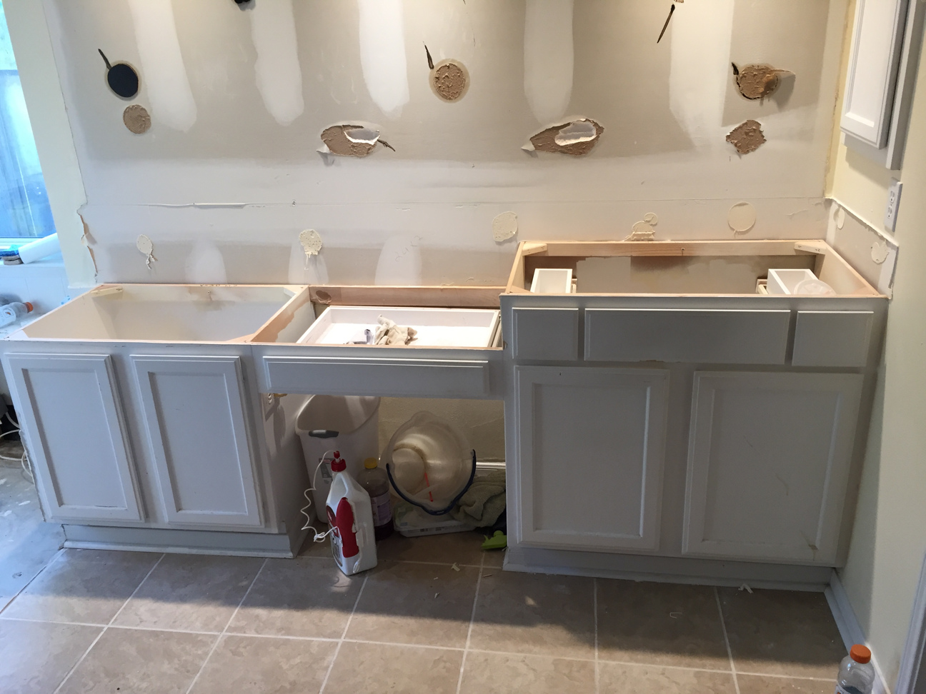

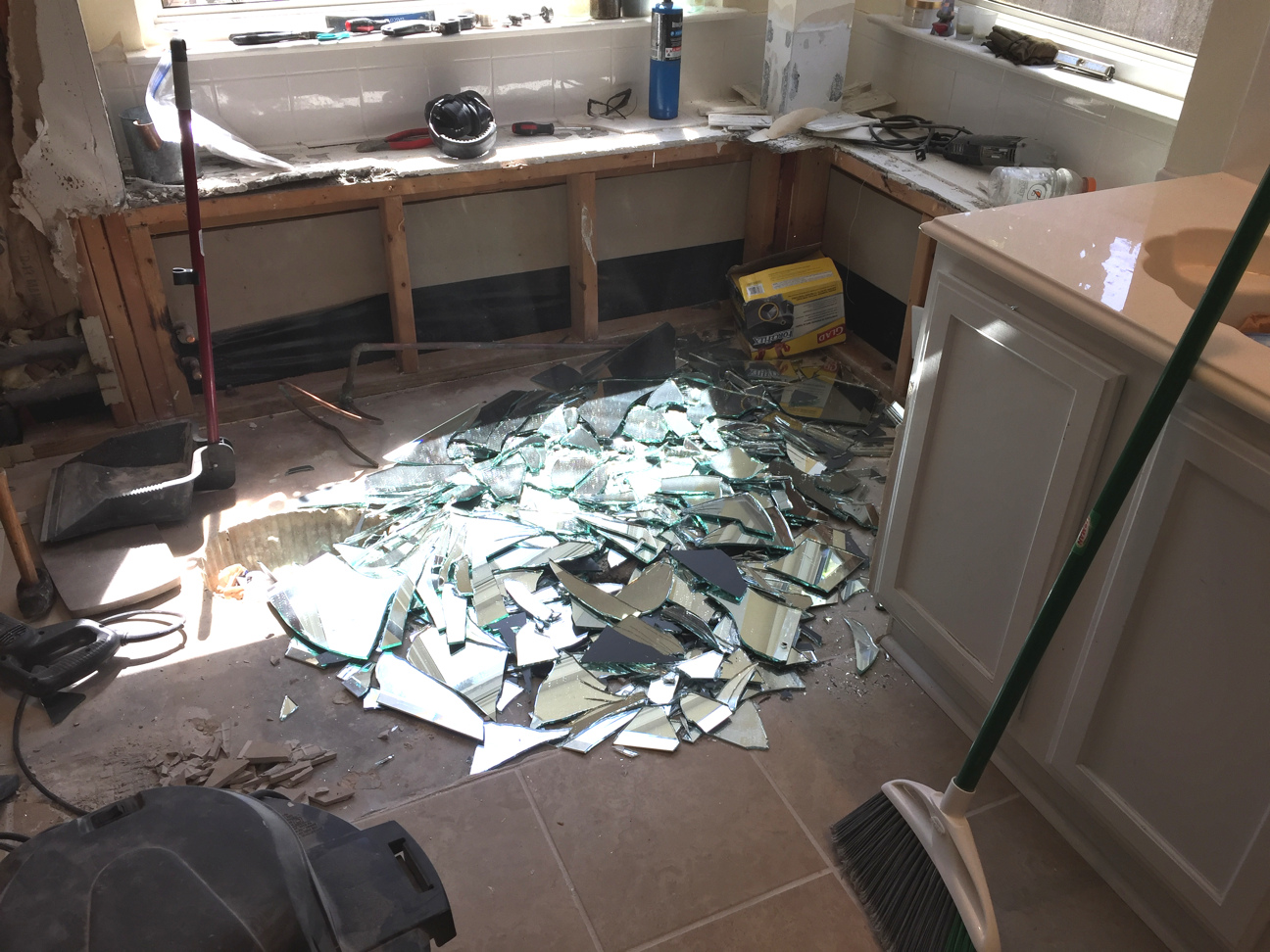

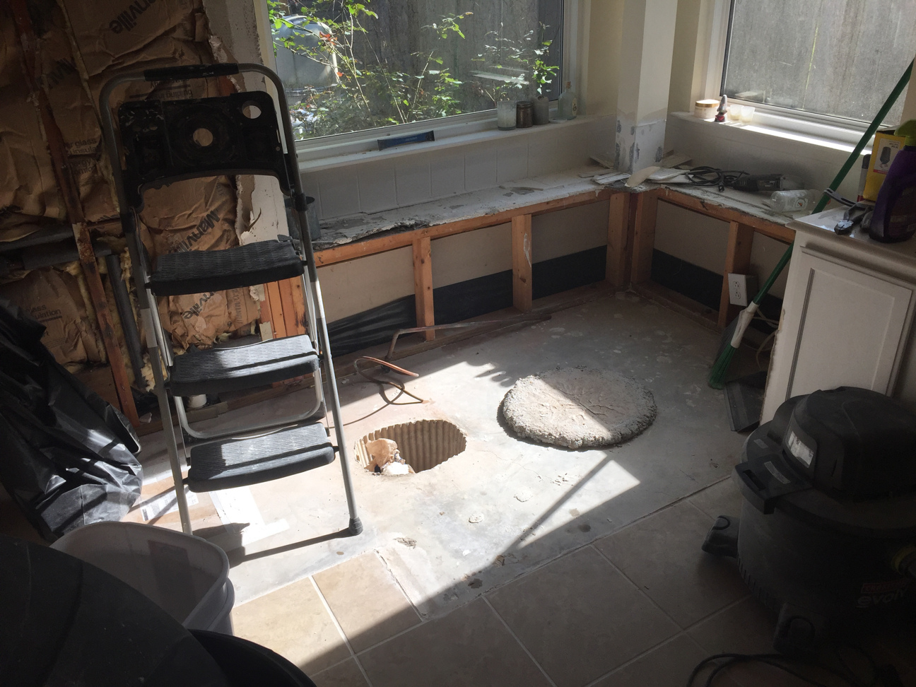

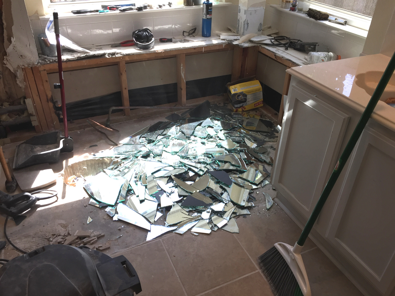

Day 7- Removed Mirror the hard way, Concrete Button where Whirlpool tub was, plus sinks and counter tops.
The whirlpool concrete stabilization hump (the round thing ?) removed
with a tile chisel, it popped right off.
Almost got the 90" mirror out in one piece...
I got to break glass with a hammer, no injuries. ;)

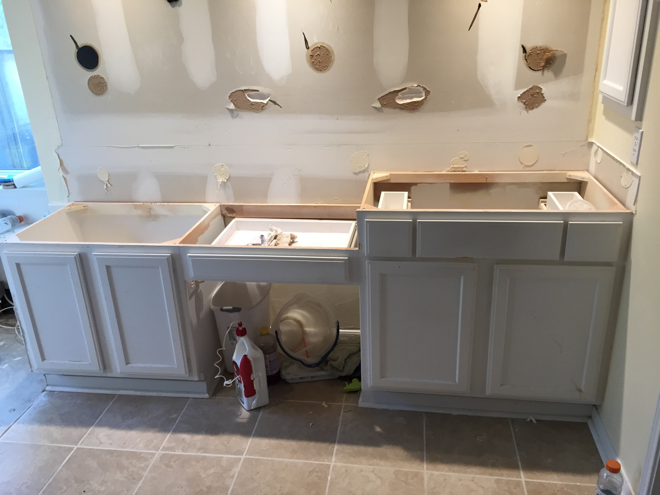

Sink and counters removed- heavy suckers.​
Protip: Cover your mirror in strong tape and then break if you must break. The mirror in our master was stuck and we did it that way. We, and by that I mean the contractors, were able to pull it off in large chunks using thick gloves. I then used a glass breaker to cut out some decent pieces and saved them. I think we were able to recover around 80% of the mirror in various sizes.
In the old days, it was much easier since the mirrors all floated in homes via a wood frame around it. Remove one size and slide it out.

What’s interesting was the difference between safety glass, my shower which broke into a multitude of small mostly harmless pieces, while the mirror broke into large, artery cutting dagger-like shards. :eek:

Laminate sheet or the tempered kind? With the tape, you can use it all glass products. Obviously you'll want to avoid painter's tape since it isn't very strong. Any residue can be cleaned up with acetone or rubbing alcohol. It's great because even if you intentionally drop it, it all sticks together with maybe a few small pieces you'll want to clean up. I broke a glass a few months ago out of carelessness and used my dying shop vac to clean it up and then dump it into a trash bag lined with newspaper. I've cut myself a few times with glass and once with obsidian. In terms of pain, the obsidian cut was less painful.

First time I've heard that term. I think for the glass we couldn't use because it was either irregular or too small, the contractors whipped up with what had to be plaster of Paris and threw the glass and dirt into it, let it cool and threw that into the huge trash container we'd rented out. The type a truck takes away. It protects landfill workers or whoever sorts stuff if they even do it.
We tried to be as efficient as possible in recovering materials instead of plain dumping them.

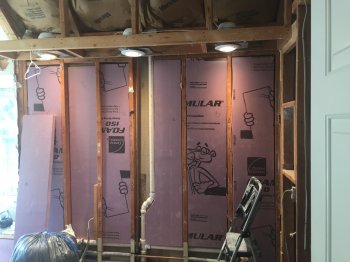

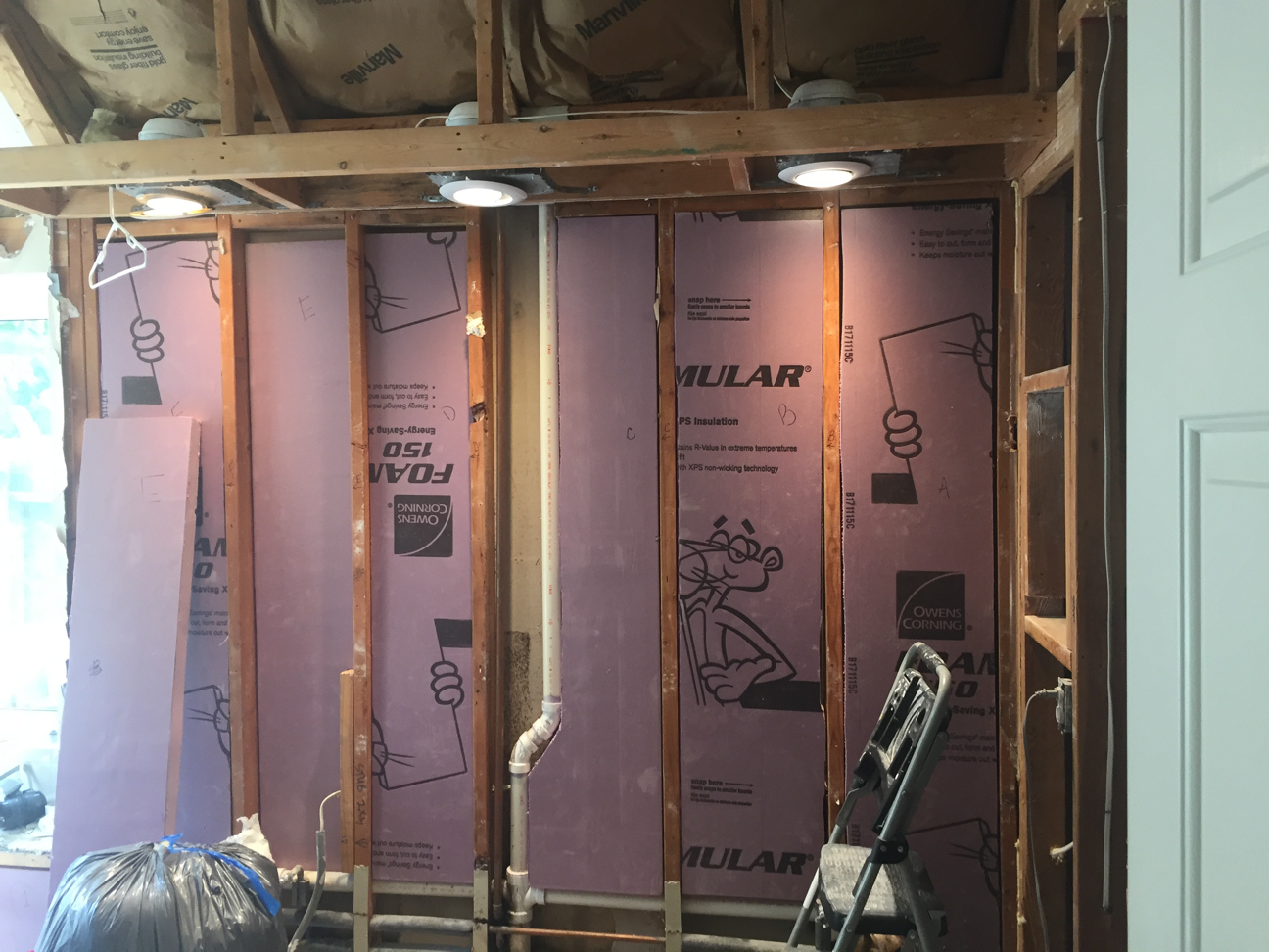

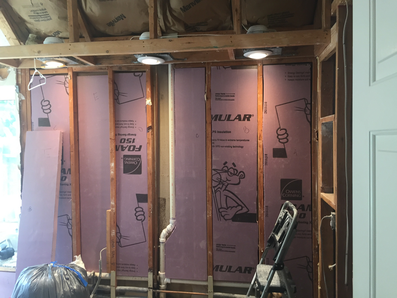

Day 11-13- Installed foam insulation board. I decided that with the way the insulation was stuffed into irregular spaces, that the foam was the way to go. I used a combination of 2" and 1" (3" total) pink foam with a rating of R5 per inch which is R2 greater than the batt insulation (R13). But I also noticed gaps in how the batt insulation was installed.
I also discovered why I had a cockroach party (the large ones that live outside primarily) under my enclosed tub. Too many holes behind the insulation directly to the outside of the house into where the brick is. That will be sealed with spray foam along with sealing the foam board around the edges with spray insulation foam.
