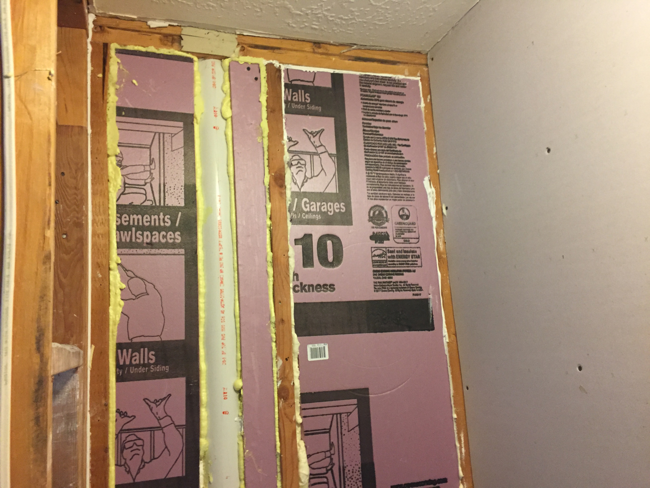

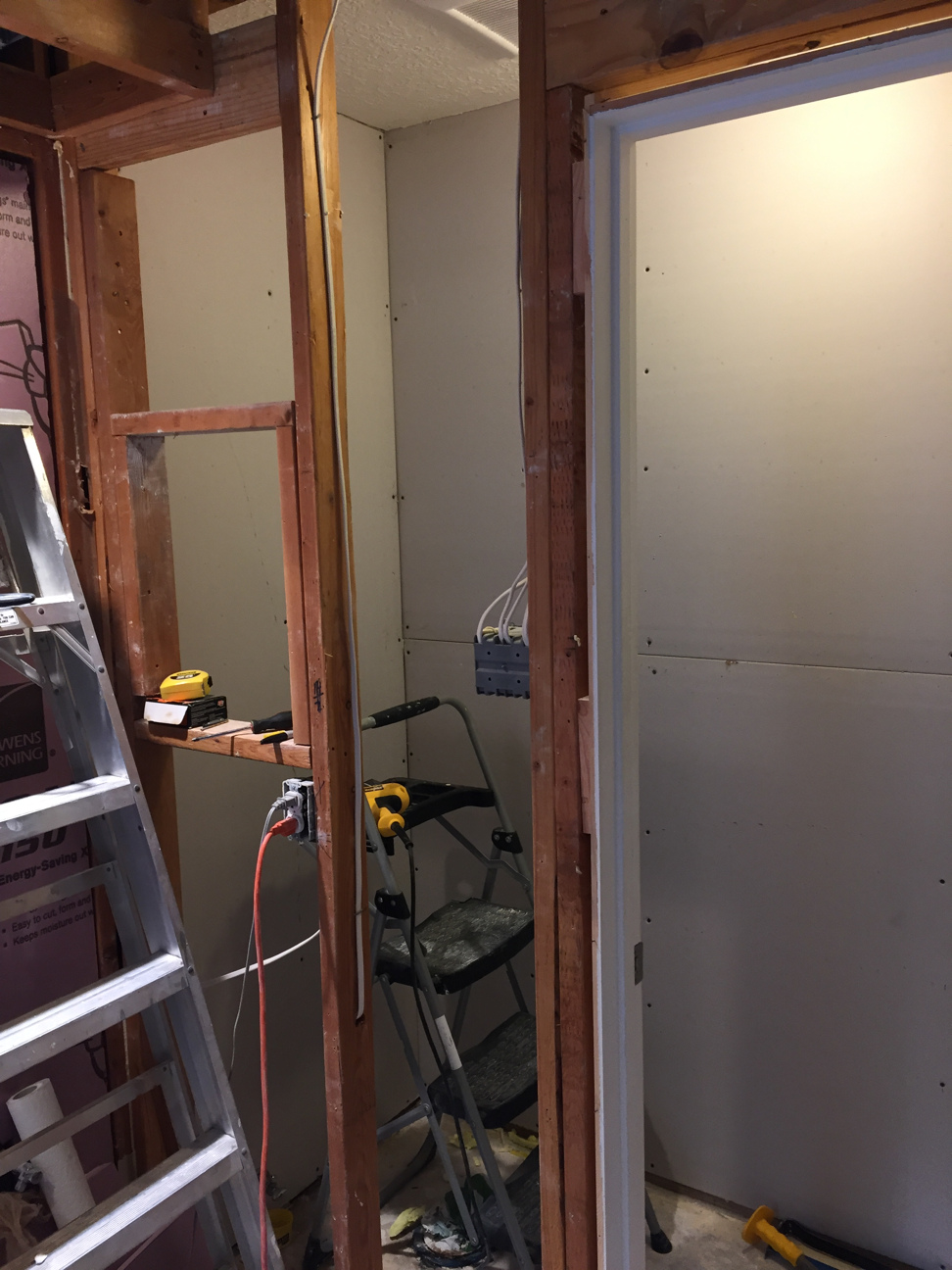

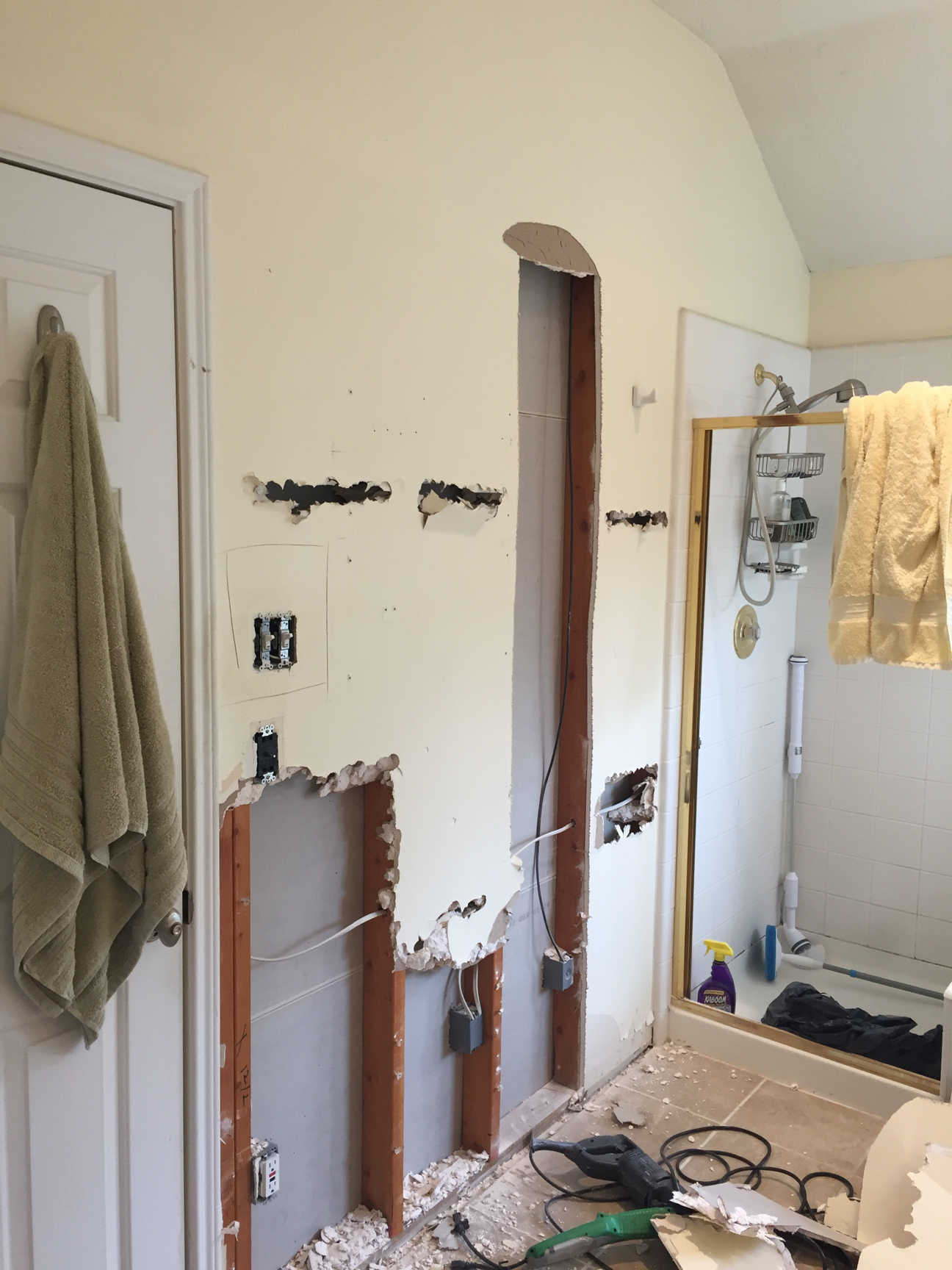

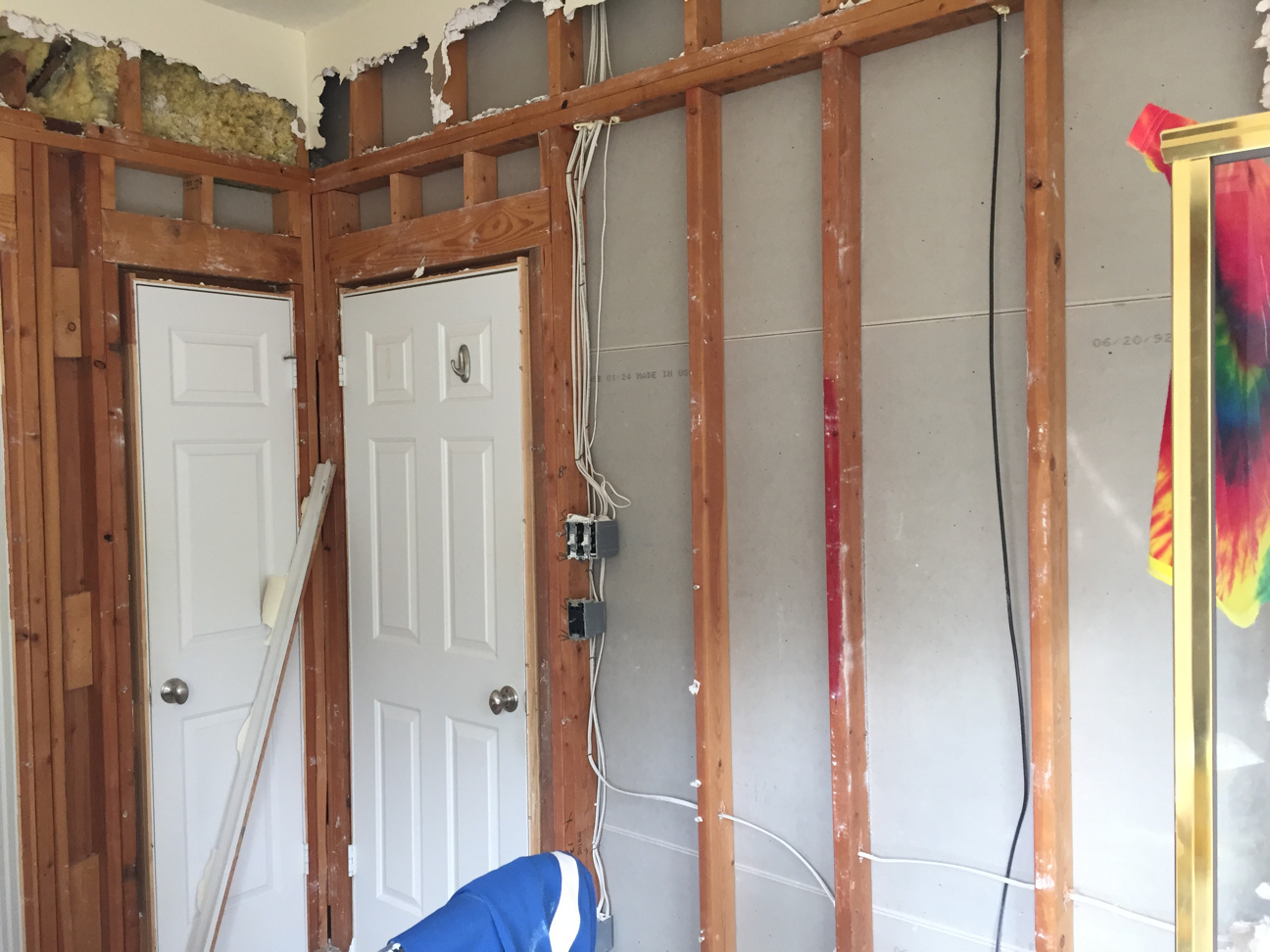

Day 16- Drywalling the Toilet stall.
3" foam insulation sealed with spray foam.
White vent pipe in middle comes up from
concrete floor.
Drywall​
It has begun!! Bathroom messy state is pre-construction prep. :D:D

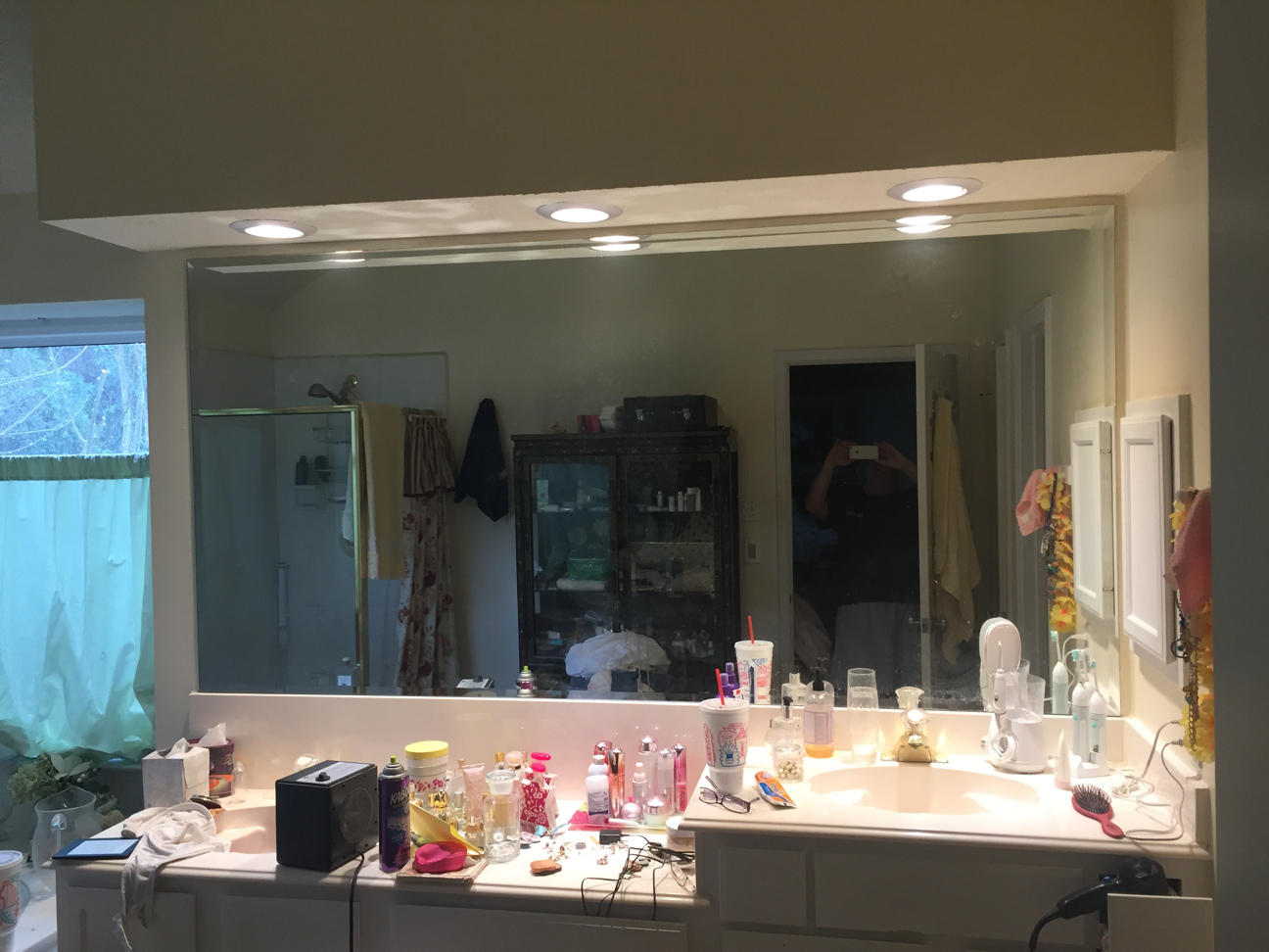

Before:
Day 1: Destroy
Testing the waters
Day 2: Destroy
Maybe this info will be useful for you. Just found a great idea for the washing sink at ( https://homus.org/live-edge-wood-slabs/ ) - it's on the wood slab. There is a part with ideas for bathroom counters - looks cool.

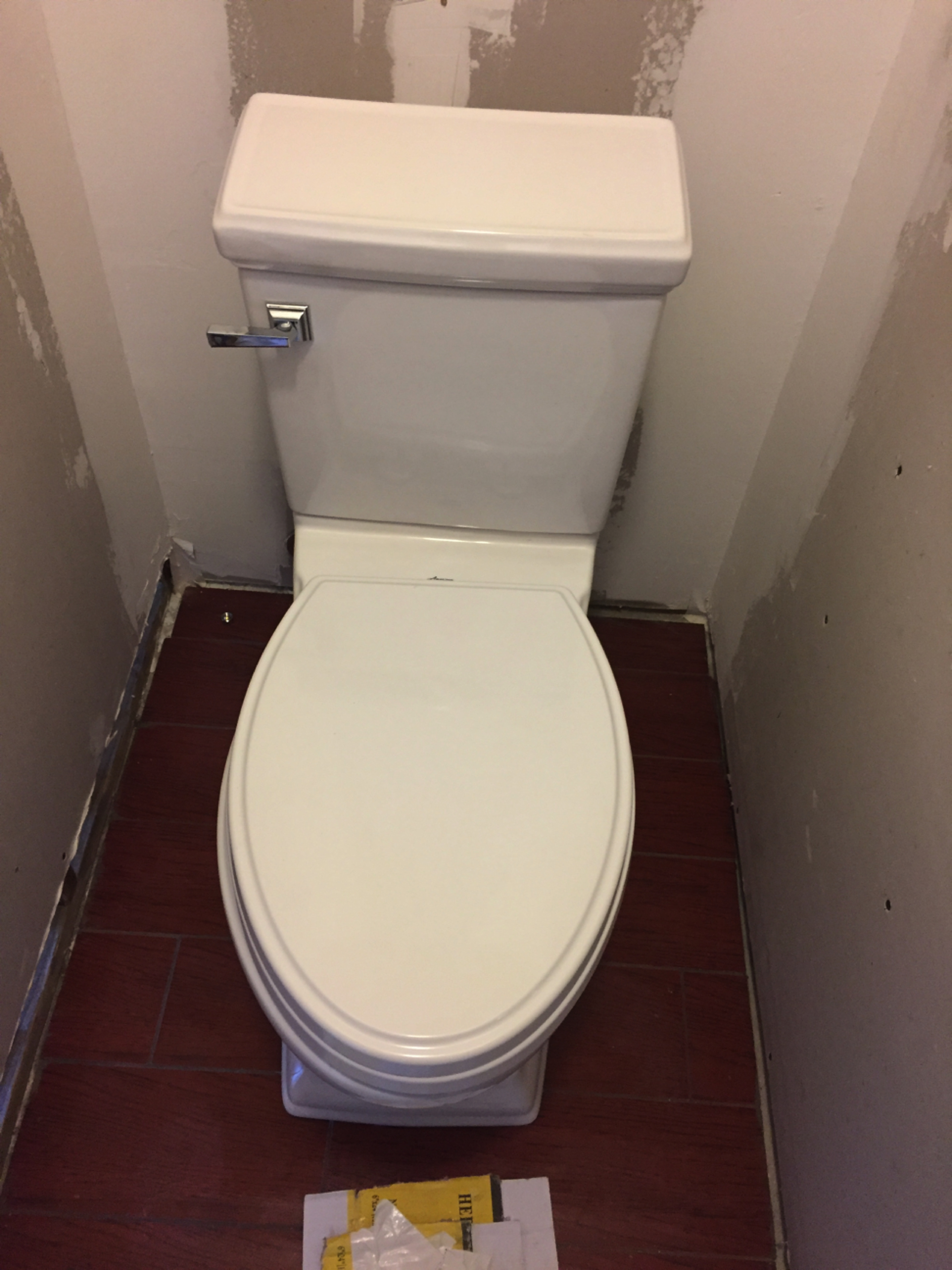

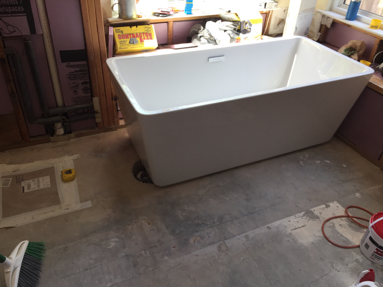

Day 17-19- Yes by most accounts slow progress. Normally I would not do the toilet stall first, but would do the tile on entire floor, but this was a request from the wife, so I took care to make sure the tile aligned properly to tie in with the tile rug out in the main portion of the bathroom.
Because the tub is a fixed size, I've decided to install it before the shower on the left because I can't change the size of the tub, but I can alter the shower as needed. So I'll do the plumbing, put the drywall and tiling around the tub, and then install it.

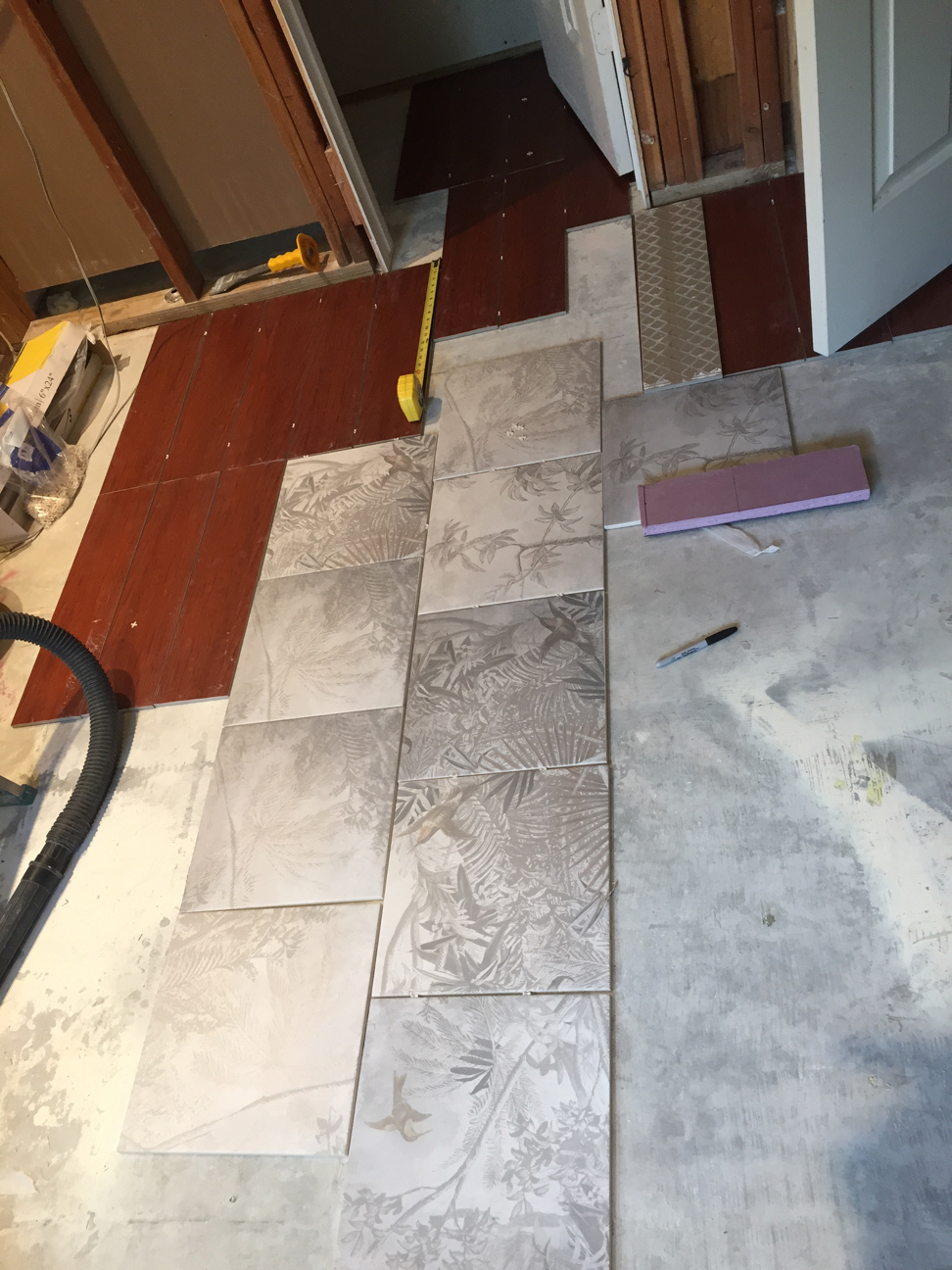

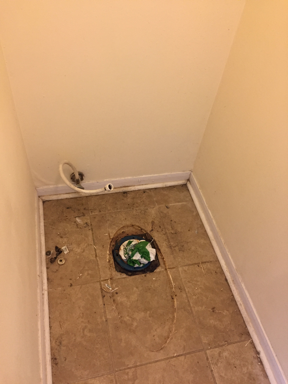

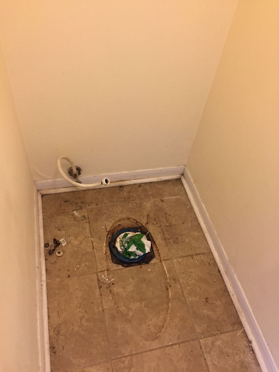

Old Stall

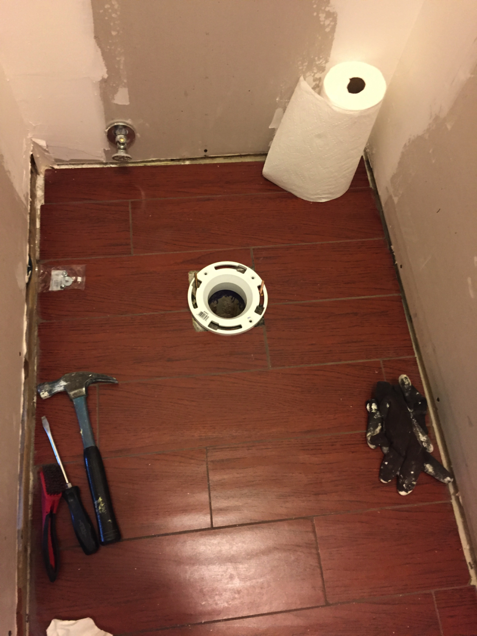

New Tile + New Flange
New Toilet

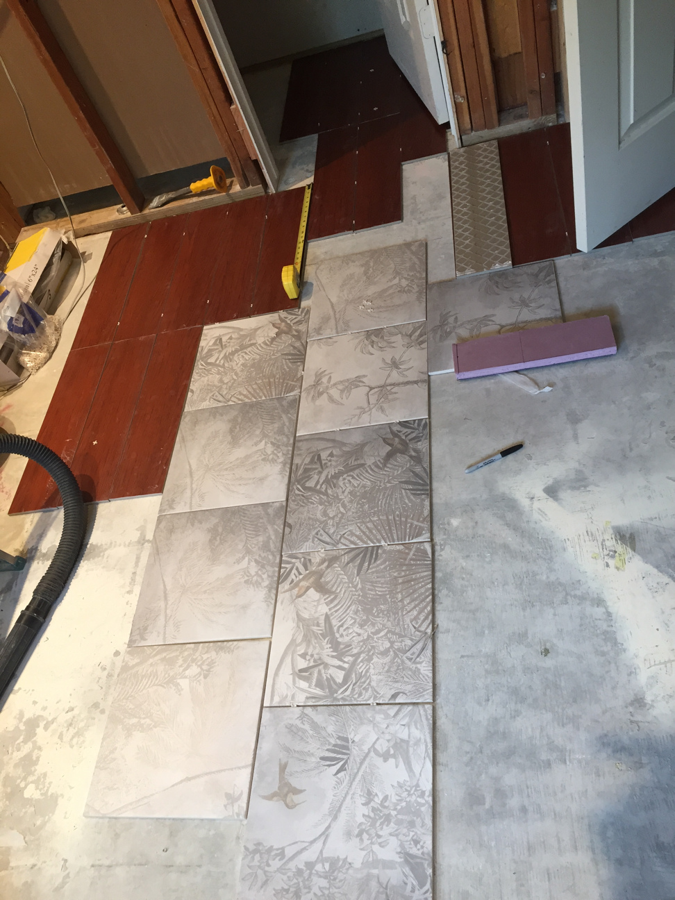

Measuring tile rug (planning stage)

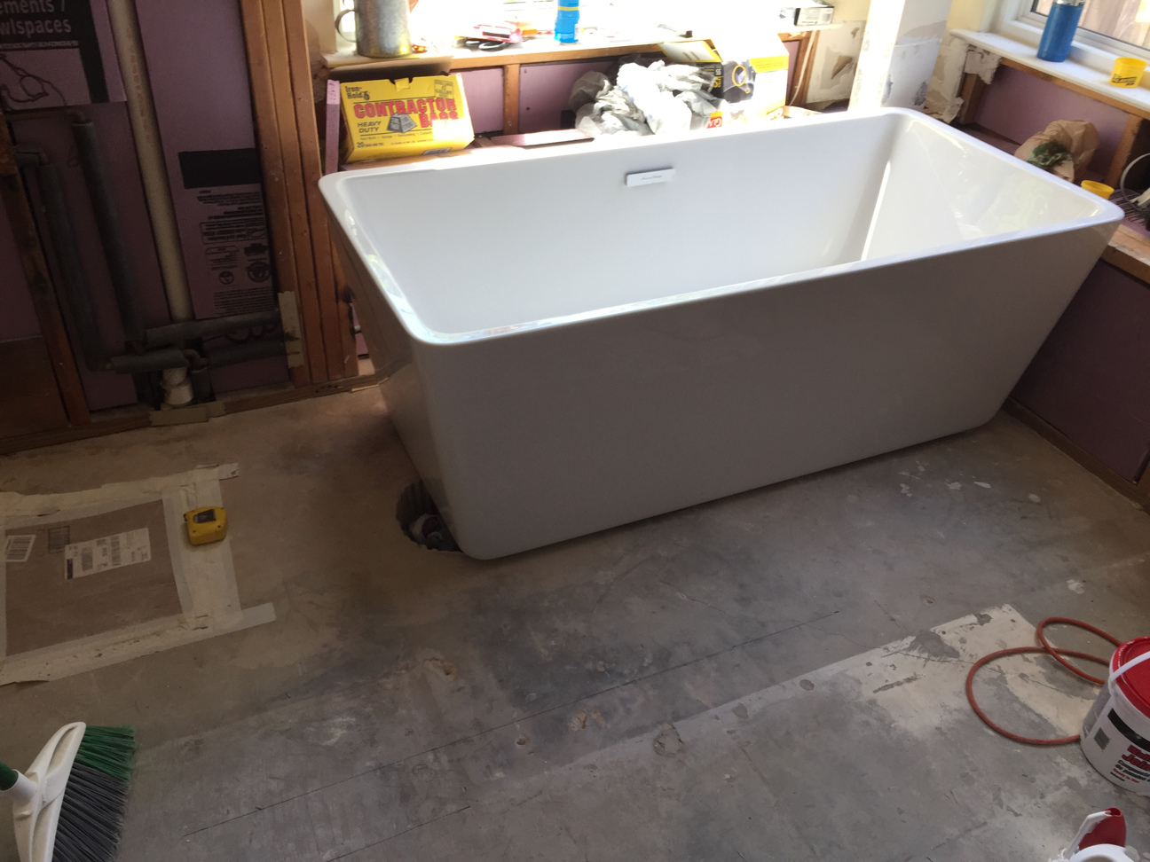

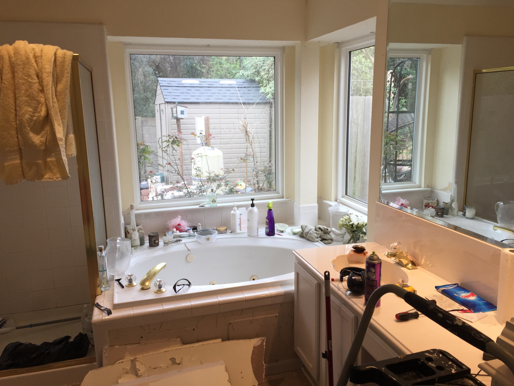

Scoping out how new tub fits into space​

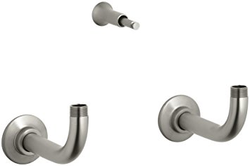

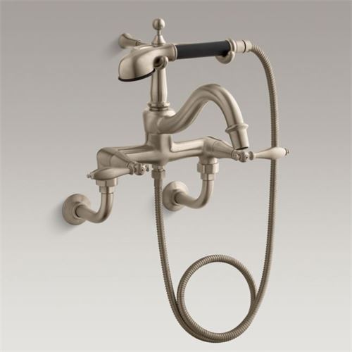

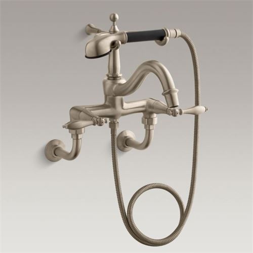

Koehler 331-4M-BN
This faucet weighs about 15lb. It’s heavy duty and feels well made. I like it, but I’m not thrilled with Koehler marketing at the moment. Despite having a quality high end product, I don’t like that they sell a $900 tub wall mount faucet, don’t include the two tubes and a bracket that consists of a wall mount kit, that they charge an additional $200 for. This seems to be price gouging. Take a look at what you get for $200:
Also I’m not happy when I called them, and asked why the top bracket does not connect snugly with the faucet to support it, then asked what about this small threaded hole in the hole in the back of the faucet where this bracket fits in to? It looks like there should be a set screw to connect it. Their customer service told me there was no set screw for this threaded hole. Since then I went to my local hardware store, and purchased a set screw, and oddly it facilitates connecting these two items together. :oops: I’m writing a letter to Kohler describing my displeasure, that I know will have a huge impact. :rolleyes:

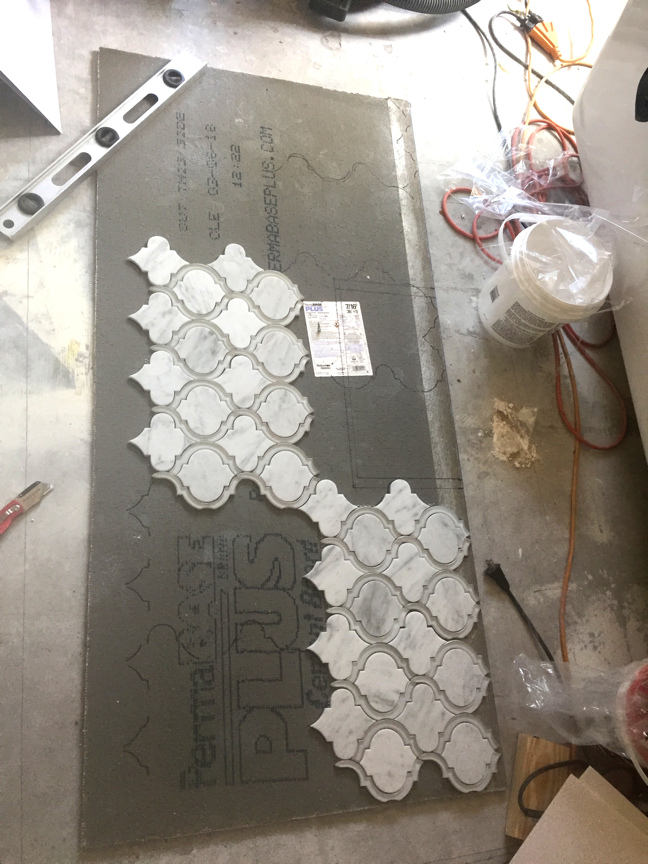

Separate topic tile and tub-
based on the tub pictured in the previous post, I’ve assumed that for a free standing tub, that the floor tile would be run underneath it and it would be sitting on top of the tile, just like the toilet does. Seeking confirmation. I’m not trying to avoid running the tile underneath, but I could butt the tile into this tub fairly easy and make it look good. Just wondering if there would be ramifications? The obvious one would be that if something ever happened to this tub and it had to be replaced, it might be good to have a solid floor of tile underneath.
[doublepost=1524411114][/doublepost]Regarding the old drain to the new drain- Those are about 2’ apart. It was mentioned that the slope between new and old drain should be a minimum of 1/4” per foot. The original drain is pvc. Do they make pvc joints that facilitate such a gradual angle, or would you have to rely on a flexible pipe connection? The pipe comes out of the tub vertically down. A 90 degree joint would not have a slope, so instead, you’d need something like a 110 or 120 degree angle for a junction piece. I don’t remember seeing anything like that at Lowe’s or Home Depot for a rigid pvc junction. But there is always the plumbing supply house to check.

Koehler 331-4M-BN

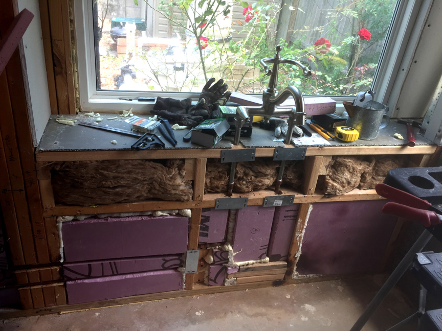

My plans for doing a wall mount for the tub faucet have been altered because there is a window next to the tub and there is not enough place to place the faucet above the edge of the tub and still have any wall to mount the top bracket, that it needs for this type of install. I did not figure this out until I had the parts in hand. :oops: So I am going to return the $200+ wall mount kit and do a deck mount which does not require a top bracket.
If you look at the picture of the tub above (post 80), you might see how the current ledge sits next to the tub and it’s slightly lower than the tub rim. This was the height of the old tub. I was going to remove the ledge and build the wall up to the window sill level and have a large sill there. But if I do a deck mount, the faucet will set way to high. So instead, I’m going to do a deck mount using the old ledge but raise the faucet high enough so the on/off handles will be above the edge of the tub. Going out today in search of 1/2” NPT threaded (on the ends) riser pipes with a brushed nickel finish. I know the plumbing supply house has them, but I’ll check Lowe’s and Home Depot too. But here is a case where I want heavy duty pipes that can support the weight of this faucet long term.
So, has anyone drilled a hole in marble or tile? This will be the deck material. I’ll need a hole slightly larger than 1/2”. I’m looking at diamond hole saw bits. One video they used a plastic template to hold the drill still while starting the hole. The other question is if the hole is oversized, what would you put in the hole to stabilize the pipes coming through them? Thanks!

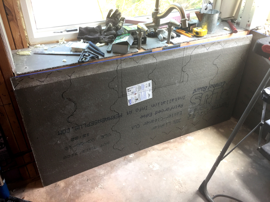

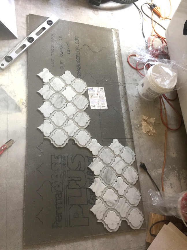

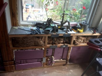

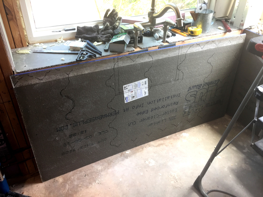

[doublepost=1527638559][/doublepost]Progress on Bathroom 29May18:

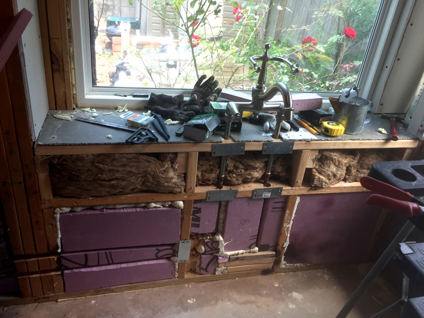

Finishing up the wall by the tub, new faucet installed. Before placing the rock board on the wall next to the tub, I wanted to make sure the mosaic tile I will install there will fit without too much trouble. I could have put this tile on regular drywall, but the danger is that if you ever spring a leak, the drywall would absorb water and milldew. I'm going to leave a small access panel under the faucet in case it ever had to be replaced, also covered with tile in the pattern, so the tile in the vicinity of the tub will not have to be ripped up to get at it.
