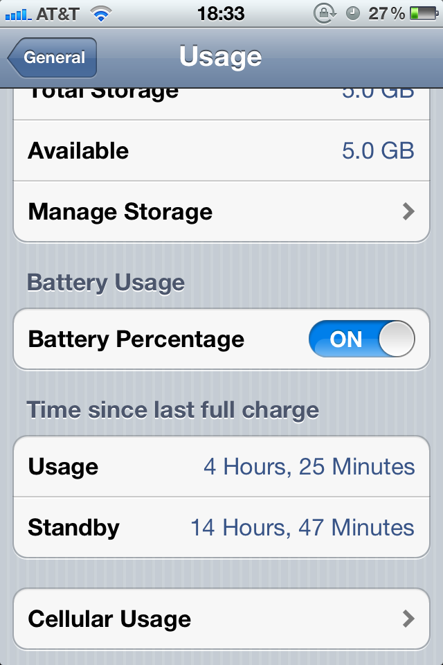

Calibrated my iPhone 4S the other day and here are the results. Was going to let it run down a little bit more but I had to charge it up for the night.

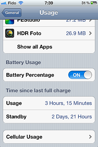

I have push, bluetooth, and "ask to join wi-fi networks" off. I'm usually on wi-fi and my brightness is set at 30-40%.

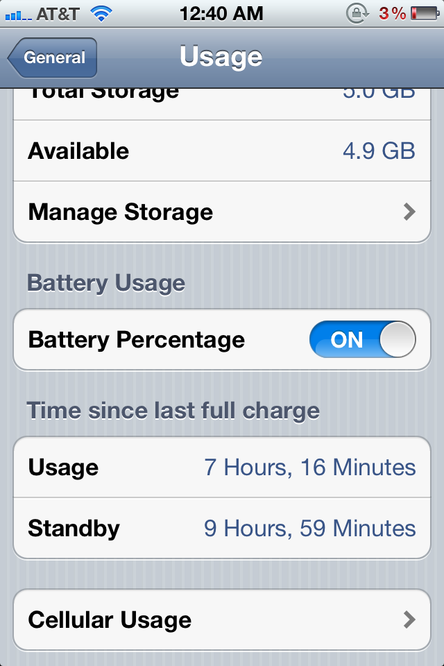

Here's my latest report. I think this is pretty alright. The usage was phone calls, navigating and watching youtube videos, so I'm pretty satisfied.

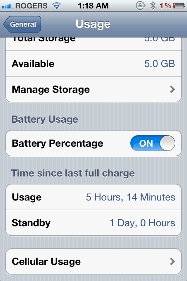

I have no idea what happened, but I'm now getting much, much worse battery life then I did when I originally reported in (above). Check this attachment. Should I hit up the Genius bar? I think I might since the guy above me has 4 more DAYS of life 😛.

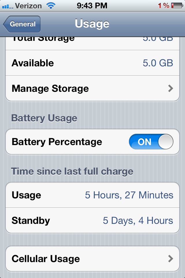

5 days and 5hr usage. How does that work? Leave phone alone for 5 days. Then fire up an app say sleep talk recorder that uses little battery and thus records 5hrs usage. Thats the only way I can think of outside of hacking the operating system to get those stats.
In theory its possible and indeed its the sort of standby time we could expect if it really did hit its 200 hours.
