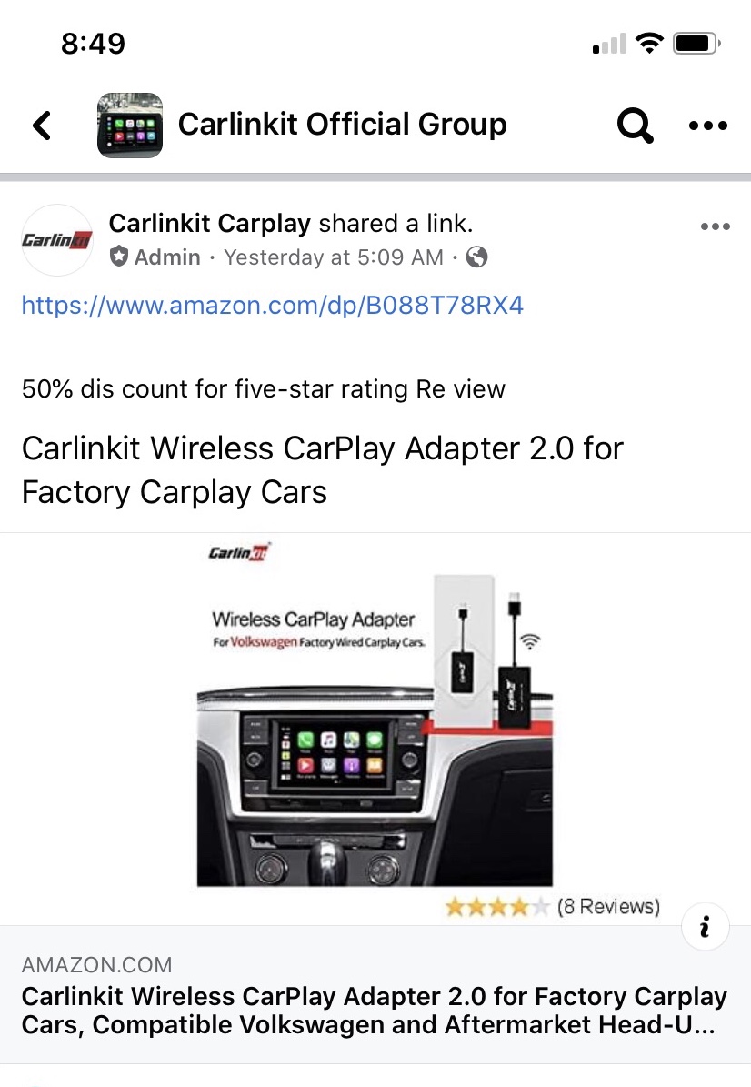

That’s Carlinkit not CarPlay2Air. But pretty disgusting. I posted such on that thread. That’s Facebook group led by Carlinkit is bizarre. There is absolutely no chance in hell we are going to have functioning devices after iOS 14. They can’t even release a friggin firmware. No way are they going to react in real-time like they said they would. They are trying to sell as many units as possible before they go silent and close up shop.

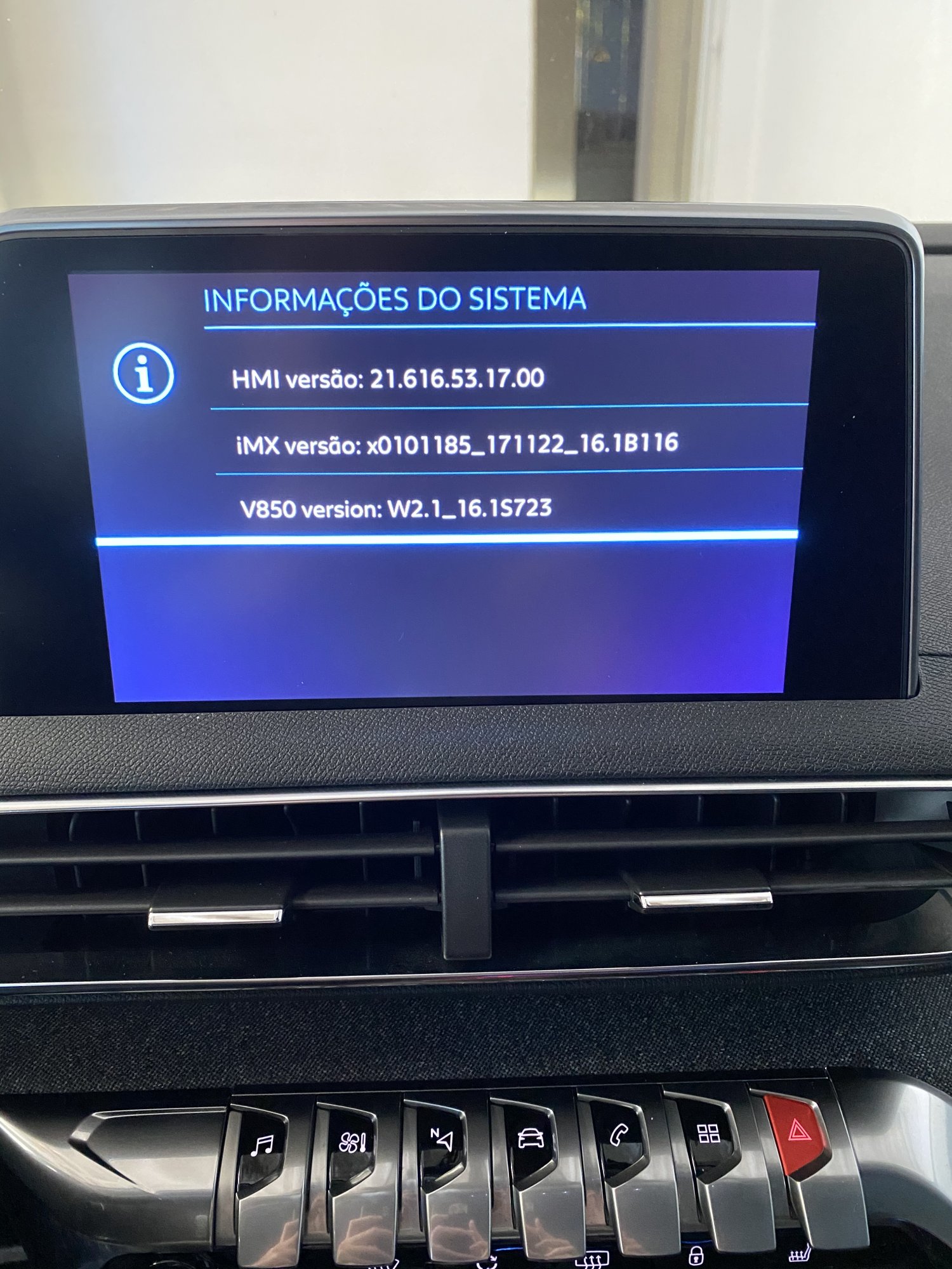

Hi @datolis I think i have the same issue as you. I also have a new Peugeot 5008 from November 2019. I connected to the Hyundai of a colleague following the steps given by the manufacturer, i upgraded to the latest firmware and i thought my problems were finished.
Unfortunately then i connected it to my Peugeot and... nothing. I connect it, it pairs the bluetotooh to my iphone, then i accept the carplay message, it blinks blue for a few seconds and then it disconnects.

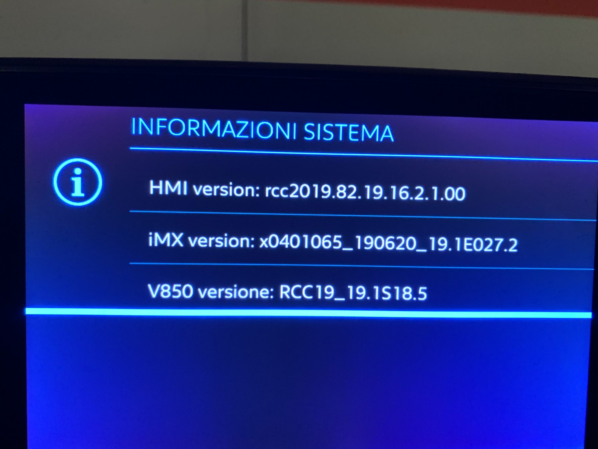

I attach a screenshot of the number of my car system. I think we have the same.
Please could you send me the video you made so i can check if it is performing exactly in the same way?
I wrote to Julie from the client support, waiting for her feedback.
anyone else has some experience with Peugeots?
