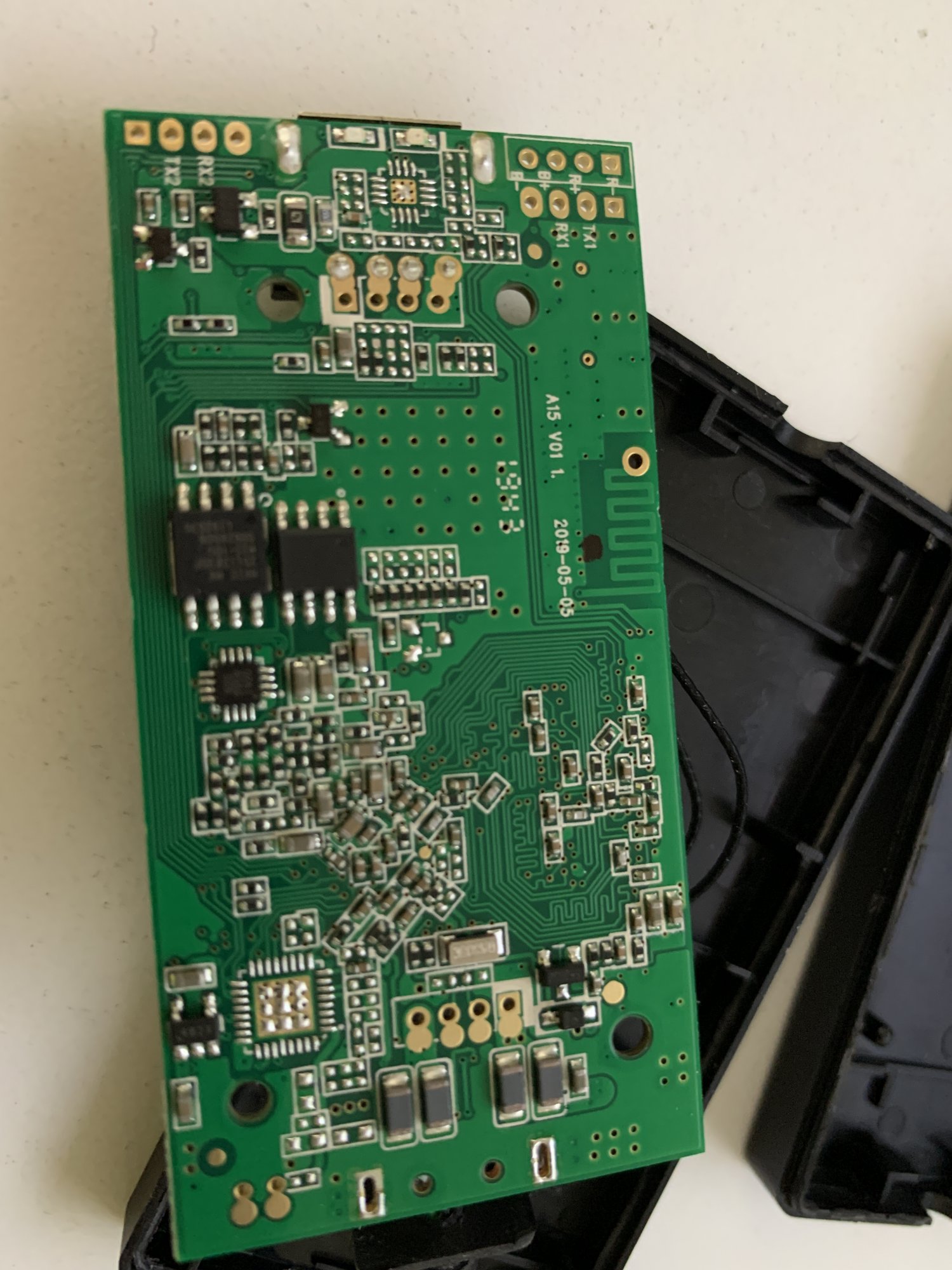

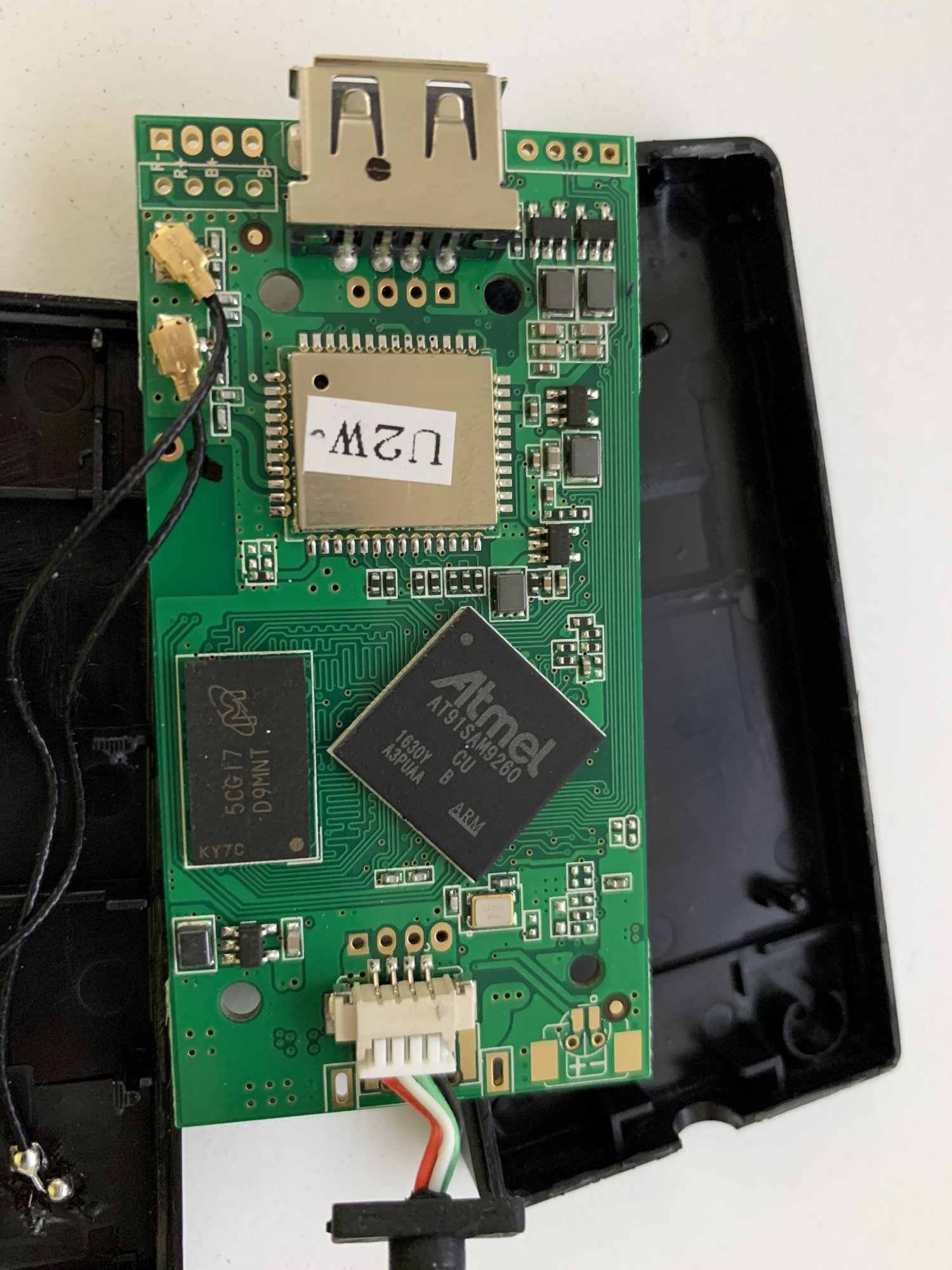

As I have nothing to lose I opened it up in search of a serial port. And it seems there is one ... so maybe it has serial out attached for some debugging ... I will report.
View attachment 927093View attachment 927094
This is interesting. I have another wireless Carlinkit dongle for Android/WinCe headUnits which I used on my Chevy Cruze, used for a good 2 years then I bricked it by flashing the wrong fw. A U2W fw btw in the hopes that I could "upgrade" it and make it work with MyLink on my current vehicle. LoL
Visually, the internals are the same as the U2W internals, except for the 5CGI7 D9NMT chip. I assume this is the RAM? Mine has Hynix H5TQ1C63BFR etc etc]. And whatever chip is under that shielding, may or may not be the same.
Anyhow, am just saying that I was surprised to see that they are or look very much the same.

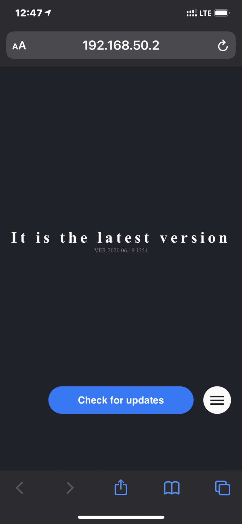

I just updated to firmware 6-24-20 all went ok and updated. But when I check with 192.168.50.2 it’s actually 6-19-20 firmware that is in those directories.
Wait, so you used the 06-24 image but it installed 06-19? I have to check what mine reports.... But I was running 06-19 until this morning and it was performing a lot worse than after the update.
Yes I installed 6/24/20 but when checked it was actually 6-19-20 that was installed.
