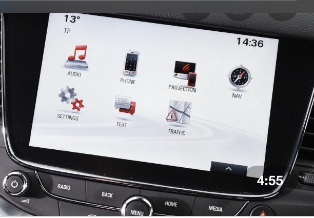

What system do you have in your Vauxhall Astra? Is it the Intellilink system?
I’ve got a CarLinkIt and it’s never worked for me. Only thing ever seen is CarPlay icon flash up on the car touch screen and disappear.
What version are you on? Does it work every time?
Can you get a photo/video of it please? What version Intellilink, if that’s what it is, are you on?
Mine looks like this
I have the intellilink system 4.0 the one with out the installed sat nav which I think is the 900 system it works instantly all volume controls etc the only grip I have is distorted sound after 5 minutes when playing Apple Music every time,so I use Amazon Music
Ah ok, that’s strange then, mine is the one with Sat Nav on, the Navi 900 as you say called.
Can’t think what the difference is then, and why my CarLinkIt has never worked (in the Vauxhall has on a friend Merc).
What version are you on your CarPlay2Air? I think I may try and update mine to the 2020-06-17 the. To see if works.
Frustrated now why mine never worked yet yours does and nigh on the same system...
