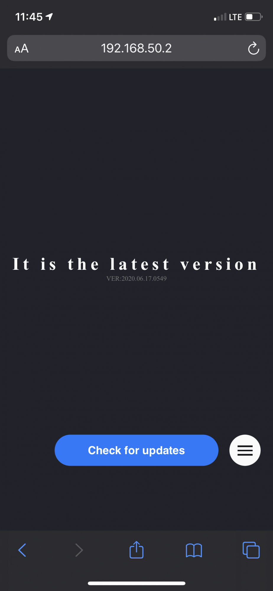

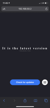

It is English - and I get the update by using the 192.168.50.2
Excellent. English = Good News. Now, what version were you able to install via the OTA (192.168.50.2). Is it 2020.06.17.0549? And when did you perform that OTA update?
I perform the OTA 6/28/2020 (New York). I don't have the exact version.
So you did that update, yesterday (Sunday), from the East Coast. Got it.
If you go to that same page in your iPhone's safari, it will show you what version you are running, directly below the message that states, "It is the latest version". See here:

So I went home, tried flashing the latest firmware (2020.06.19.1354) and it seemed to work. I used the Apple usb charger and a small flash drive, had red and green lights flashing for a minute before it was solid red, left it there for 5 minutes to be safe. I went back to the car and nothing happened, just solid red. I tried forgetting the car in CarPlay settings and I shut the car off and on. This time I got the bluetooth pairing screen again for half a second, but not long enough to hit search. I then got a pairing request on my phone followed by the CarPlay prompt again. I accepted it, and the device flashed green, I checked the site and it showed I was on the latest version. I took a screen capture of this and it also took a screen capture of the now playing screen in CarPlay, despite not actually showing the screen on my stereo. It also played 3 seconds of music before it stopped, the light went off and then back to solid red.

While that may be true -- I was furnished the 2020.06.17.0549 update FROM CPlay2Air support and specifically instructed to update my adapter. And further, the link that was sent to me, to download that firmware from, had the firmware titled, "U2W_Update FINAL". So apparently, they felt it was final enough to be considered safe for public consumption.
