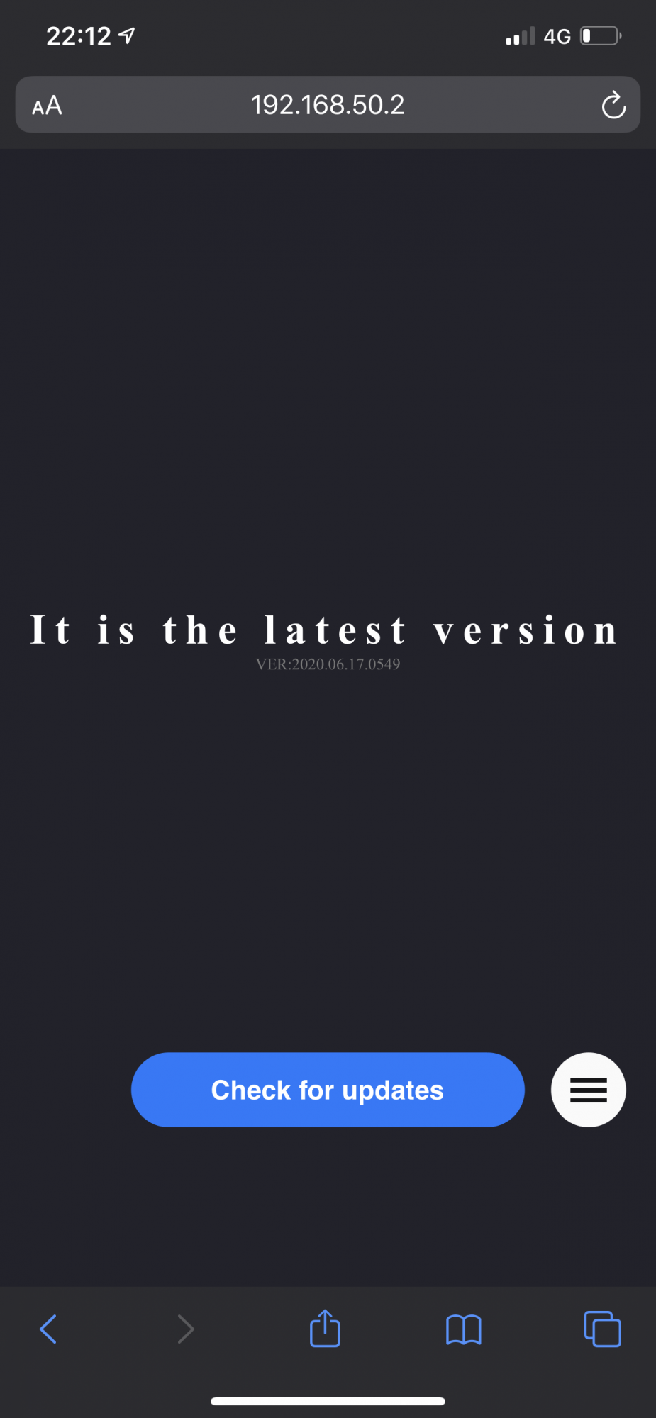

While I'd hope you could get an adapter back with 2020.03.06 installed on it, I don't think that is likely. I recently purchased mine (delivered on 6/15/2020 or so) and it came with 2020.03.18.1455 installed on it. But, at least if you DID get that one, you could theoretically roll that version back to 2020.03.06 (fingers crossed, the good lord willing and the creek don't rise)!
So, 2020.06.17.0549 is all good for you, Simps? You do NOT have the 5-minute audio distortion issue?
I’ve never actually noticed any audio distortion so not fully familiar with the problem - I’ll give some tests and see have any issues after 5 minutes- I only tested for a few mins earlier after checking the update solved my initial issue.
Ah, I see. Yeah, I did the same thing -- after getting 2020.06.17 flashed on my adapter, I just tested a few other things and just assumed that I was all set. But then I was out driving later that day, and sure enough, about five minutes into listening to songs via the music app within CarPlay, the audio quality degrades, into what sounds like a garbled/distorted signal. Pausing and playing again resolves it...for five more minutes. Totally aggravating. Never had that issue before the June 2020 update. Please do test and see if this bug got introduced into your system as well and report back, I'm sure we'd all like to hear if Fords are suffering it too. It may be just a GM issue -- just not sure yet.

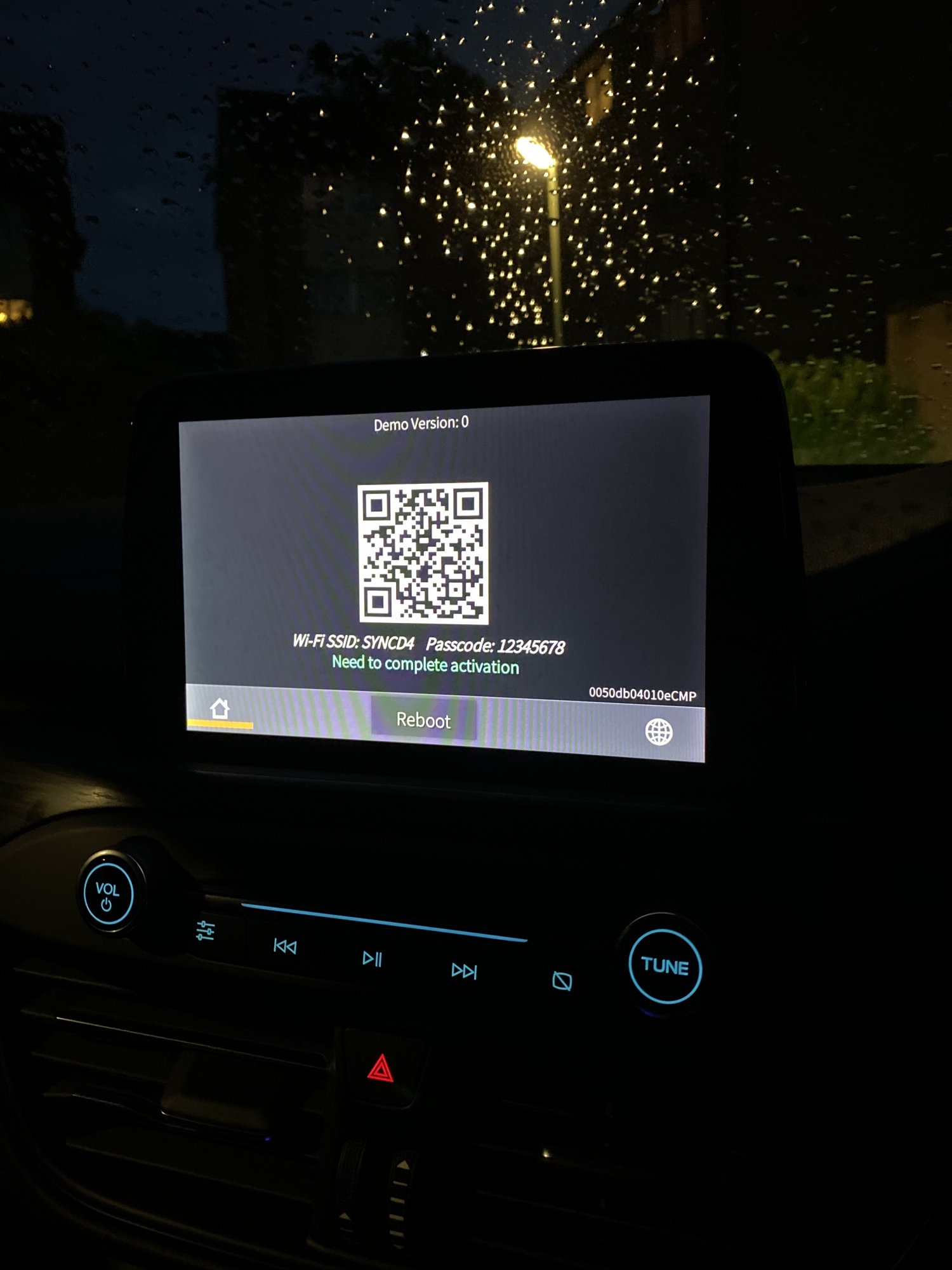

So earlier I updated, connected up all worked fine, now when I start I’m presented with this screen with a QR code redirecting me to the update URL - once I connect it says activate success, click reboot and I’m in the same loop, can’t get anywhere now.... any ideas?

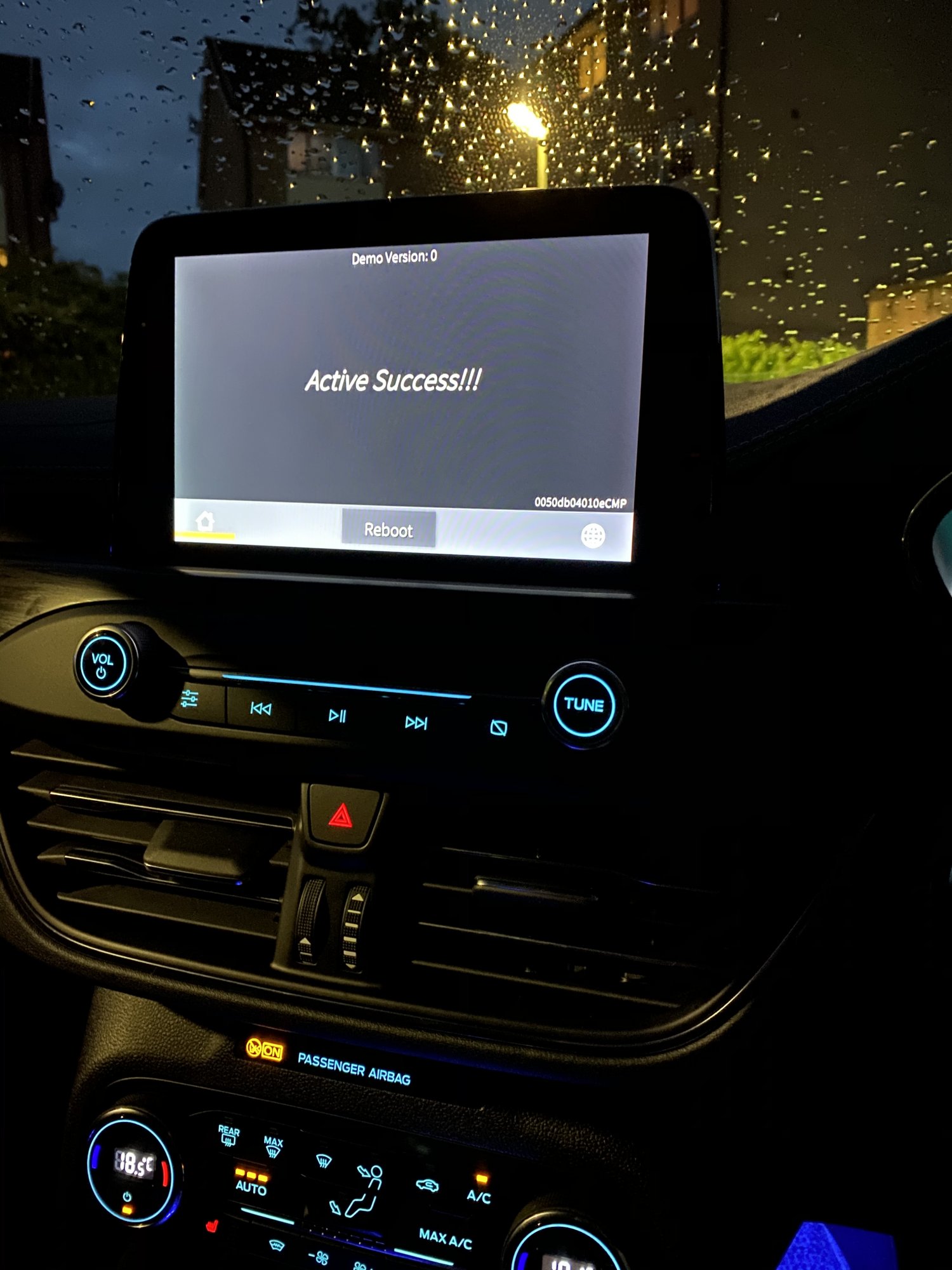

Further update from above - after going around in the same loop for 10 mins or so I gave up and left it on the “activate success” screen for 15 mins or so - thought I’d hit reboot again and to my surprise it all worked... this thing is weird wonder what will happen tomorrow!

Thanks for the report, simps. And very glad to hear it all came around for you and is now working. I'll admit, I feel like I had to loop that "activation" step a couple of times as well, before it started acting like it was activated for me. There is something amiss in there... But all is well that ends well. If everything works, DON'T UPDATE! 😉

Find out what firmware your friends Carlinkit is on then manually flash yours to that one. As long as your adapter is not on a June 2020 firmware it should except the Firmware.
check with safari 192.168.50.2 on your iPhone connected to your friends Carlinkit dongle to see the current firmware.

sounds like your adapter you just bought off someone has a firmware from June 2020 that doesn’t let you update or downgrade with USB method
manually.
