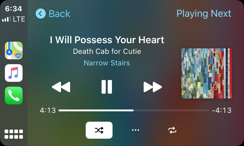

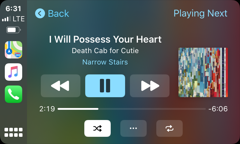

View attachment 945623View attachment 945624
You're pretty picky or OCD;). I can barely tell the difference beside the highlighted buttons. Something tells me it's gonna be a awhile, if ever.

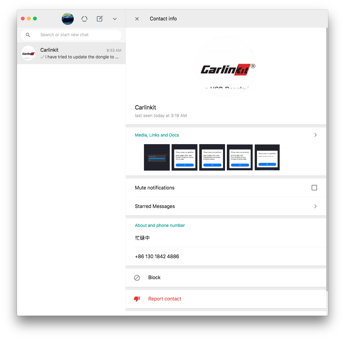

How do you communicate with the carlinkit guys? I just get no answer with whatsapp. Still trying to get help with my MB A-class. The dongle still loses connection all the time. Tried all versions, iphone X on iOS 14 beta 5.
Reactions: zeyon
WhatsApp has been my connection. We've even exchanged messages in real time later at night (11PM PDT).
What number please, I used to get a response on WhatsApp, but now get no delivery or reply.
Well, initial CarPlay had all those button and was very clunky looking, I was stoked when the button surrounds finally went away and presented a much cleaner interface. So, it just feel like going back in time. Plus the weird highlighted button that seems to change for no known reason to other buttons, it's just... So anyway, to answer your question, probably some of both. o_O
That's because they're in China--15 hours ahead of PDT. So 11pm for you is 2pm there. Probably wouldn't get any immediate replies if you send them between, say 3am and 5pm your time.
Ah ok thanks, that’s one I have. Must just ignore me now then....
Ooof. I didn't look, but is your car on their list of supported cars? Did they respond at all?
I try to, "appease the gods," in every way possible when dealing with a support group, especially one in China. What I mean by that is to be clear, concise and entertain every whim of the support people's suggestions, even if you've already done the thing already. And, throw in some, "great product," comments.
I was thinking the same thing :p The only reason the highlighting bugs me is because it will move each time I go into reverse or adjust my climate controls and eventually will start switching the actual CarPlay screens too: (GPS/Audio screen to Audio only screen to Installed Apps screen to GPS/Audio Screen, etc). If the highlighting just stayed on the screen I was on, I could live with it.
