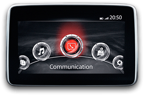

That's good to hear. Here's how my Mazda Connect looks:

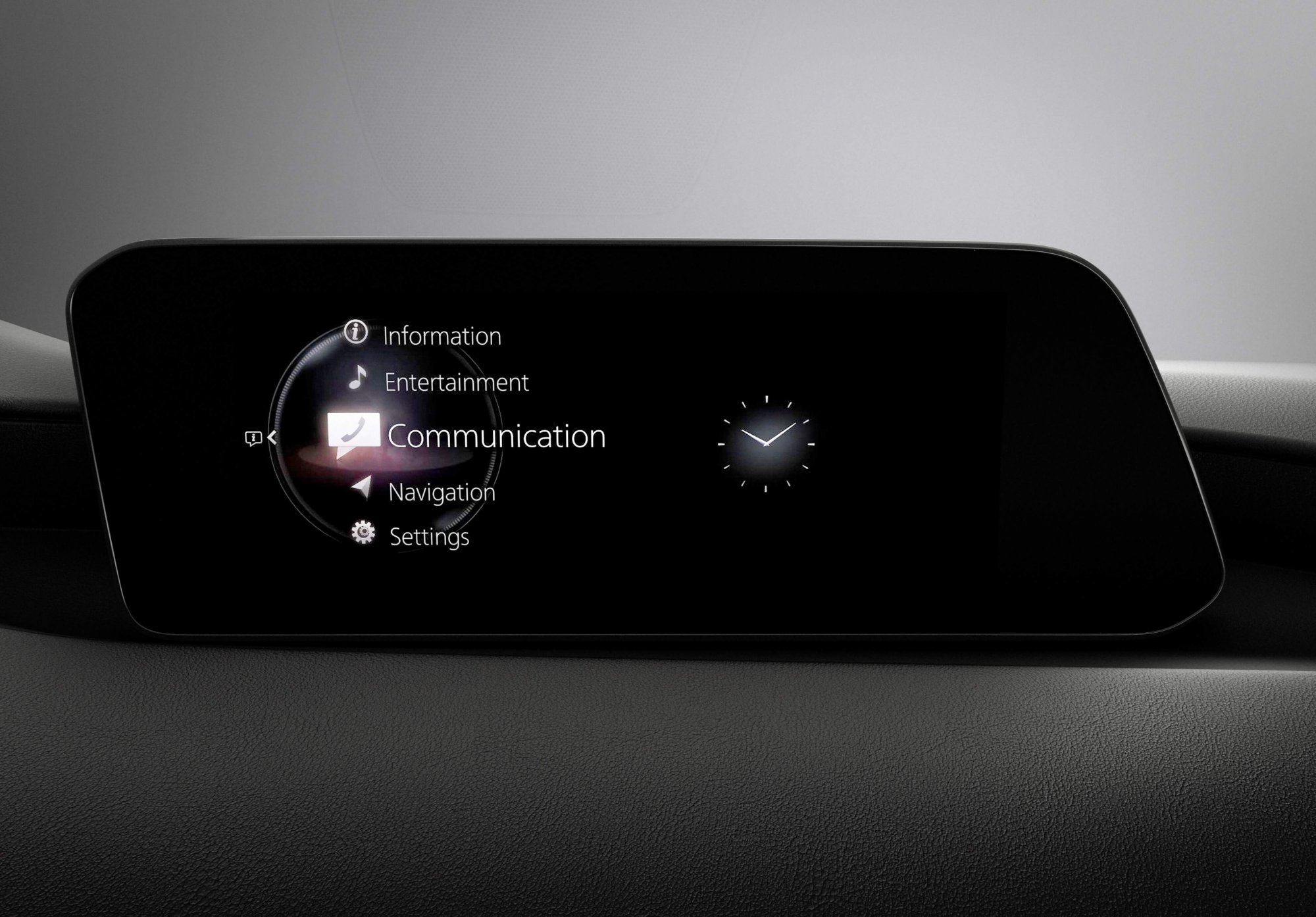

And here's the newest Mazda Connect system:
Any chance this is a software upgrade? (I assume not - that it requires newer hardware.)
it is completely a new system, impossible via a simple update unfortunately.
