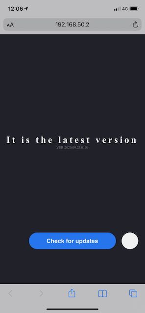

Hello all, today I had a chat with Carlinkit support through Aliexpress customer support. A zip file with an updated firmware was shared with me. Now my radio name is shown everytime I start the car instead of manually disconnect and connect the Carlinkit 2.0 USB-C dongle to get it working. I have a Volswagen Passat with Discover Media. They told there will be an official update but I don't know when. It shows as version 2020.09.23.0109
This expands as Auto_Box_Update not the usual U2W_Update
