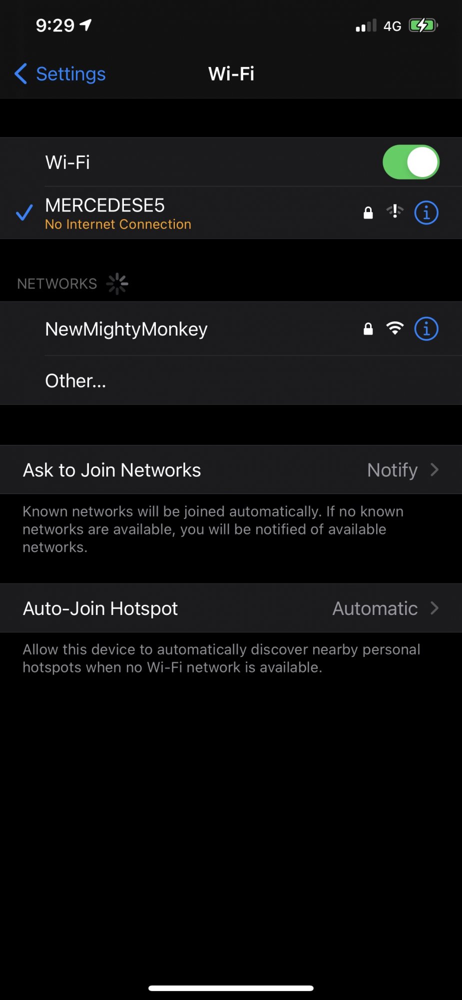

This unit is bugging the hell out of me.
Using an iPhone updated to latest IOS and with a Mercedes A Class 2017
Since getting the unit I have an issue whereby it connect successfully then after around 30secs, it disconnects, the process then repeats. I have been unable to update the firmware due to not being able to access the IP address via the connected WiFi.
The second issue I encountered is no Internet at all, when then connection is eventually established, the WiFi symbol has an exclamation point through it telling me there is no internet connection.
I have tried multiple times to disconnect, forget devices, reconnect, forget WiFi, do it away from home so no other WiFi interferes, turned Bluetooth off of my Apple Watch so it doesn’t interfere. Finally I have downloaded the latest firmware in an effort to try that and placed on a usb to update, it has completed but still the issue remains.
Whole situation is crazy lol, Am I meant to be connected to WiFi at all, why does it connect and disconnect?

Under Settings, Cellular can you check WIFI Assist is enabled? Without it I don't believe you would have internet access while connected to the dongle WIFI
That‘s normal. It connects to the WiFi of the dongle and there is no internet connection.
