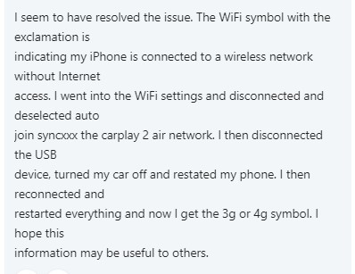

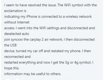

That‘s normal. It connects to the WiFi of the dongle and there is no internet connection.
So with respect to that, how are firmware updates completed via the IP address provided? The manual/website suggests it should be done that way and not manually. I also received the attached from customer service as a way to try to resolve the issue, again this did not work
While connected to the dongle your phone is "supposed" to use your cellular connection for internet access. That's why I asked about WIFI Assist. When launching the 192.168.50.2 page you're connecting over wifi and retrieving updates over cellular. The phone routes your traffic accordingly and it should be transparent.
Perhaps try to disable/enable WIFI assist if not done already. Another possibility would be to reset Network Settings if you're comfortable dealing setting things up after.
