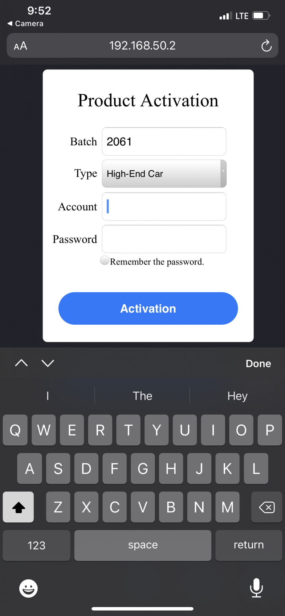

Thank you Vlud for your help! So I followed your steps and got my adapter to update/ install whatever files from 03.06.2020. When my adapter rebooted and I put it back into my car, it worked! No more black or blank screen on boot up.
But, now i've encountered the product activation problem. I have no idea how to activate it, how do I? Thank you so much for your help.
EDIT: So I also had to enter the wifi password, 12345678 in order to connect to NEX7D (CP2A adapter). But no option for bluetooth, which I assume is waiting for activation? I've got no idea what to try next. It also said the batch number it generated, 2061, is invalid...
I also created an account on the carlinkit website as someone mentioned around page 47. I entered the email and password I created from the website, but without a valid batch number, I can't continue.
I can tell I'm so close to figuring this out lol. I will update if I find anything.

You will need to try emailing sales@carlinkit.com and tell them you need to activate your adapter. They'll need a log (you send that from the 192.168.50.2 site) and make/model of your vehicle. They will send you the numbers to fill out on that screen.
This was the process for me back in Feb/March. But given that this was a flash backwards from newer firmware I'm not positive it will work, but worth a try if you must use March firmware.

Okay, so I tried this 4 times and got the same result. After applying this code to the 03.06.2020 custom firmware, the adapter will not boot. Once I applied the code, the unit would brick until I manually flashed either your custom 08.04.2020 or the public 08.04.2020, which returned it back to normal operations.
So I repeated this process 4 times, install custom 08.04.2020 firmware, install custom 03.06.2020 files, insert custom code (from your quotations), unit failed to boot. I am certain I copied the code word for word. I had no problems installing the custom 03.06.2020 files, other than of course the activation problem. So this custom code did not work for me unfortunately...
I really appreciate your effort and will be buying you a meal after all of this!
I will contact them now and share what happens. I am using an aftermarket Pioneer MVH1400-NEX with iPhone XS Max on IOS 14.1. This will take awhile to hear back but I'll be sure to share anything I find.

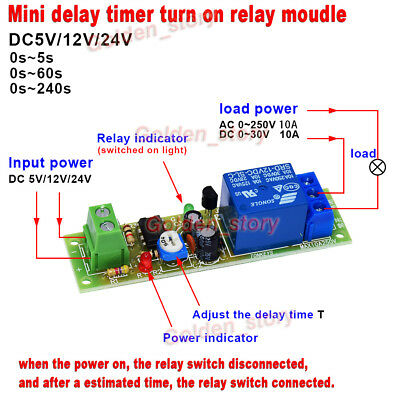

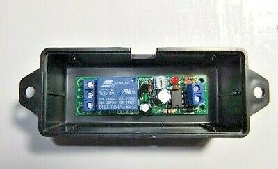

@BUXjr these are the items that I purchased.
The 5V 60 second delay relay. I paid the extra the $2.75 for shipping and I got it in about 10 days:
The enclosure link. I had to purchase it with another delay relay however, it's a 12V relay so it won't work, the way we are trying to use it. I messaged the seller and he said I was unable to purchase just the enclosure.
The usb extension link through Amazon. I bought the 1.5ft one because I have a 2017 Tahoe and I have this behind the radio in the storage department plugged into the USB. If you are putting it in the center console and hiding it like @2018 Denali, you would need a longer extension:
Attached below are the photos.
Hello,
Can you please confirm the wiring for the delay harness you made? Red power goes to + on input end, and black goes to GND on input end. Red jumper goes from + on input end to COM on output end. Black jumper goes from GND on input end directly to black wire on far end. Far end red wire goes to NO on output end. Is this correct?
