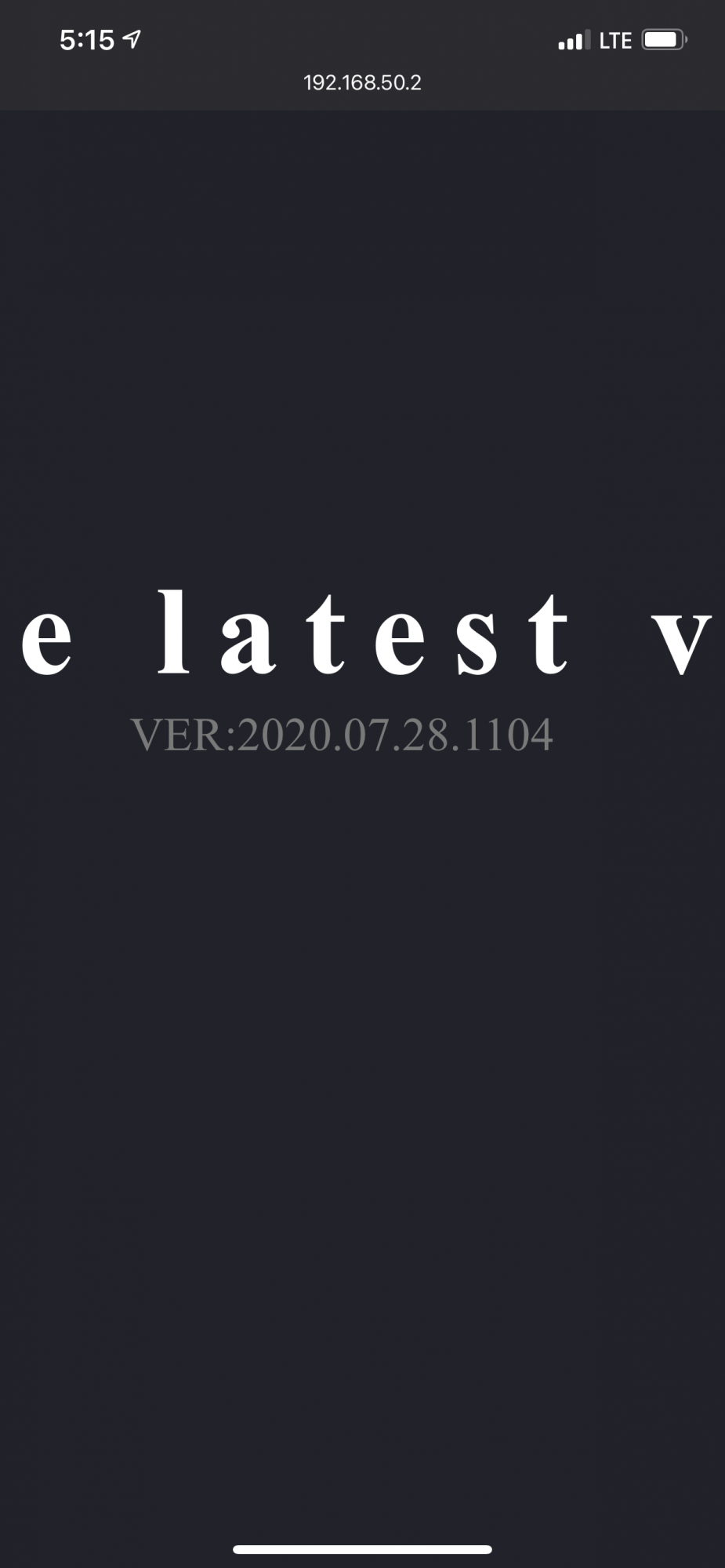

Sorry if this is a noob question (183 pages is a lot to read through) but has anyone else gotten stuck with the stock firmware that came with it? I just set up mine up (Carlinkit 2.0 USB-C from Amazon and the web updater is showing 2020.07.28.1104 and that that is the latest version. I'm seeing from posts though that there were updates in August, September, and October. Any tips on how to force it to update?

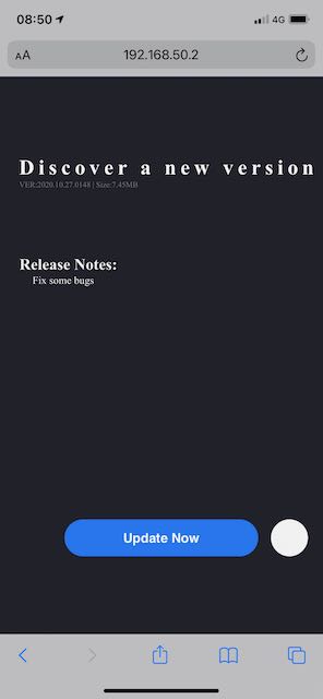

There is an OTA update 2020.10.27.0148.

Did you try the solution to put the firmware from my post onto an usb thumb drive and do the update manually instead of OTA. Maybe if you upgrade manually to the version from my post you can update OAT to the latest version

Been out of the loop. I have been running 8.04 for a while now. I’m hoping I’m not “stuck” on seeing later OTAs. Will try at lunch today.
I just flashed to 9.23 which is the latest available through the link on post #1. Hopefully it took and will then see the latest OTA updates. Will try on way home from work.

Where can one download this? The link on the first page goes to a blog post with a firmware from 2019, and the firmware section of the site requires some kind of log in.
see my post #4,411
and then there should be OTA available, I can't imagine that there is anything specific to my usb-c dongle. I receive the firmware from post 4,411 by email from Carlinkit and the one from post #4,564 is OTA.
see my post #4,411
The problem is that this is not working, so there is something related to your dongle type / id, can you reply to my PM ? It would help me find out how to get the image for everybody
