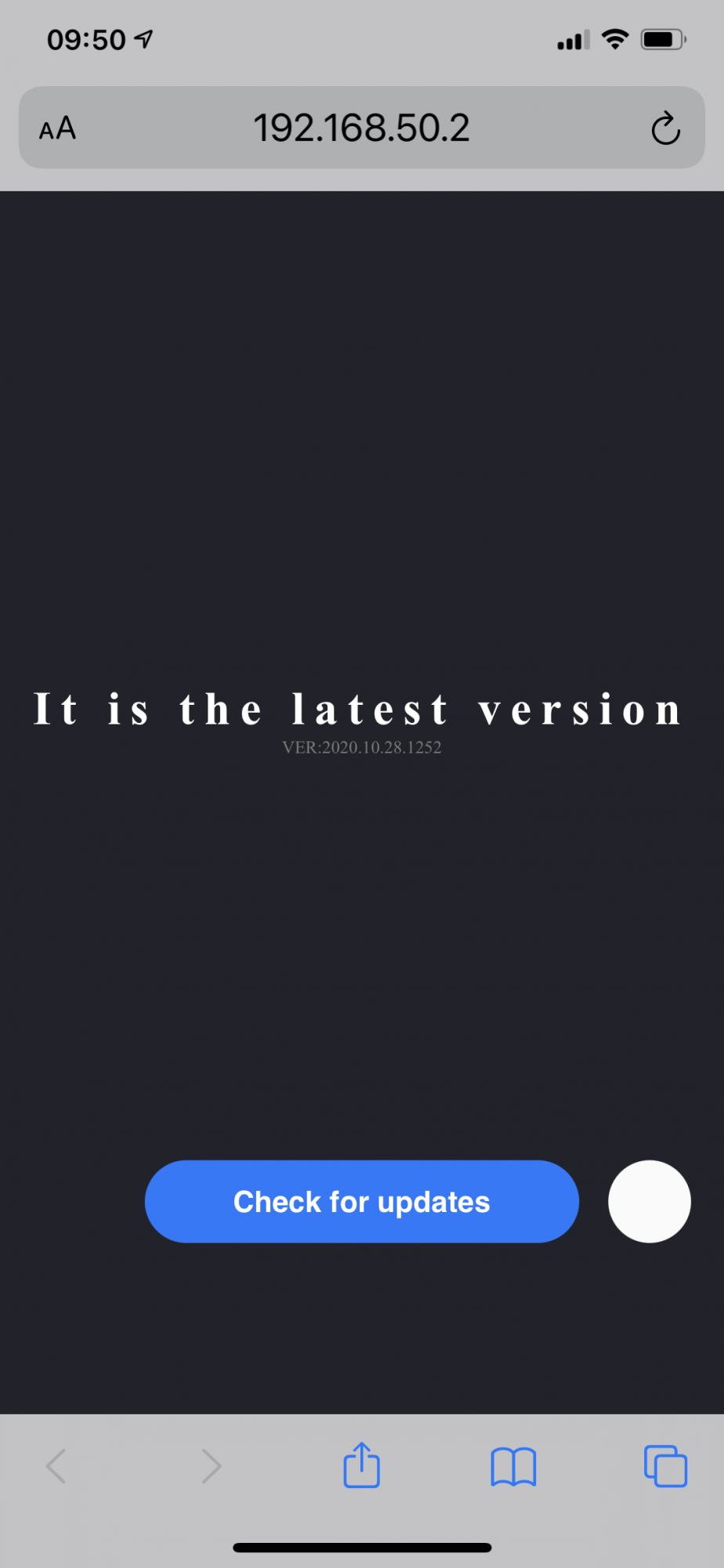

Bad news: OTA is still showing no updates available. @VLud any thoughts?

Not Odd. OTA checks your version against the last OTA release which as of this writing is 8/4 v2 (kidding but there was two different 8/4 releases if I recall [the second a roll back version]).
** The OTA check is intelligent enough to compare anything 8/4 or newer is the lastest. That is it does not say O well you have 9/x let me update you 9/y that was never OTA released.

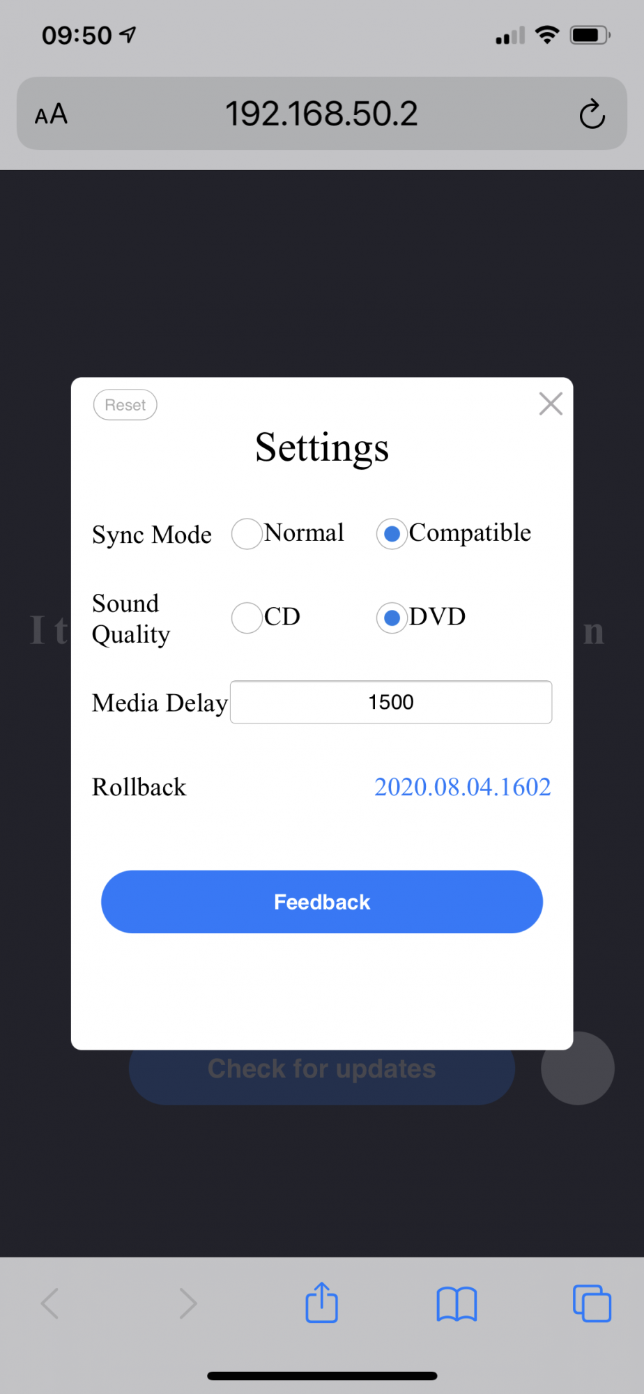

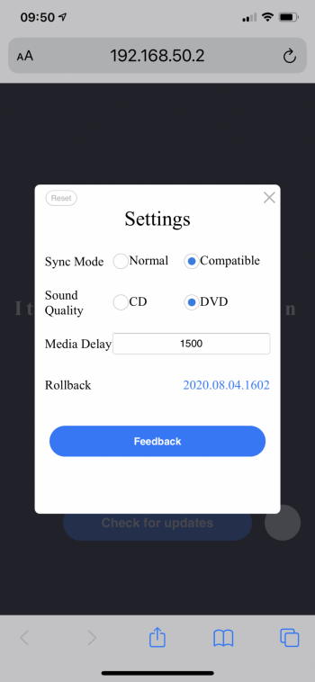

aha so rolling back to 08/04 should allow me to get the 10/27. will give it a try .

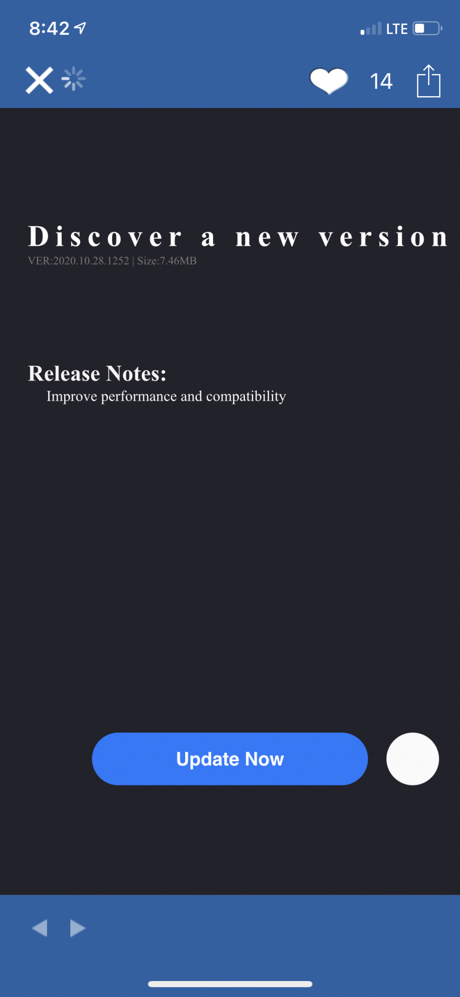

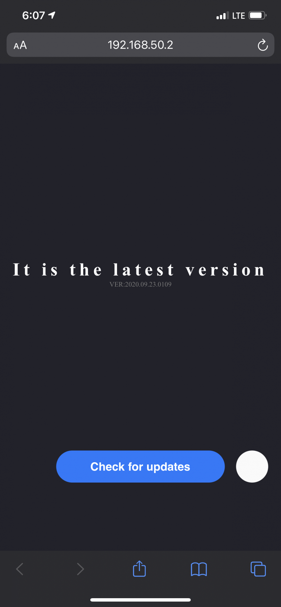

So I tried again and it Shows up. I was on manual update from 9/23 which proves you don’t have to have been on an OTA update to get it. Curiously it shows 10/28 not 10/27 maybe they changed something and thats why it wasn't available when we all tried OTA yesterday. Hoping it works better in my Volkswagen and text notifications work.

OTA 10.28.20 IS OUT YAY. Cant tell you more then it was successful OTA update. Was 7.2 MB. Offered improvements and compatibility fixes. Played music for a few seconds after and turned the car off. *** As always after it completes be patient even after the successful message let it boot back up on your AV UNIT.
Reactions: Diehminer
10.28.2020 OTA fixed my blank/black screen issue. I timed engine start to carplay displaying in a record 28 seconds!
