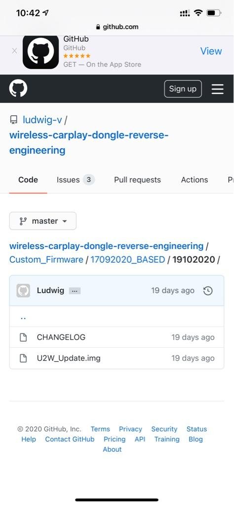

I added images on the repo there is an official rollback release (2020.08.04), then you can flash 2020.10.28
I also created a custom firmware based on this new version (2020.10.28), available here:
(Rollback to 2020.08.04 Custom FW or official before)
