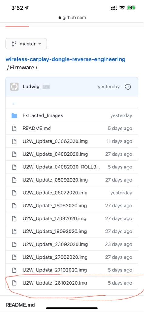

Thanks. Just the link you said is the custom firmware.
Where is the official 2020-10-28 to download and I’ll try that.

Screen shot of the URL I posted and the latest official firmware 28.10.2020 is circled. Don't forget to rename the file after download.
Thanks I’ve got that now, I’ll try tomorrow.

From which link? As the one above is different to Vlud one... confused which is which
This one?
Here is the update from 2020-10-28:
(Rename the file to U2W_Update.img)
...or this one?

Both are strictly identical, it is the official firmware.
The custom firmware is here: https://github.com/ludwig-v/wireles...ng/tree/master/Custom_Firmware/28102020_BASED
Minors modifications that won't make any car compatibility difference (if it does not work on official, it will not work on the custom FW). Disabling logs and "performance" CPU scaling governor ensure less potential crashes and executing custom scripts can be useful in case the unit is not displaying anything on the car
