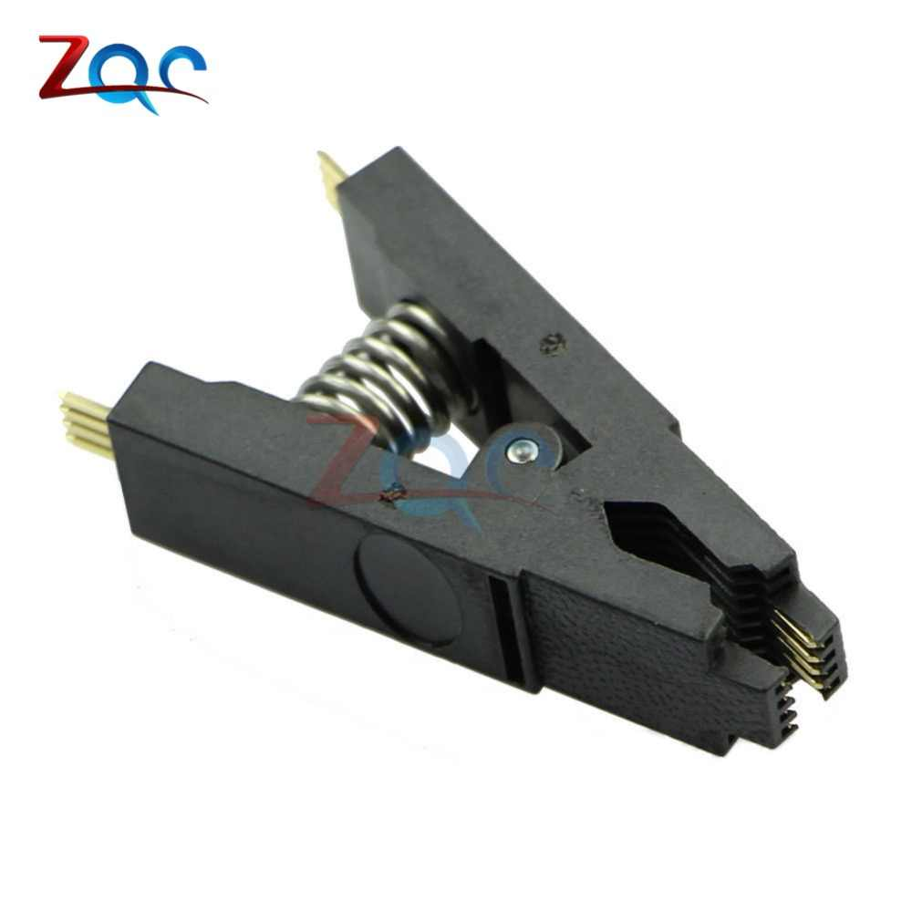

@VLud just in case it saves you soldering each time, I have discovered that these clips work reliably on the tl8633ii. Only <$2 and flashes every time from my backup.The only way is to have a backup of the flash chip before it bricked (requiring -de-soldering), so at the moment: no solution.
