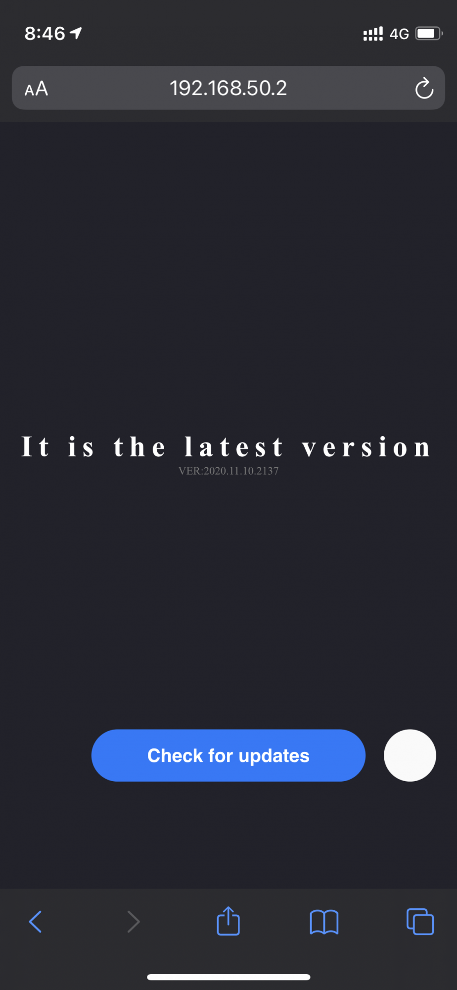

Latest firmware is 2020-11-10 though now
I have also manage to upgrade to the latest 11.10.2137 via OTA thru 192.168.50.2
will see any difference these few days from 10.28.
Current device:
iPhone 12 Mini
IOS:14.2.1
Honda Civic 2019
Current device:
iPhone 12 Mini
IOS:14.2.1
Honda Civic 2019
So far I can tell that clicking response is slightly faster, changing songs track felt faster compared to previous.
overall still smooth. I think is slightly stable compared to earlier 10.28 version.

For me still showing 10/28 as newest OTA. They must have pulled 11/10 again. Not having any issues with 10/28.
