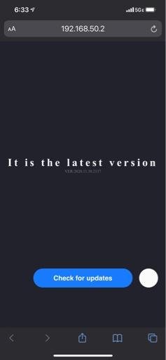

I got an email. My guess they have kept a list of people that had problems and asked for support. It was really a surprise. The email informed that a new firmware was available and if I wanted to try I could reply (to a different address) to get the download instructions.
I have not checked the version and there is no information on the email or on the download site (Google Drive). I will go down to the car and check it later, but I assume it's the same (??)
Response to touch is good. Music, Spotify, Maps, Phone all work. Steering wheel controls are very responsive. Song title properly showing on the dashboard. I have not noticed any considerable lag on phone calls. But need to do some extra testing to 100% satisfied. And connection takes about 15 seconds once UConnect finishes loading.
So far I'm impressed. This is what I expected an year ago. Now with a MagSafe charger (just use double sided tape to attach it to the side of the console - no need to see the screen) it's a great combo.

So you didn’t ask for the download link from them, and just used the link for 2020-11-10 from the first post?
Be worth still asking for the link from them and downloading it and posting for anyone who wants.

Got the file from them (asked for the link). I've made a copy at:
As for the MagSafe, I have an Anker PowerDrive charger. Not sure it's working in full mode, but it charges the 12 Pro with MagSafe (phone using a Totallee soft case).

Thanks, maybe helpful for someone, and/or to decompile as some above have.
Be interested to know what version it shows as well though. Just use your iPhone to connect as normal and go to 192.168.50.2 and it will show if an update and what current version is.

I did the OTA today and it worked for me. The startup phase seemed faster and I confirmed the dongle still uses the vehicle GPS. Didn’t notice any other improvements or issues during the short drive. Songs may have skipped less frequently, will see how it goes over the next few days on that front.

Here is the latest manual update available for Connectivity and Compatibility issues.
Before you perform the update, please watch this video to guide you on how to properly perform the steps:
https://drive.google.com/file/d/1akjOcSqQE3Uf8dfrO8n0JFlvPhzsC_Tc/view?usp=sharing
Update instructions:
1.Please download the firmware update file from here:
https://drive.google.com/file/d/1KKPbwbR23EivvDZcVpANP-8D9Nh_1G5-/view?usp=sharing
  1. Please save update firmware file on USB flash drive (Flash drive format must be FAT32) as "U2W_Update.img".
  2. Plug the flash drive into the CPLAY2air adapter.
  3. Plug CPLAY2air to the USB power charger/wall charger for your iPhone. Please don’t use the USB port of the car or computer!!
  4. Please wait 2-3 minutes, until the the flashing light becomes solid
  5. Please unplug the adapter from the USB charger and remove the USB flash drive from the adapter.
  6. Please now plug the product into the USB port of the car.
  7. Please wait until the new window will appear on the vehicle's screen.
  8. Connect your phone to the Bluetooth network which is shown on the screen.
  9. Wait for the new interface to appear on the screen.
Very Important note: Do not attempt to connect the adapter to your computer's or laptop's USB port. These ports are made to transfer data and will just interrupt the update process and brick the device.
