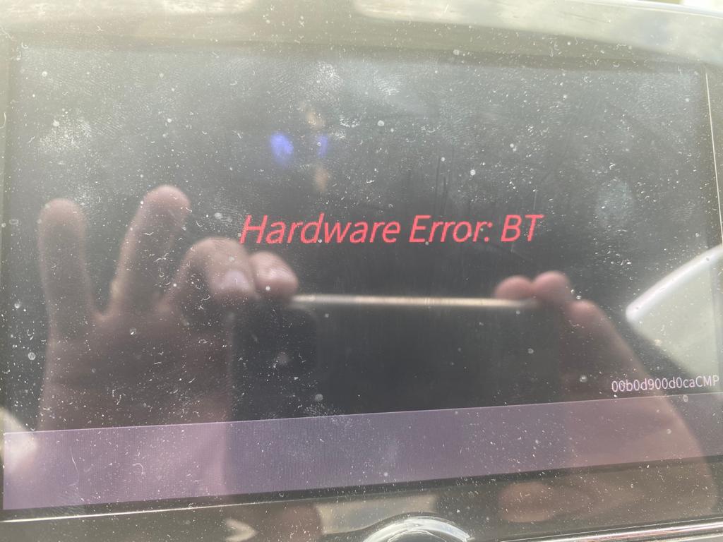

I tried again and now I had a different error. The display shows this message: Hardware Error: BT. This error code was included on the message: 00d0b900d0caCMP.
I loked for it on the internet but I didn't have any result. The mobile conected sucessful once but after 10 seconds it disconected.
I saw that the adapter flashed the blue light many times when it was trying connect.

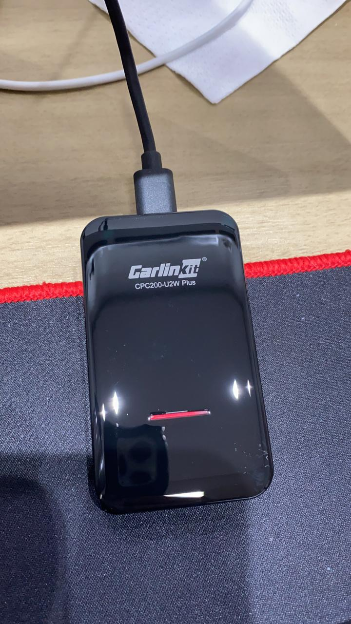

Hello! (thats my first post!)
I've recieved CPC200-U2W-plus today, connected it to my Seat Ateca 2018.
Device worked for 5minutes but with a slight delay so I tried to make a software update. Typed 192.168.50.2 in Safari on my iPhone. Downloaded VER:2020.11.10.2137, installed it (during this process red and green lights were flashing), my browser showed "Upgrade successful" popup and... device stopped working. Light went off and never came back. Now when I plug in the device nothing happens.
However.... sometumes when I plug it into USB Wall power outlet (1 out of 5 tries) it shows solid green light.
Is there anything I can do? Please help 😭

Hi, I had the exact same problem. I've tried all sorts of ways but I couldn't get the device to restart. I re bought a new drive but will stay away from this firmware. Those who updated via usb had no problems. Through OTA instead the device blocks.
I really have the impression the USB update way is more stable
I finally solved my issue, support told me I could downgrade to august from web interface but I was not able to connect to the wifi...
Then I looked at wifi networks and found a AUTOBOX-XXXX, connected to that and the interface was again accessible.
Downgrade to august release did not solve my issue, however, after install november ota again, pressing the restart button again in settings menu did the trick!!!
