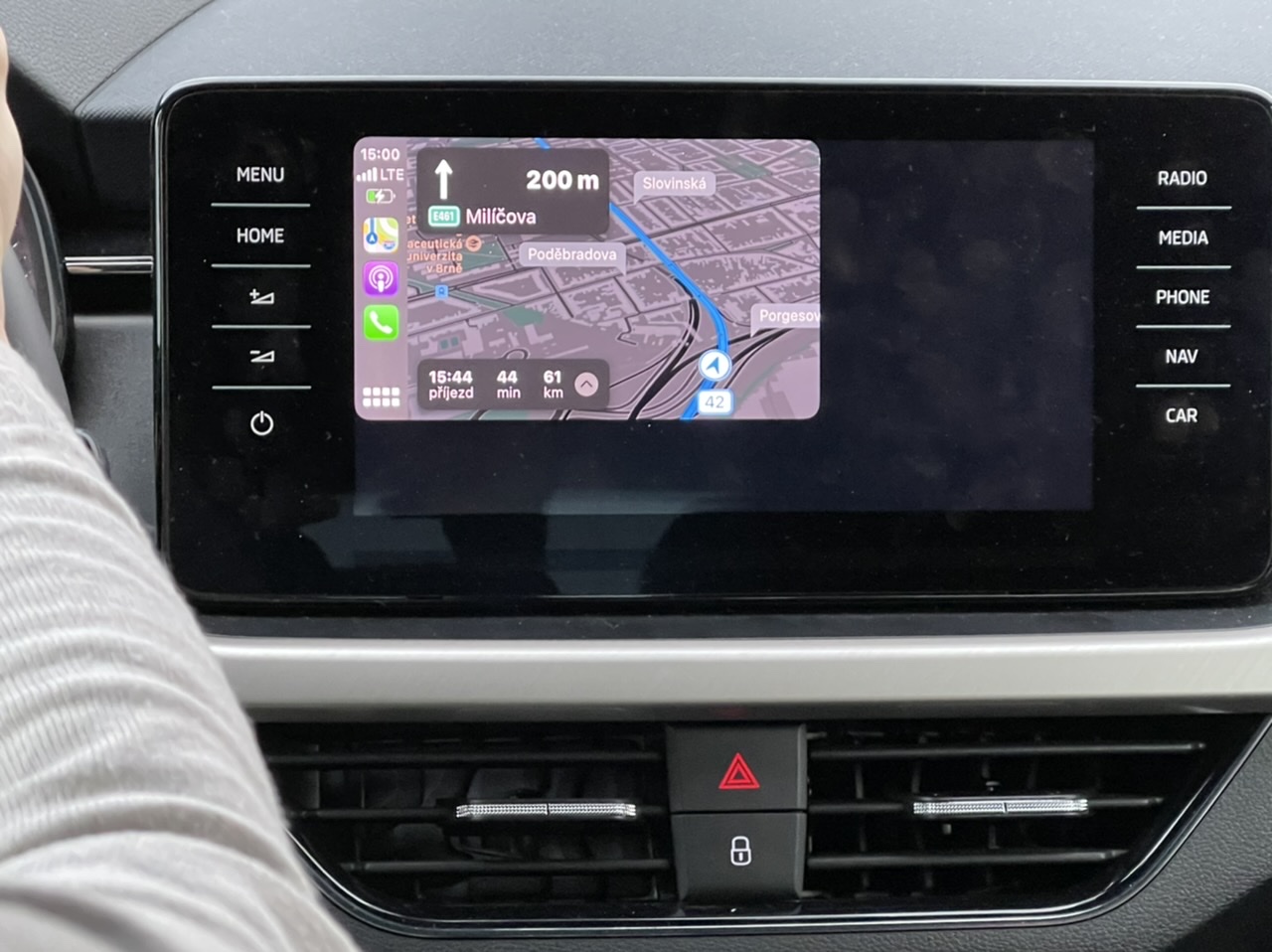

I have just bought Carlinkit USB-C version and updated to latest version. But only small screen is shown. Why is this happenning? I have 2020 Skoda Kamiq and wired carplay works well.
