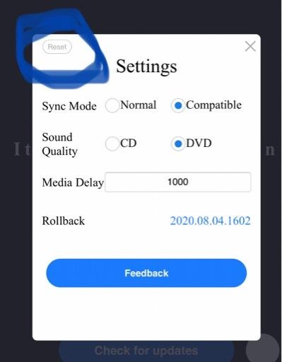

Press the reset button on the 192.168.50.2 interface and I think that deletes all and have to pair again.
I had 2 could never connect, tried this and it connected and can only see 1 in the interface.
The reset is hard to see but is there
Thank you that did it. I would add that after you enter the 192.... address it showed I'm up to date, I had to click that white circle and it brought me to the settings page than I clicked reset

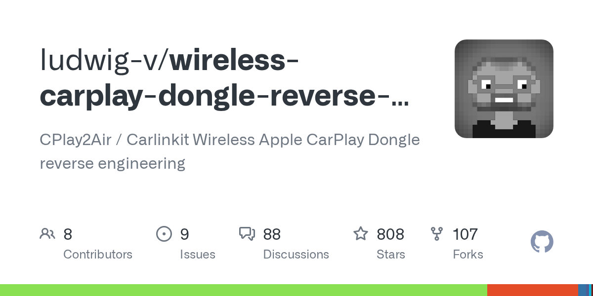

I added images on the repo there is an official rollback release (2020.08.04), then you can flash 2020.10.28
I also created a custom firmware based on this new version (2020.10.28), available here:
(Rollback to 2020.08.04 Custom FW or official before)
