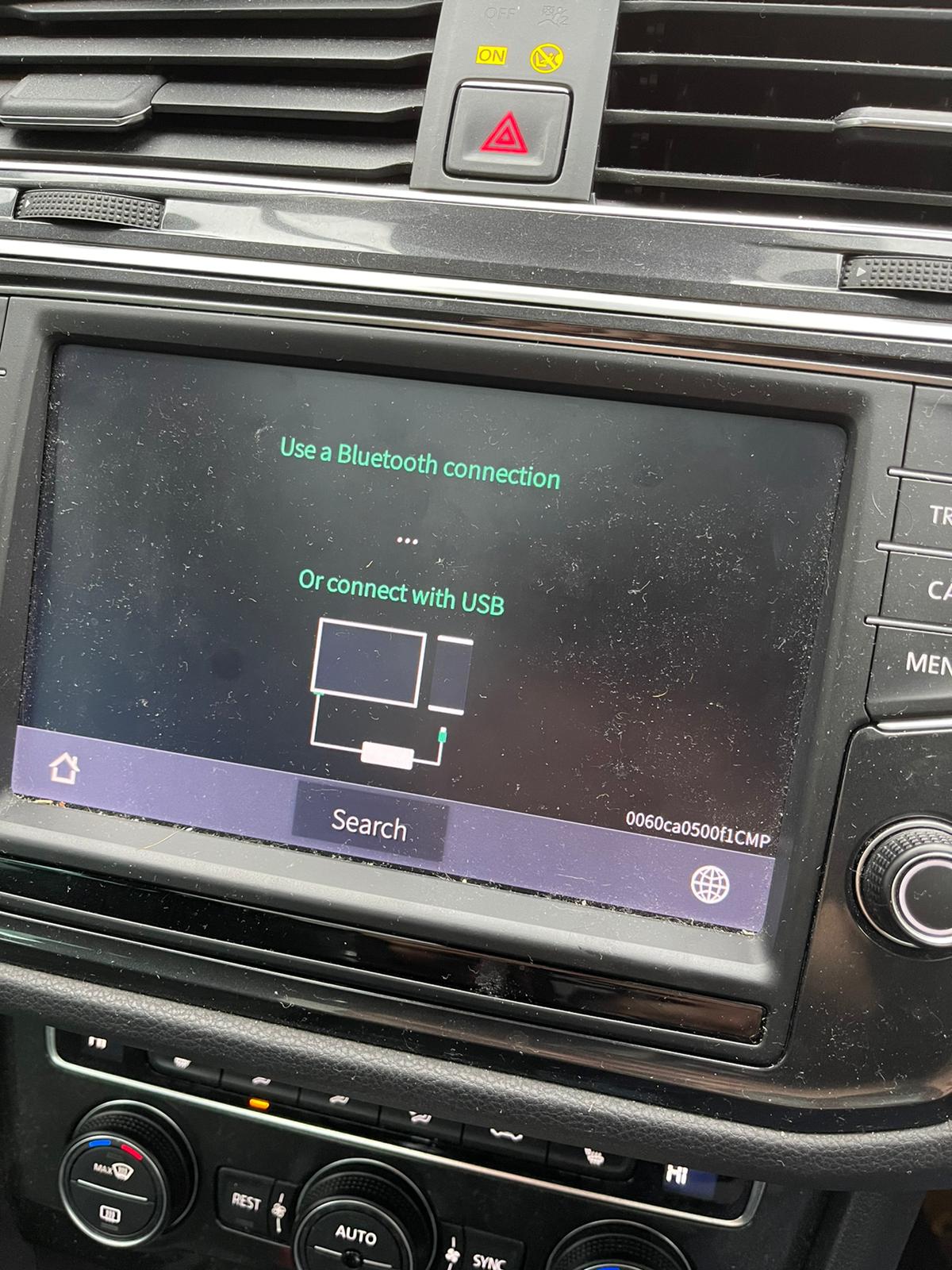

Any ideas please @VLud ? You seem to be the one keeping the dream alive! I have a 2016 Volkswagen Tiguan and am using a iPhone 12 Pro Max to connect. Firmware usually works flawlessly with first flash, but then on a second try after a long power down in the car USB port or just unplugged for over 10 minutes, it’s back to not generating any networks and the LED stays red, tapping the search button does nothing. Only way to get it working is to reflash via USB.
Thanks in advance 🤞🏻

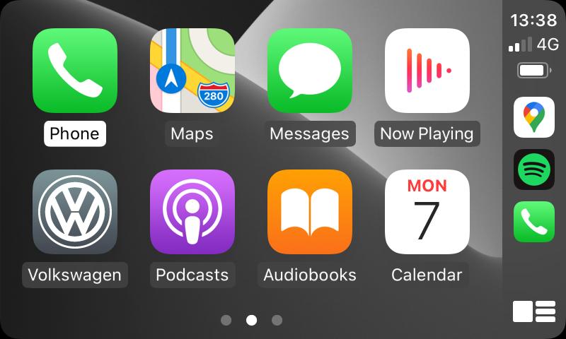

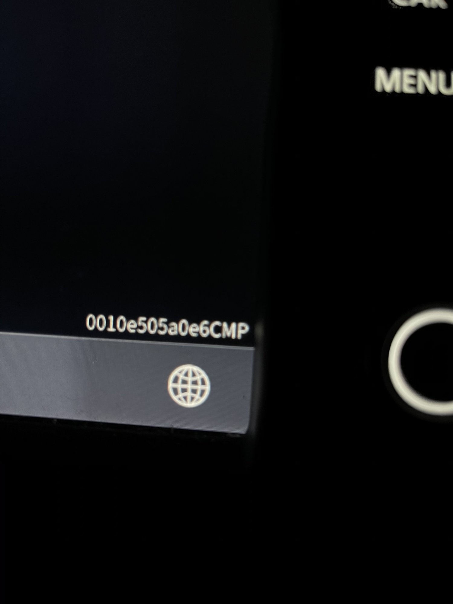

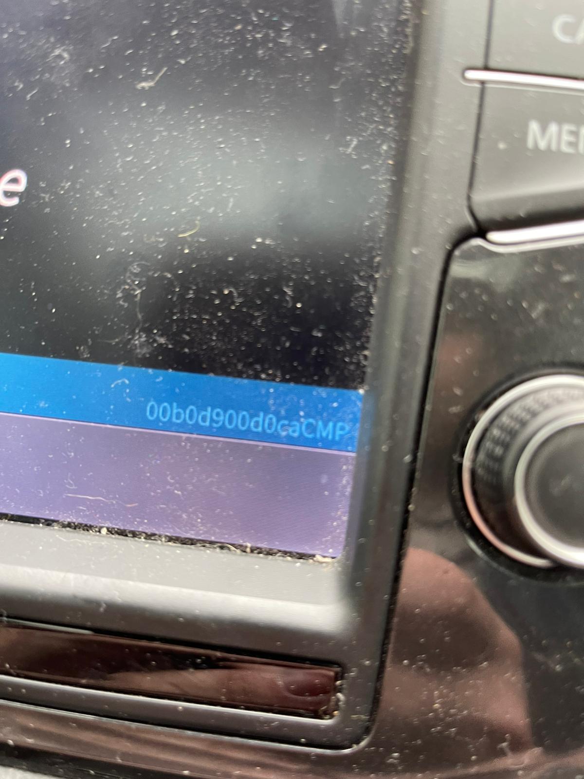

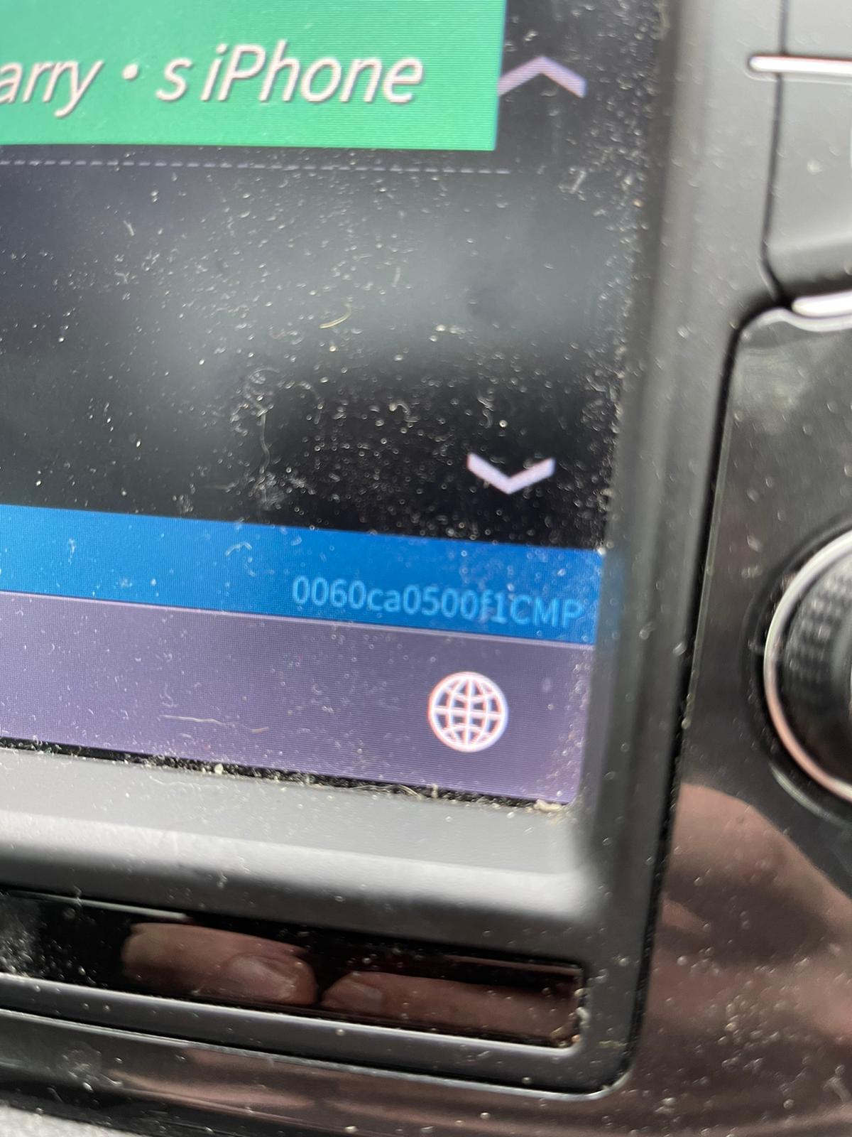

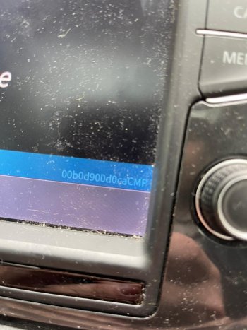

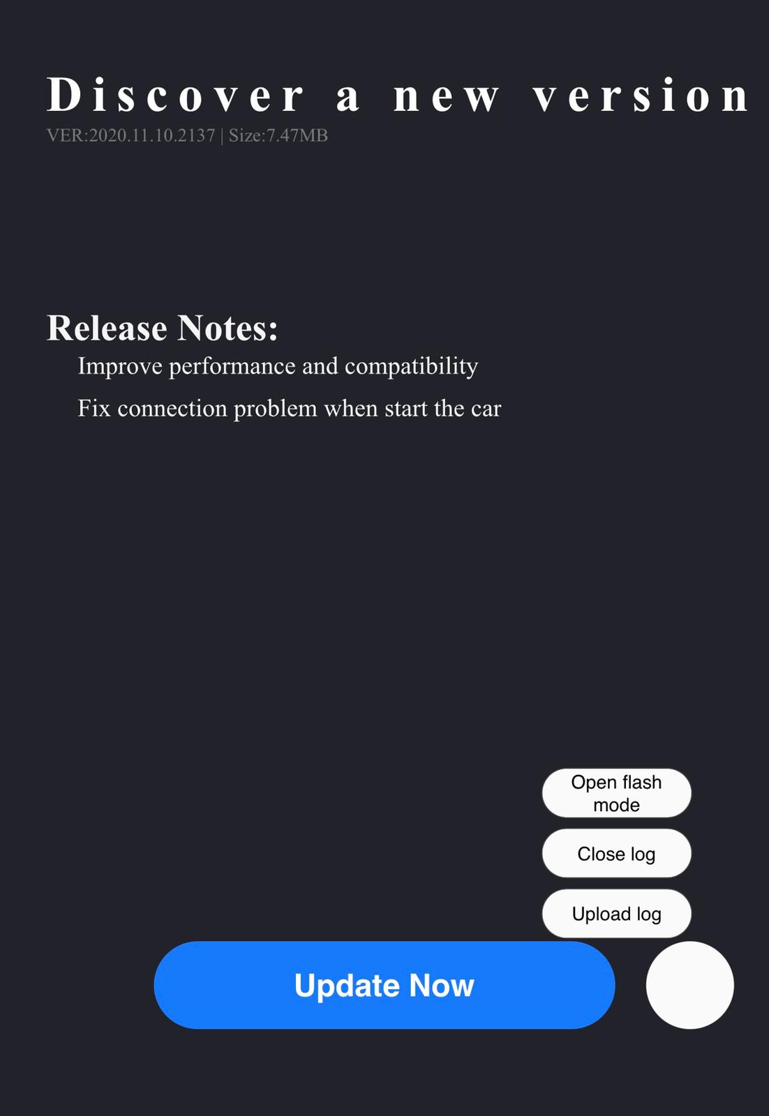

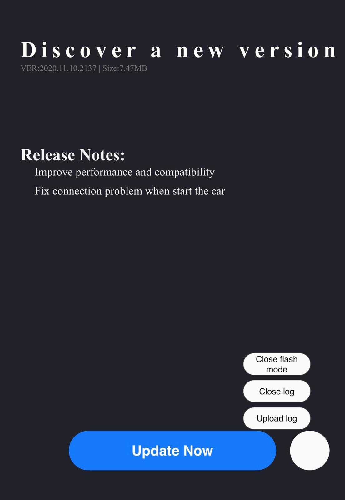

Update. I was able to reflash the @Wallytax firmware, plugged it in and connected flawlessly, then upgraded to the latest firmware as I didn't have a rollback option, then downgraded to 2020.08.04 via OTA which worked perfectly both times. Waiting to see what happens once I've left it for over 15 minutes. I want to try the custom firmware of @VLud but also don't want to brick my device by trying. I assume my dongle is on stock 2020.08.04.1602 but I cannot be sure as I assume I will not be able to connect again to check. If it is on stock 2020.08.04.1602 can I just start flashing the custom firmware on top of that?
Also, when clicking the white button on the IP page it now gives me an option to 'open flash mode' or 'close flash mode' which I have never seen before or heard mentioned. I left it on 'close flash mode' before unplugging the dongle. Pictures below. The string of letters beginning 0060 is the rollback version and the other image is the upgraded 11.10 firmware.
p.s. fun fact it takes a screenshot of the Carplay screen at the same time when you trigger a screenshot of your phone!

I made some progress today. I managed to update the firmware to 2020.11.10.2137. Once that was installed, I reconnected the dongle to the Miata, got to the search screen, and eventually got fully connected to wireless CarPlay. But it only works for about 30 seconds, then loses the connection and goes back to the Mazda infotainment screen, and within the next 30 seconds, CarPlay returns, etc. This just repeats over and over. I recall seeing other folks with this problem. Has anybody solved it?
