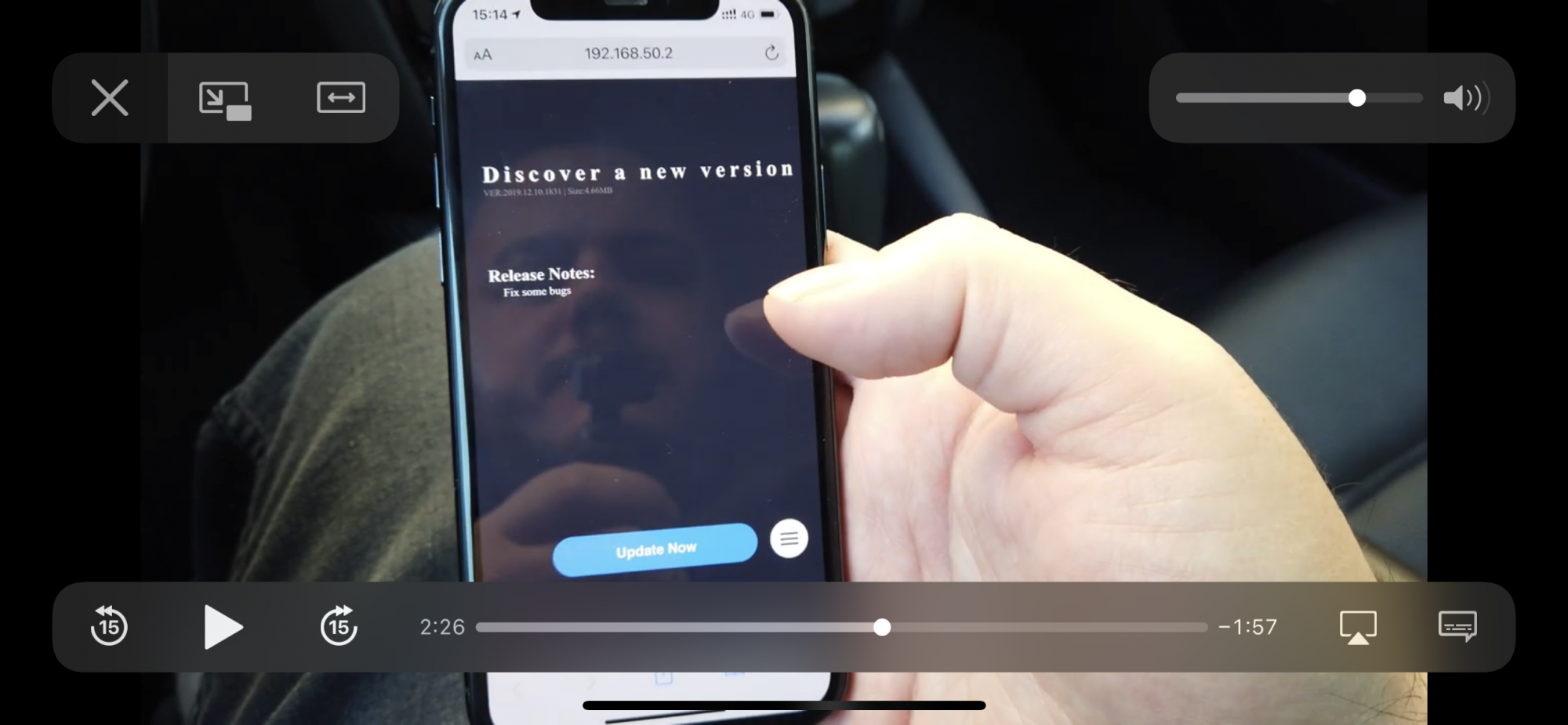

I've accessed the settings and update screen at 192.168.50.2, and I'm wondering if the "Sync Mode" options might help, but I can't find any documentation on what they do. I'm currently on Sync Mode Normal, but could switch to compatible. I'm on DVD sound quality, too, though I don't imagine changing that would do anything.
The settings also give me the option to roll back to 2020.08.04.1602 and it says I'm up to date. I'm reluctant to try rolling back to a different firmware given the possibility of bricking the device as outlined on this thread.
Any ideas?

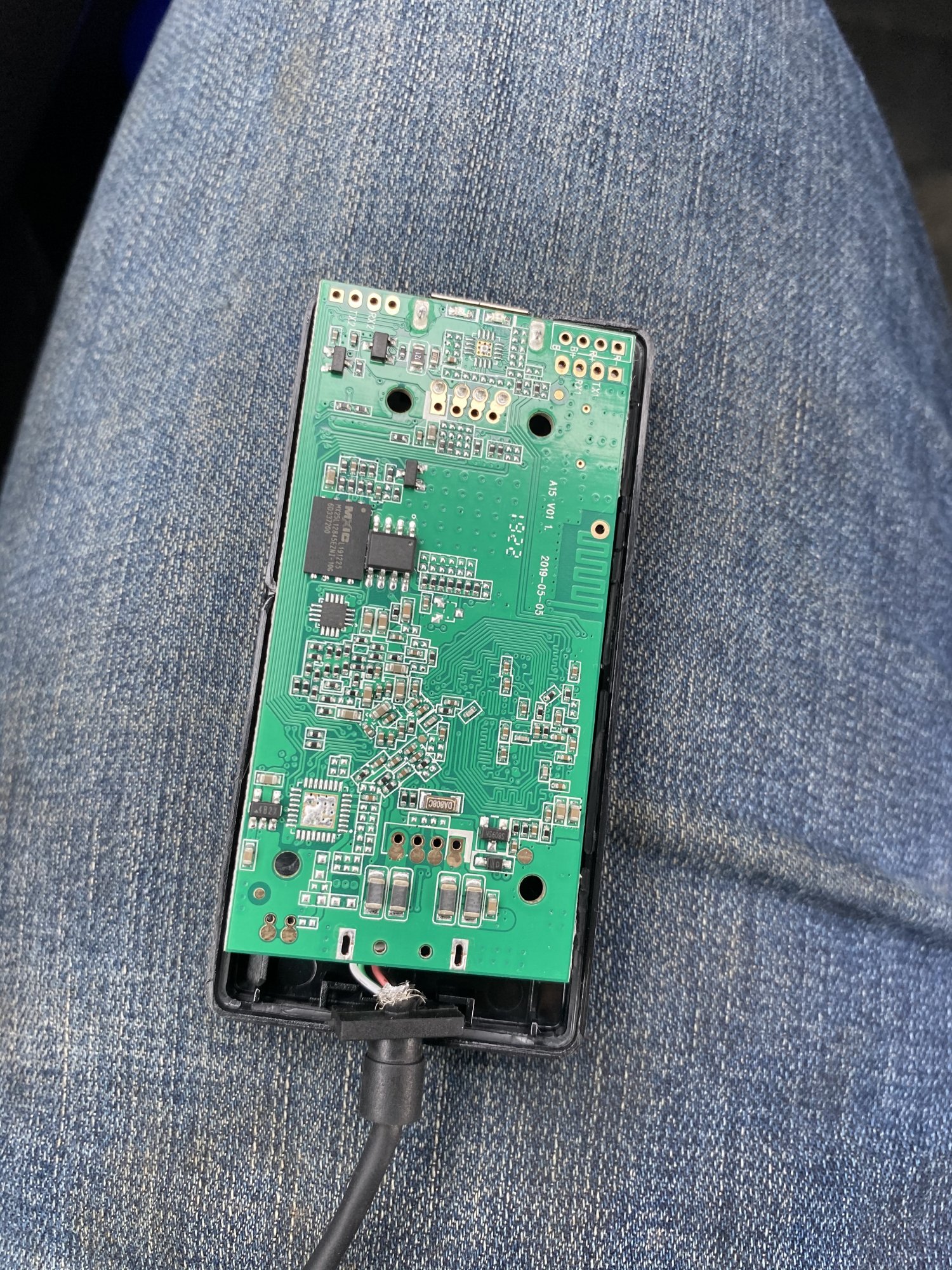

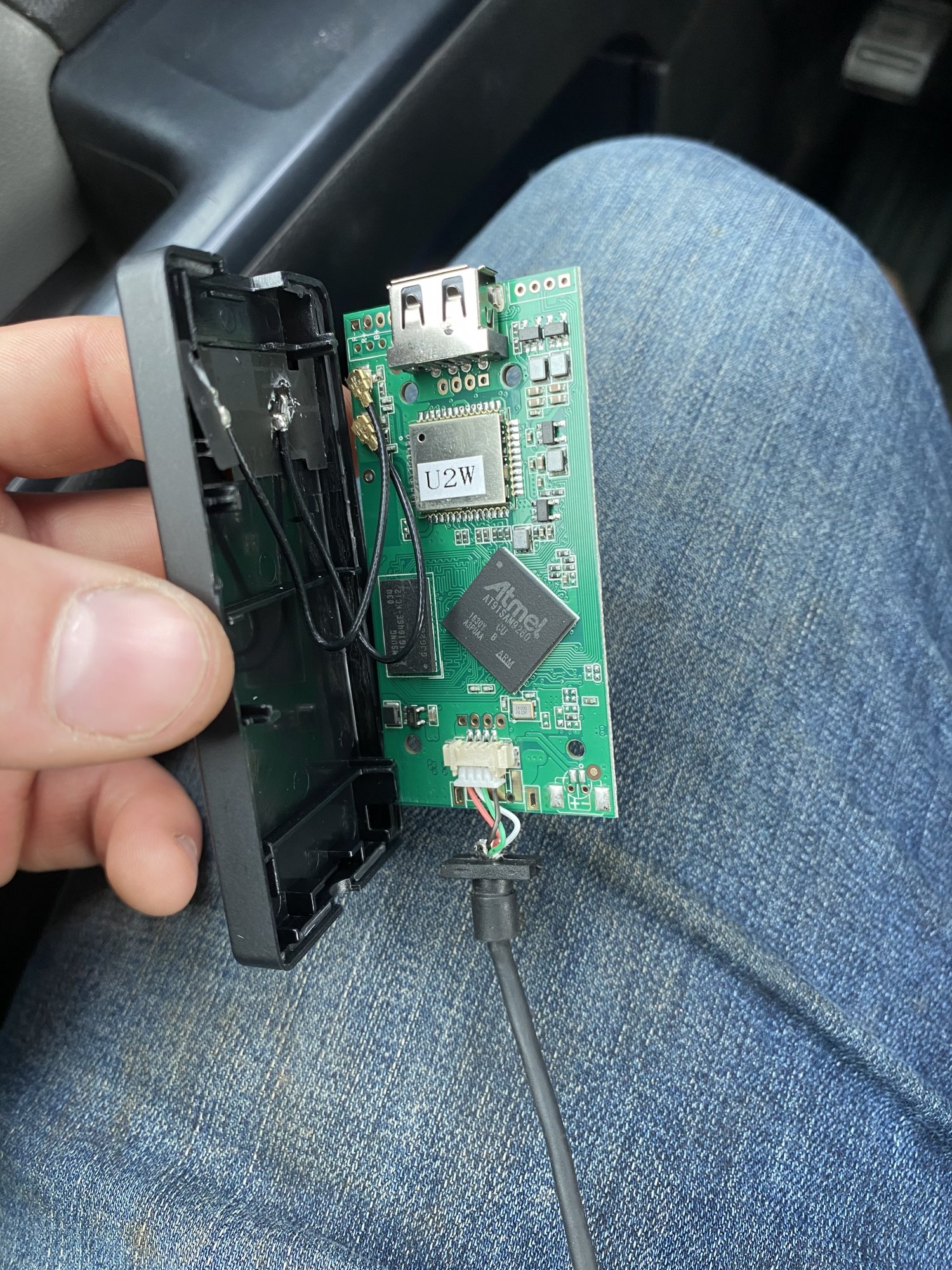

Alright so no luck with anything I tried post #4907 so I was convinced that somehow it must have got water in it and shorted out. After opening the case I’ve discovered such is not the case, however I see the USB cord can quite easily be replaced via the connected pictures. That’s the next go. Anyone have any idea where you’d get one?
Did it encounter water at any point? Because if so it could have caused damage that isn't visible to the naked eye.
Not sure what the name is of that connector that is on the other end of the cable--maybe someone else here will know if that's something you can find ready-made or not. If not, you might have to make one.

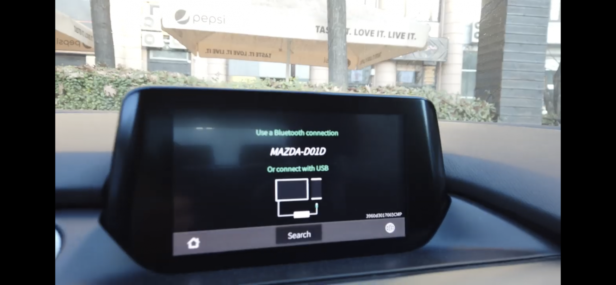

I am having the same 28 second reset/rotation that you describe, on my 2019 Mazda Miata. I have been corresponding with a Carlinkit tech-support person who is trying to determine why Mazdas are having this problem. It would help if you wrote an email (or FaceBook Message) to Carlinkit Tech Support. The more Mazdas reporting the same problem, the more likely they will reach a solution more quickly.
Hi mecutler, I was on to support through WhatsApp earlier this week, but they just suggested updating the firmware, which didn’t help.
I did find a video that someone posted elsewhere of cplay2air working on their Mazda 3. It’s not in English, so not sure what they were saying for most of it, but I did hear disconnect, though not sure if it’s random disconnects or the same issue as us took screenshots of the fw version they were on. I might try and find the fw somewhere, though it’s fairly old:
I have the same 30 seconds restart problem with my Mazda 6 in Switzerland. I have been in contact with cPlay2air support about this for several months. It has not helped me as I have only ever received standard responses. I should reset the MZD, I should turn off Bluetooth on the car, etcetera blablabla! But nothing really helps...
Initially I had problems that the adapter is recognized by the car at all, then the connection held mostly always. After each firmware update, the behavior of the adapter changed. After the last FW upgrade, the adapter is always recognized, but reboots after about 30 seconds.
But in this forum I at least realized that I am not the only Mazda driver with this problem.
Today I wrote to the cPlay support, they should remove Mazda from the compatibility list, that not more Mazda drivers fall in.
Greetings to all the troubled Mazda drivers. (To the others too of course...) 🙂
Johnny
