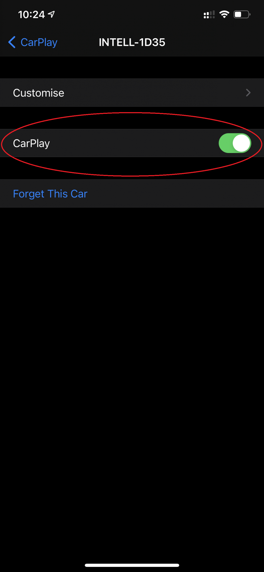

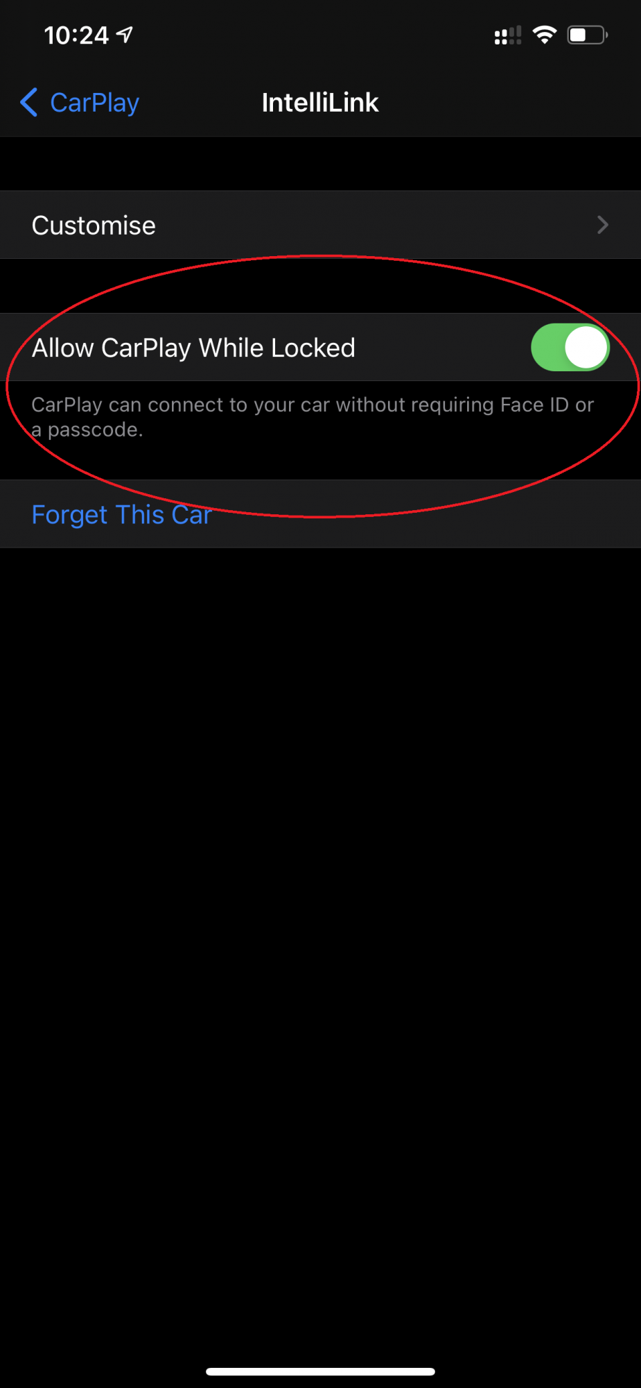

When connected to CarPlay via CPLAY2air it is gone a “Allow CarPlay while locked” setting in Settings app -> General -> CarPlay -> [CarPlay Device name]. When connected with a cable, the setting is available.
This is important for automating when connecting to CarPlay. Without this option, the automation requires confirmation when the screen is locked.
My car is a 2017 Astra K and my phone is an iPhone 11 Pro Max with iOS 14.3.
See screenshots - INTELL-1D35 connected via adapter, IntelliLink connected via cable.
I disconnected and reconnected:
1. On the iPhone, Setting>CarPlay>My Car>Forget this car.
2. On the IPhone , Settings>WiFi>{WiFi network created by headunit}>Forget This Network
3. On the headunit, go to the settings and delete the iPhone
4. I have paired my devices again.
It doesn't help, I still don't have the option to allow CarPlay when locked. Version 12.10 doesn't fix that either.
Is there any solution to the problem?
Thanks for your suggestions.

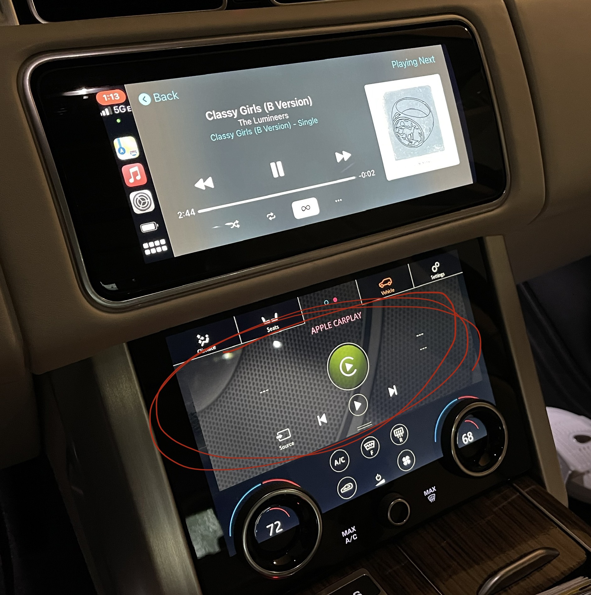

Just received the MMB (https://www.carplaymmb.com/products/mmb-wireless-apple-carplay-dongle-plus?ref=j4lnq6ddnovi) and installed in a Land Rover. Works beautifully so far... the best interface yet. Clean and very Apple-like. Plus, once setup, it boots right into CarPlay without that ugly connection screen of the CarLinkit firmware. Will try and do a comparison video since now I have 3 different types of dongles.
This one also can do screenmirroring (e.g. play YouTube). The only negative is that the "car manufactures icon" to get back to the infotainment screen is now 2 taps away. however, I setup a shortcut key on my steering wheel that breaks you out of the CarPlay quickly so that isn’t a huge issue versus the interface improvements.

Interesting - does it have any settings on a web browser like the carlinkit? Wondering if this is a polished version of the carlinkit firmware or a completely different product.
There is a ton of stuff this device does... haven't had much time to play with it all... between mtgs today, I have gone into the garage to play with it... the interface is perfect in every way... I cannot tell the difference between wired and wireless (so far). However, on my particular vehicle I'm not getting the metadata on all the other screens in the vehicle. I have just emailed them to see if they have plans to fix this (this works in Carlinkit)

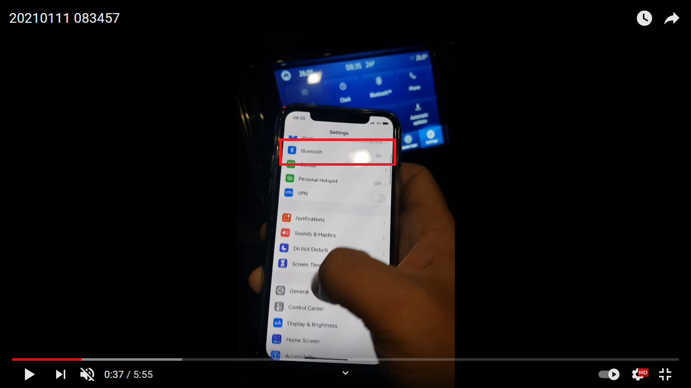

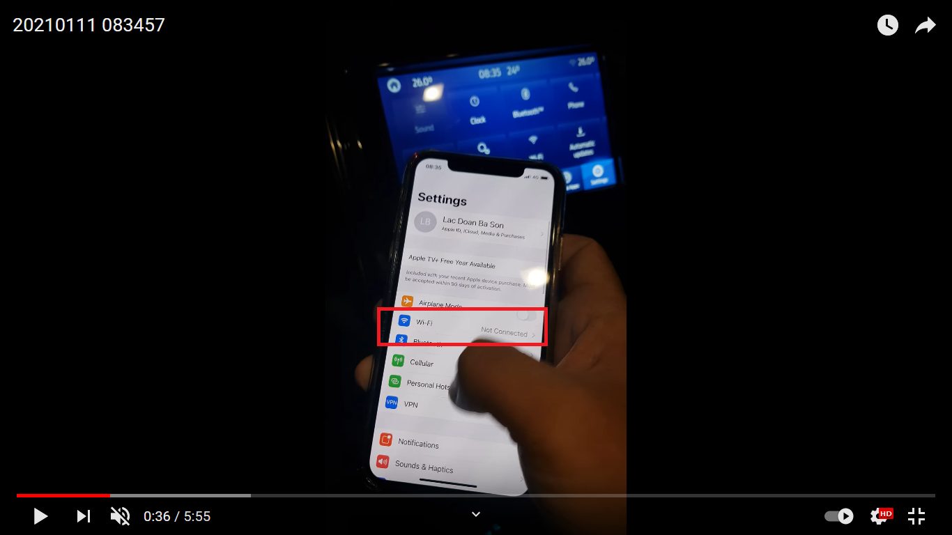

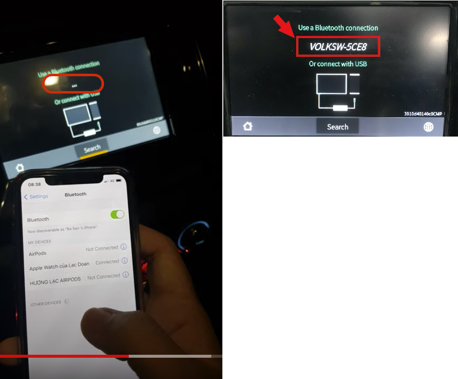

Hi, I'm Ford Everest 2019 user in VietNam.
Car : Ford Everest 2019 in VietNam
Car OS : Sync 3, Ver 3.4, Build 20196
Wireless Adapter : CPlay2Air
iPhone : Xs with iOS 14.2
my problem in this video
CPlay2Air Error
Has anyone solved the problem with Ford Sync 3 ?
I appriciate your advice.

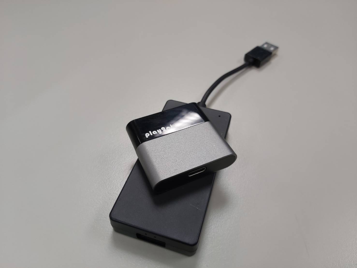

Took my friend's carlinkit adapter and compare it with mine, the look is a lot different! I don't think they are using the same hardware solution (code should be different too...) Play2Air has a type c connector. I have tried to open up the unit...but don't find any screws.... don't want to break it!

yes. both are turned on. but i can't find anything. no bluetooth host name and wifi.
Checked with my friend he said you should see you car name on the setup screen, if not the unit is not communicating with SYNC3, possibly firmware issue. Have you checked with the seller?
