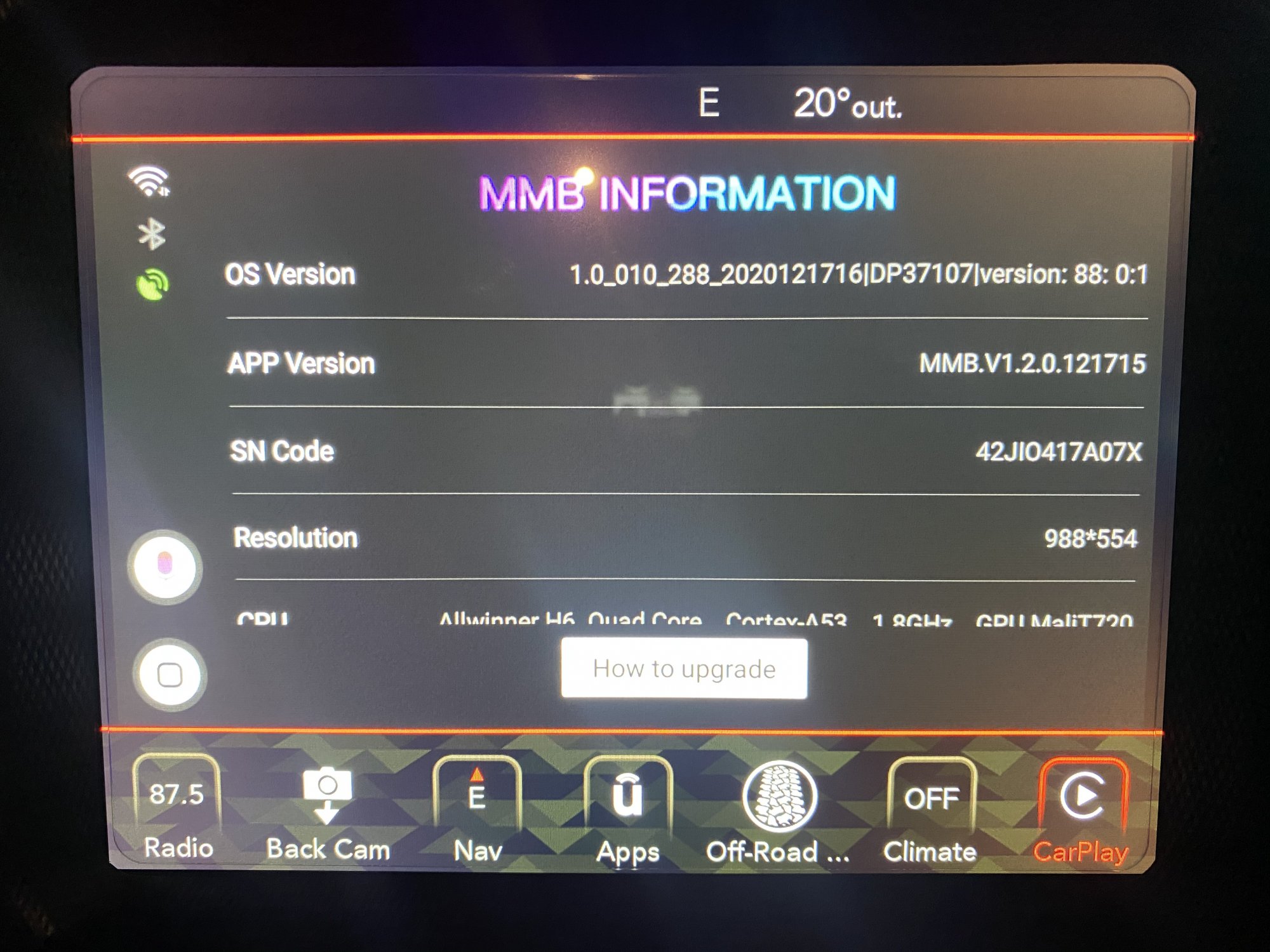

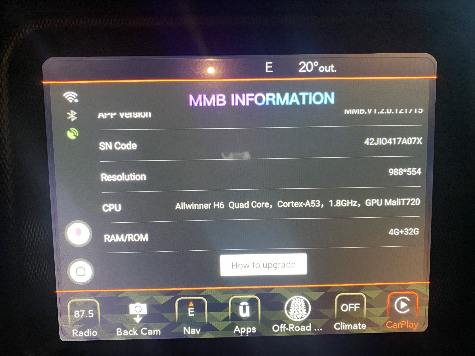

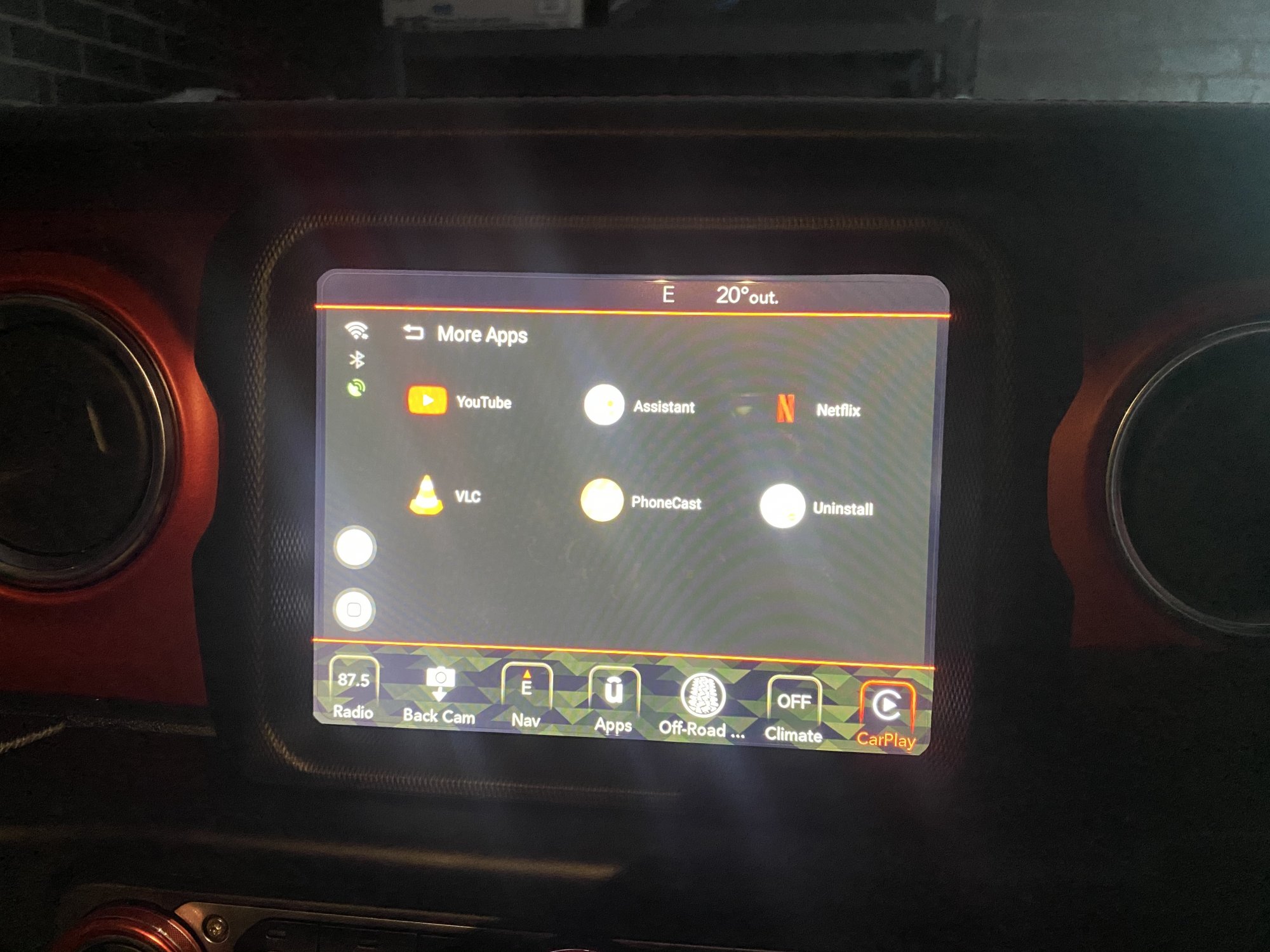

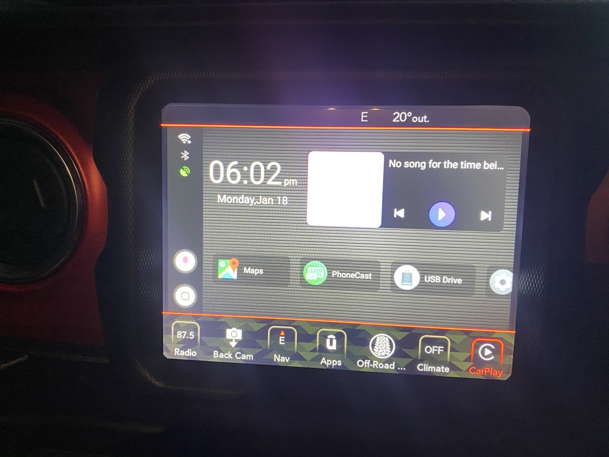

Just received the MMB (https://www.carplaymmb.com/products/mmb-wireless-apple-carplay-dongle-plus?ref=j4lnq6ddnovi) and installed in a Land Rover. Works beautifully so far... the best interface yet. Clean and very Apple-like. Plus, once setup, it boots right into CarPlay without that ugly connection screen of the CarLinkit firmware.

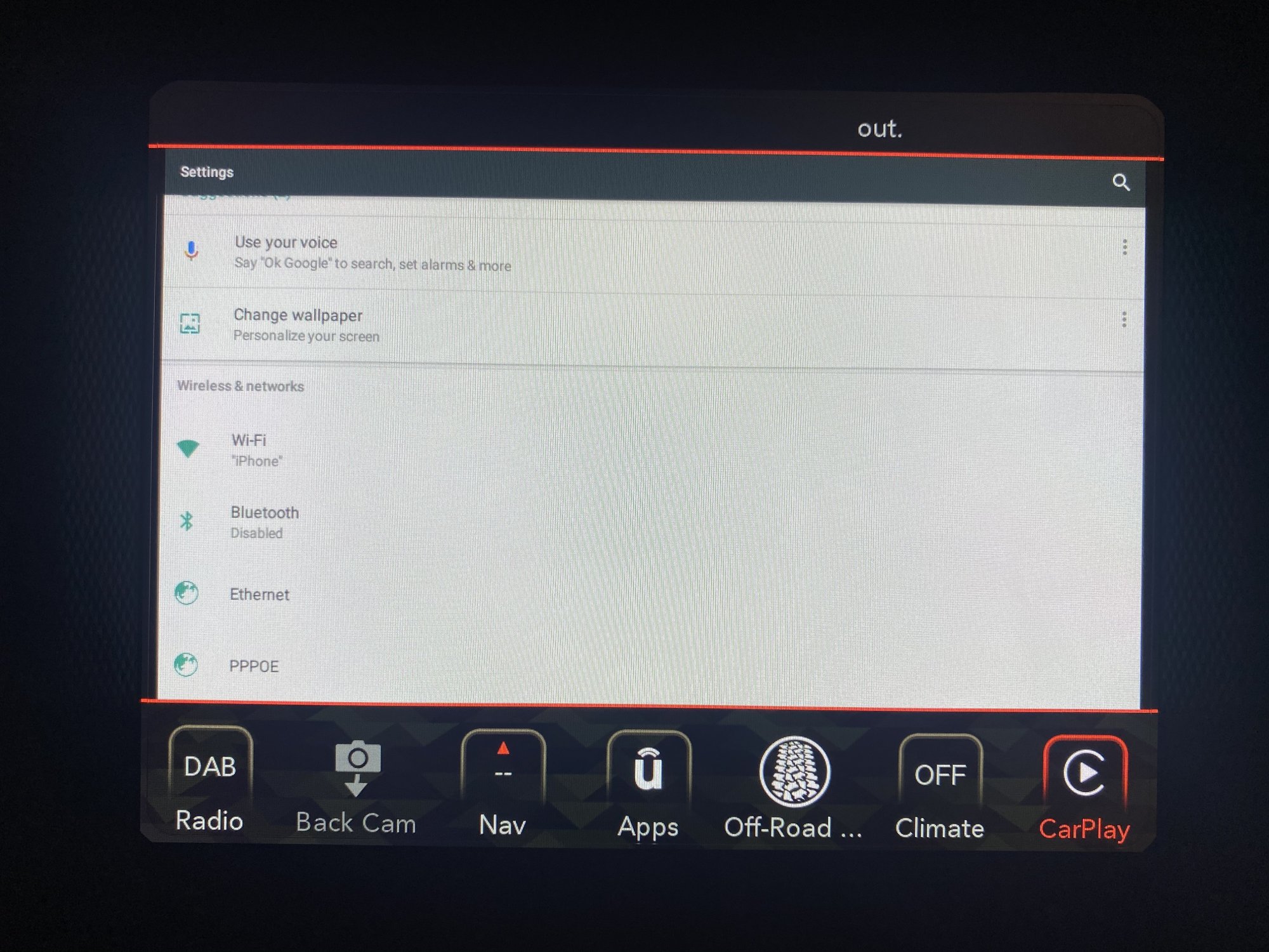

This one also can do screenmirroring (e.g. play YouTube). The only negative is that the "car manufactures icon" to get back to the infotainment screen is now 2 taps away. however, I setup a shortcut key on my steering wheel that breaks you out of the CarPlay quickly so that isn’t a huge issue versus the interface improvements.
Hello everybody, especially all the Mazda drivers with the first generation headunit of the mzd connect. I also suffered from the 30 seconds reboot problem with the carlinkit 2.0 adapter. After flashing many firmwares hoping to get better results my bluetooth connection bricked. The wired connection was still working but therefore nobody needs this dongle.
Today I recieved my variant of the MMB/Joyeauto CarPlay Dongle and can confirm that it also works flawlessly in my Mazda CX-5 from 2018!
Mavro gave a good summary. In addtion to that you will still be able to switch between Carplay and the regular infotainment with a long press on the physical home button near the knob (like before).
Boot time is not instant but I would say its on par with the carlinkit adapters (I guess 15-20 seconds). Without the in-between screen it really doesn't bother me.
There seems to be a very slight delay (visible lag) when you rotate the knob to switch apps or pages (sliding anmiation). But for me it looks like the same lag when using the regular infotainment. So maybe it has nothing to with the dongle itself. The touchscreen works perfectly, too.
One thing I have to find out: If there is an easy way to switch seamlessly between screen mirroring (personal hotspot) and carplay (bt & wifi).
If someone would like more information, feel free to contact me. I'm not sure about the forum rules, that's why I wont advertise my reseller but there is some price disparity for this device on aliexpress ("carplay media box", 1GB Ram, 8 GB Rom)

Just received the MMB (https://www.carplaymmb.com/products/mmb-wireless-apple-carplay-dongle-plus?ref=j4lnq6ddnovi) and installed in a Land Rover. Works beautifully so far... the best interface yet. Clean and very Apple-like. Plus, once setup, it boots right into CarPlay without that ugly connection screen of the CarLinkit firmware. Will try and do a comparison video since now I have 3 different types of dongles.

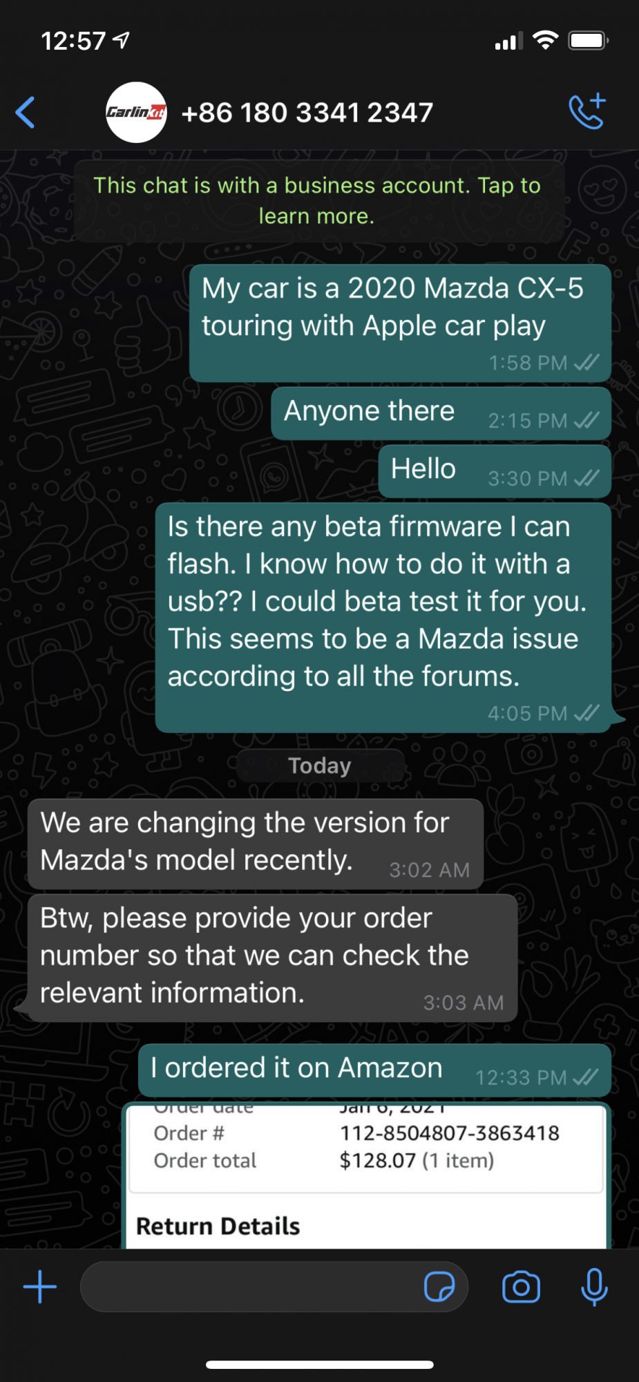

Ok still have the problem. I’m on FU2. If the next update from Carlinkit does not solve the problem, I will contact the support.

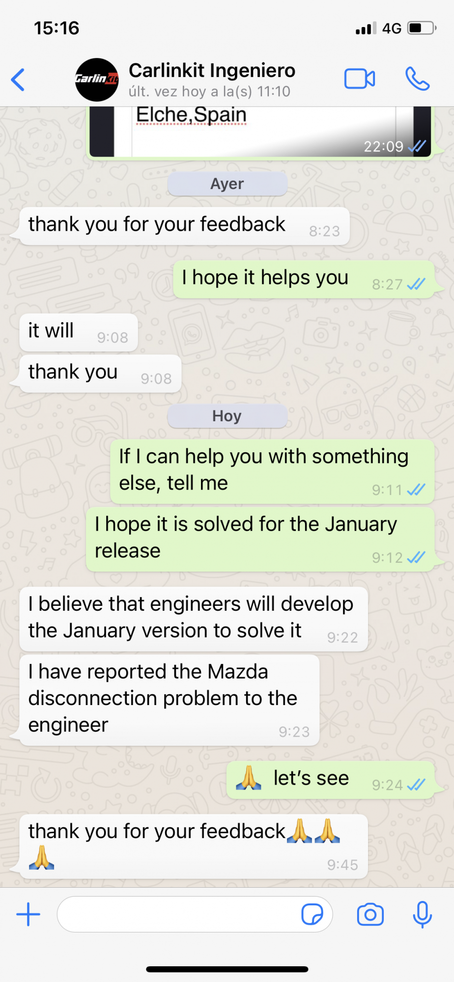

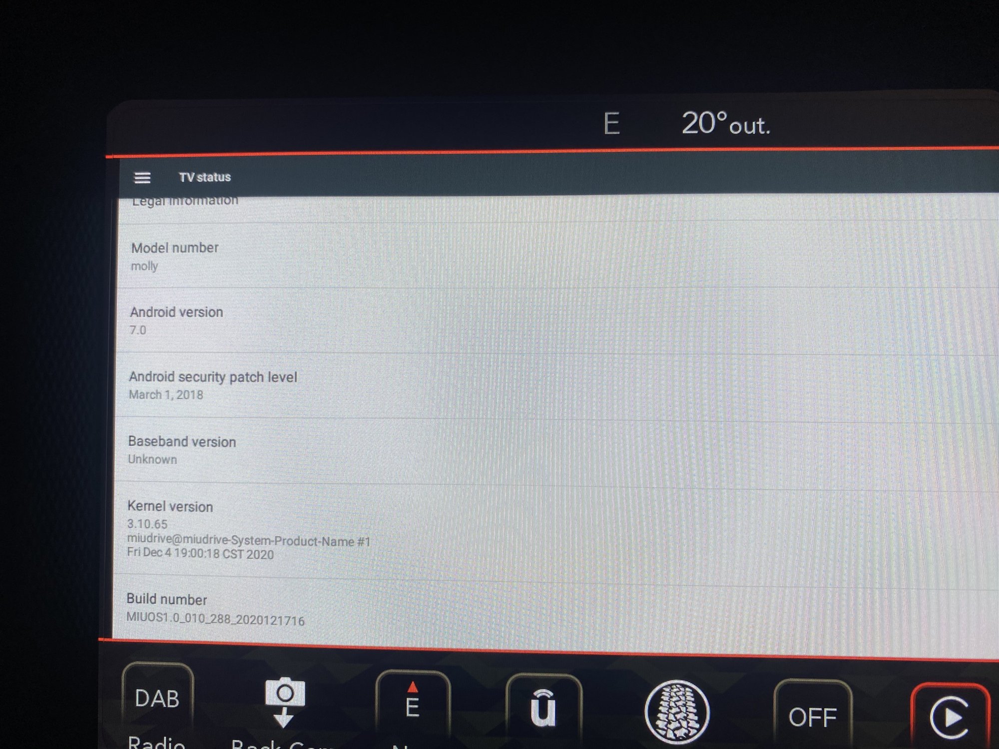

Edit: newest firmware (Ver.201225) should fix the issue (link from videojochen, it's joyeauto firmware, so likely with different bootanimation). Did not test it yet. File isn't recognized. Waiting for update manual from seller. Probably just have to rename the update file. That was the point when switching between carlinkit (U2W) and joyeauto (U2W_ZYD) software.

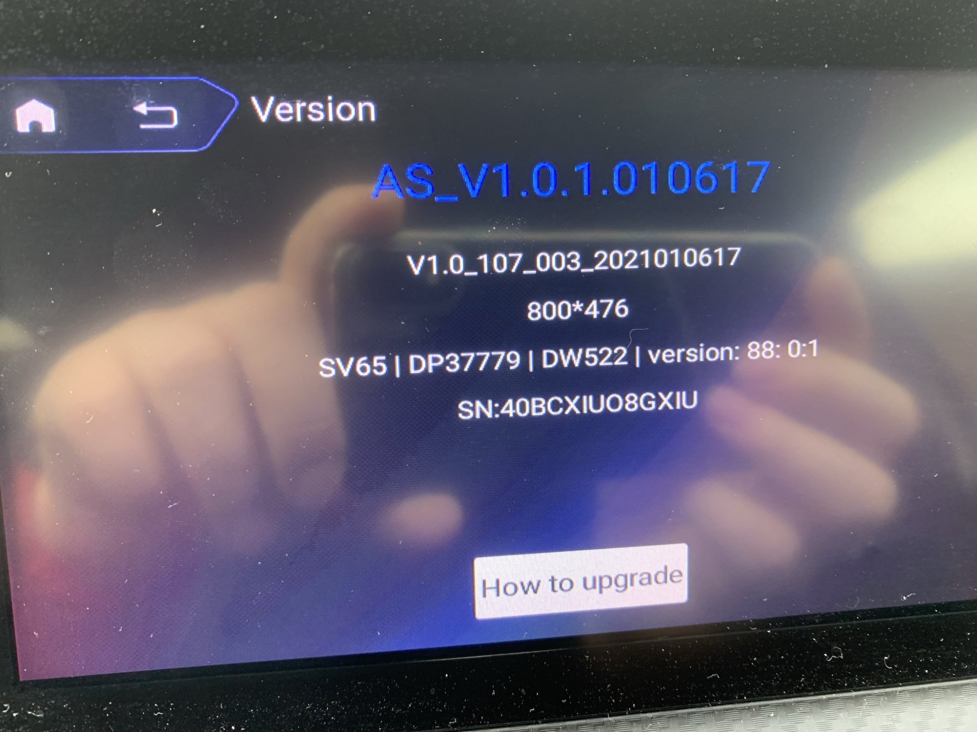

Update:
Seller send me a new firmware (Ver.210106) as a zip file (#5173 reveal the full image). Can confirm that there is a small difference in system_version.ini within the update .zip (CP-21 = ABUPDATE_FOTA_DEVICE=107_mj_abr_ty; MMB = ABUPDATE_FOTA_DEVICE=107_mj_abr_zyd). This time I won't experiment with "cross flashing" the device because the adapter is working fine and I have no connection issues. Though chances are high that you can switch to joyeauto or stock firmware if you swap the *.ini files.
Will report back, when firmware update was successful. Update was successful (kept motor running, just to prevent powerloss). Lag and audio delay almost nonexistent (see #5183). New setting: Powermode for CarPlay which increases snappiness but then requieres additional reboot to get back to the dongle ui.

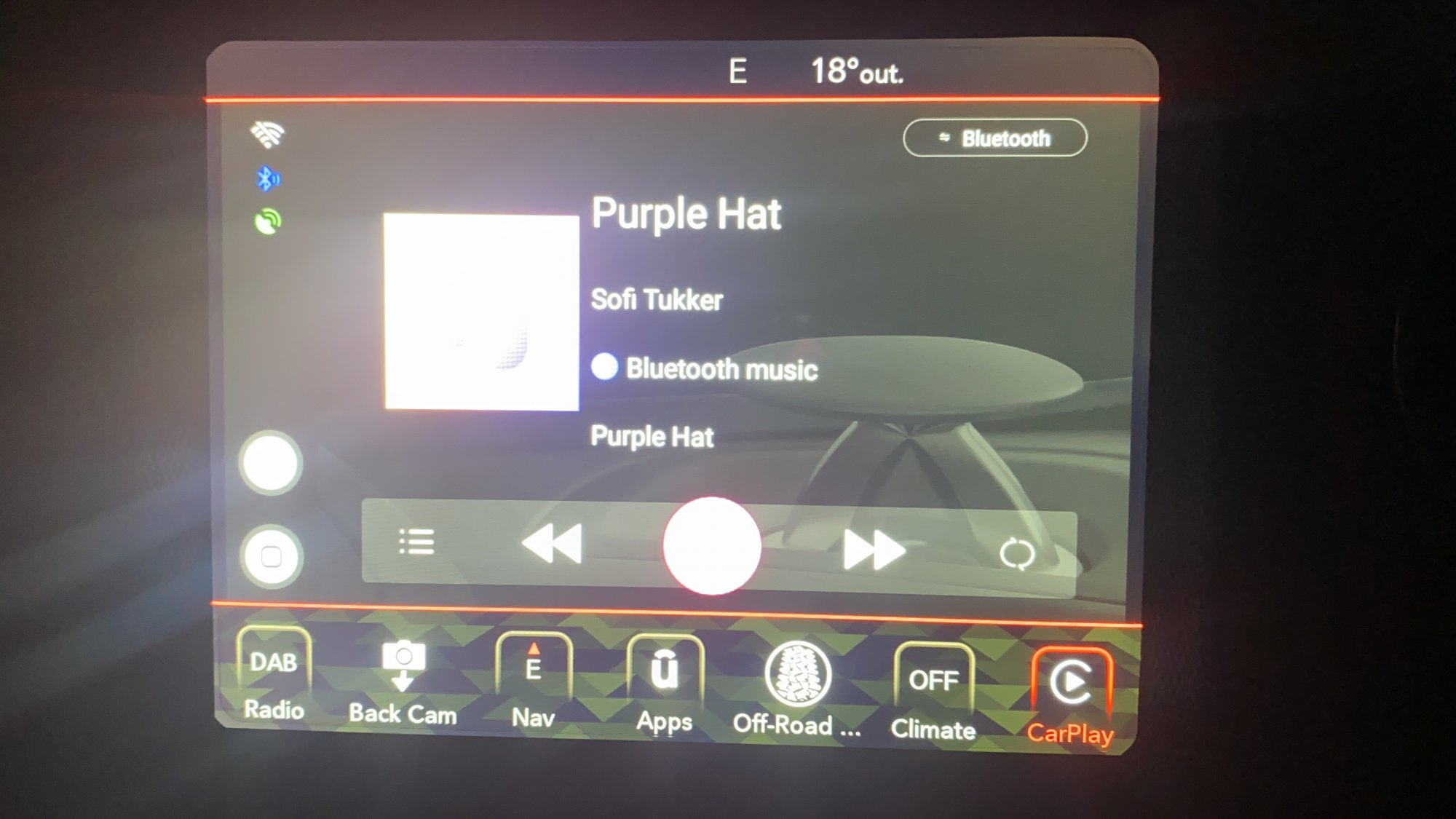

Unfortunately no changes in terms of switching between AirPlay/PhoneCast and CarPlay with my Mazda MZD Connect. At least one reboot when starting carplay form dongle ui. (about 20sec. / after cold start the whole infotainment takes about 40sec. to display wireless CarPlay).

Just Received the MMB Android CarPlay adapter. Works really well on my Jeep Wrangler Uconnect.
only problem I see so far that they have disabled the Bluetooth hardware on the dongle...can’t connect my Bluetooth OBD adapter.
hoping this being a full blown android (7.0) someone might create a new firmware to add additional functions and activate the Bluetooth Hardware.

I own a cx-5 mazda of 2018, I also have reboot every 30 seconds. I'm new here, but I read a firmware made by Vlud is the answer? Can someone tell me which firmware this is and where I can find this one. Thanks in advance!
Greetings from a lockdowned Holland

the carplay adapter has inside a boot button to recovery flash system.img
the adapter name inside : ddbox107 MB vers 1.10 with allwinner h6 chipset with 1gb ram and 8gb rom
upload: flashtool and recovery.img from 06.01.2021 (Factory AS ) audiosource
1. install flashtool, 2. load h6 system.img 3. press and hold the boot button inside, 4. insert usb kabel and press flash file up to 100%
There is not a firmware that works properly with mazda, we are waiting for Carlinkit to release a new one
