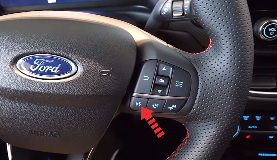

have you tried activating Siri using the steering wheel Voice Command button - if your vehicle has one?

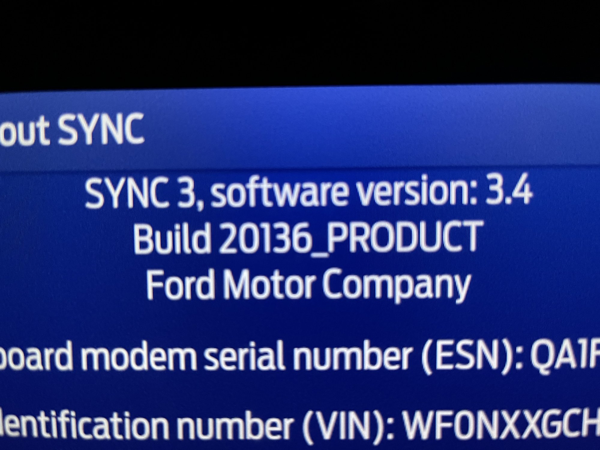

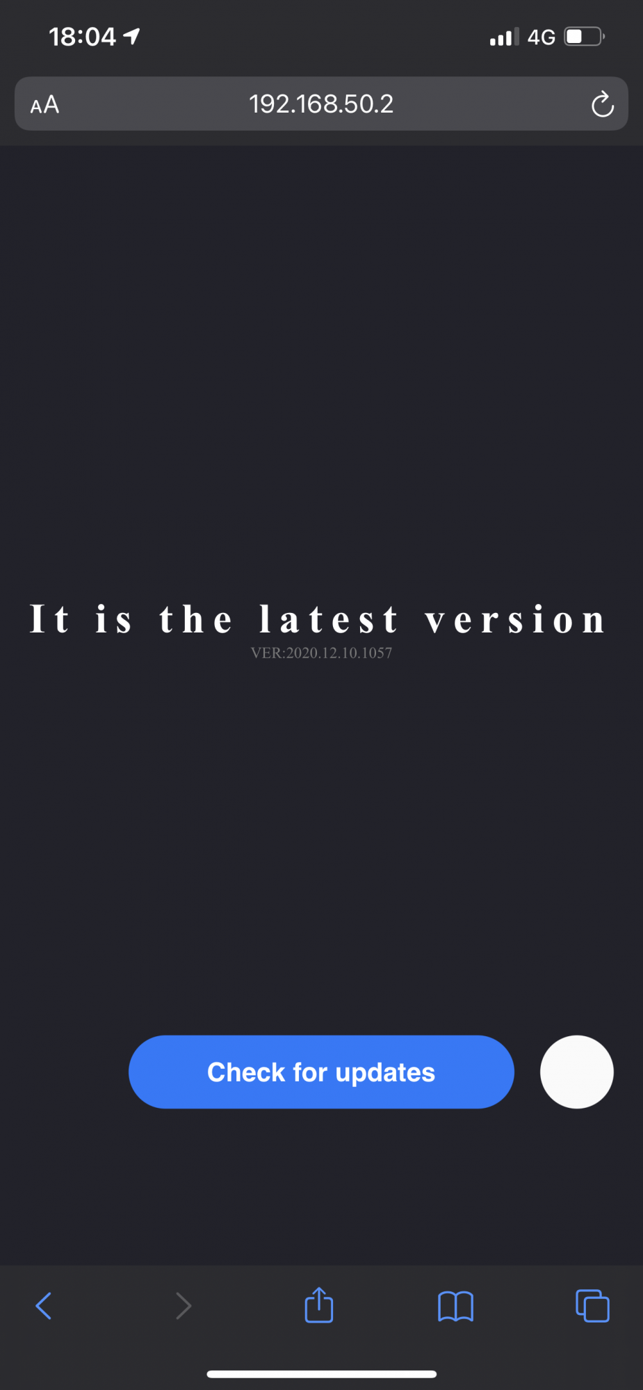

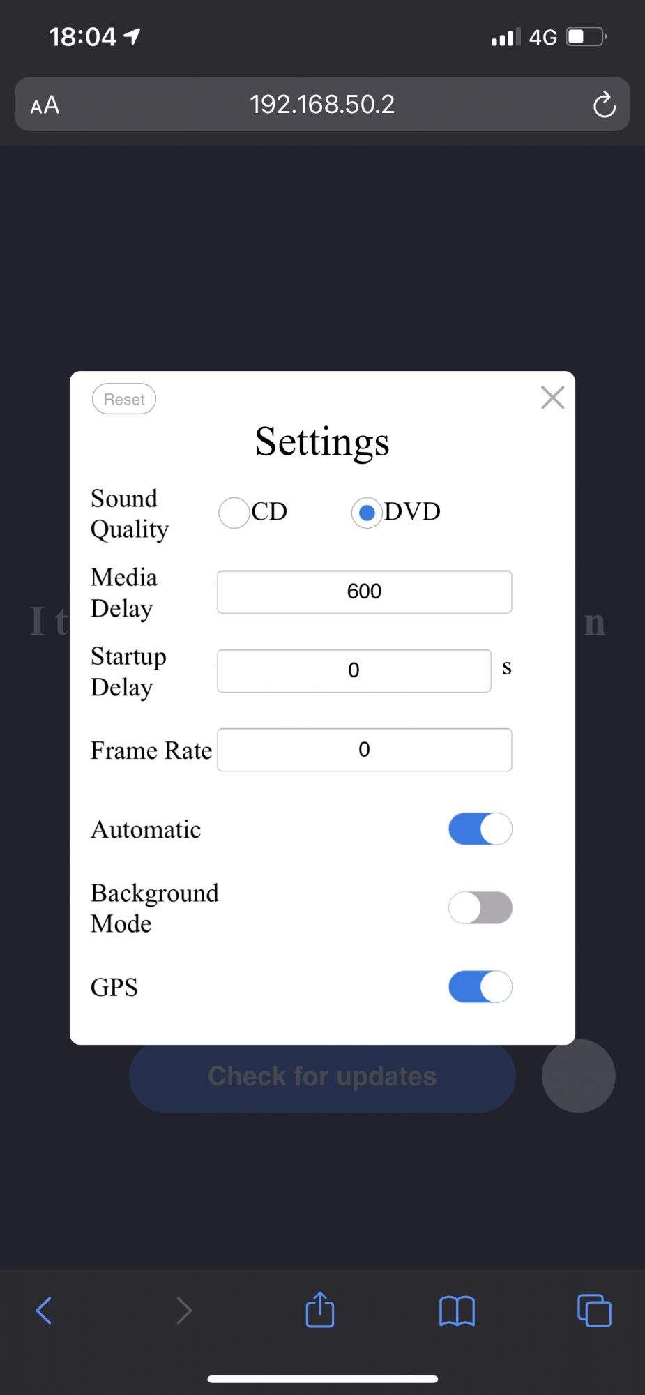

I just went to try this in my Ford (UK focus) but also running sync 3.4 and it seems to be working ok for me - can activate Siri through the steering wheel button play music send messages etc Ok. I have a USB carlinkit 2.0 on 2020.12.10 - attached some screenshots of settings and sync build too incase that makes a difference!
