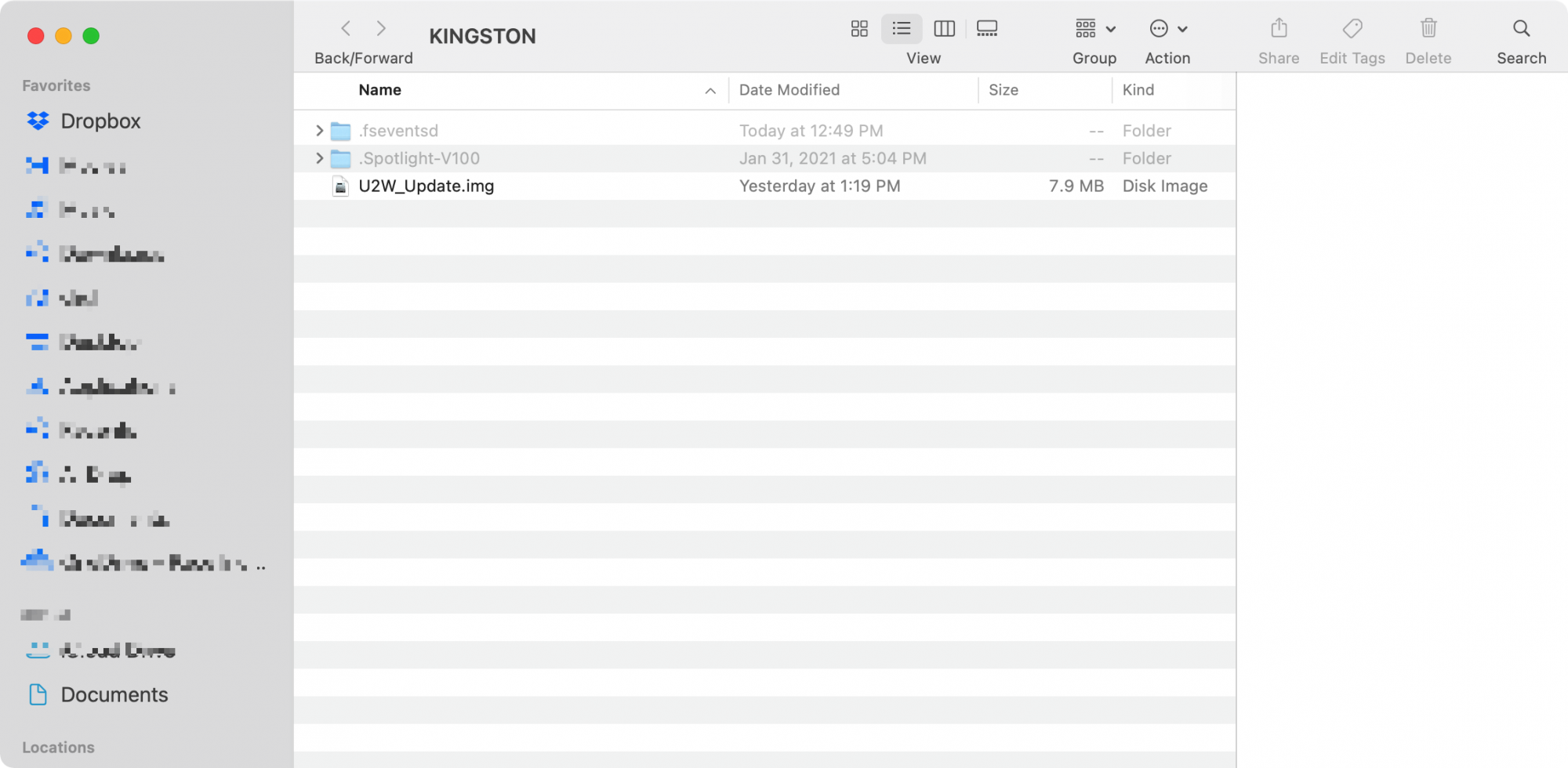

I can't get any firmware to load using USB - the USB drive is formatted FAT32, the file is named U2W_Update.img, but when I plug the drive into the Carlinkit while it's powered by a wall charger, nothing happens. Is there some trick to it I'm missing? Is it because I'm using a MAC?
Mac leaves some index files on with same name so can be problematic yes. I ended up finding a windows PC and did it on there to make sure.
If you look at files from a Mac on windows you’ll see them.
I think there is a tools if you look on here that formatted properly for a Mac, but just easier on windows

Shift, command and . show hidden files on Mac for delete. I never had a problem making usb update with MacOS.
I'm on a Mac and and the USB upgrade worked without issue. I done it twice. I used Disk Utility to formate my USB. Double check the file name and make sure no space added when you rename it to "U2W_Update.img". Mine has hidden files and no issue. screenshot_467.png
