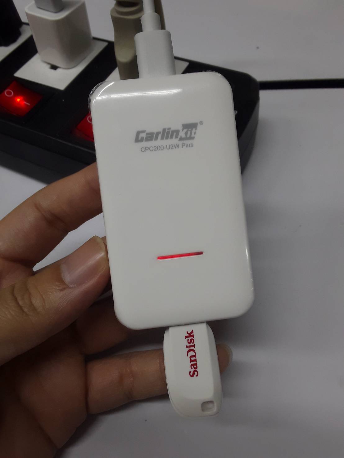

I can't get any firmware to load using USB - the USB drive is formatted FAT32, the file is named U2W_Update.img, but when I plug the drive into the Carlinkit while it's powered by a wall charger, nothing happens. Is there some trick to it I'm missing? Is it because I'm using a MAC?
Not all USB sticks are equal, I had to try 7 different ones to get it to work. 8 or 16GB USB2 drives seem the favourites to work

Try different USB sticks, not all are equal. I had to try 8 different ones to find one which worked. The one I settle on was an old 16GB stick
I changed a few USBs, it still does not respond.

Correct format? Done on a windows PC or Mac? Be careful with Mac as leaves other hidden files.
Best USB seem to be old small Gb version’s. As above may have to keep trying others until find one that works.
Power up dongle first, wait a minute then plug in USB and see if that works.
PC

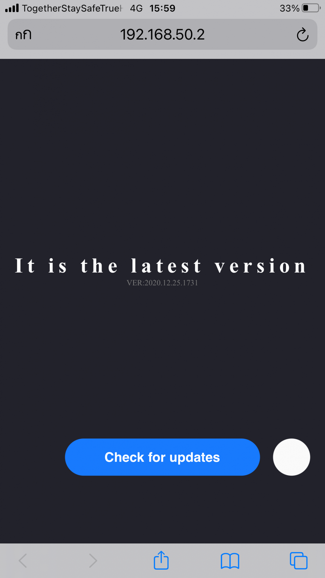

Version that comes with the device
Try to plug the dongle to your wall charger without the usb stick first. Wait till the dongle shows red light before you plugging the usb in. My dongle did nothing when I plug it to the wall charge with the usb already plugged in.
Hope it helps 🙂
Hope it helps 🙂
I can't try it.
I don't know what to do next.

I actually think the installed version (2020.12.25.1731) may be the issue - it's the same version I have, and I can't install via USB either despite trying several USB sticks, formatting and trying different versions of the update. The other problem is that I can't update to the newest version via OTA either because that version is corrupt and isn't the right size. I've resigned myself to waiting until the next version of the OTA update comes out and hope that works.
ok,thanks
