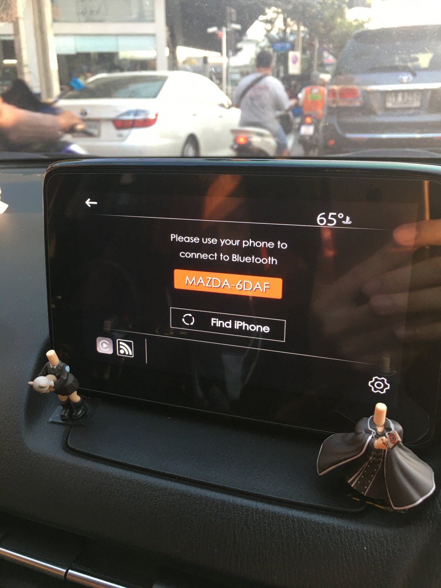

UI,Something that cannot update via USB

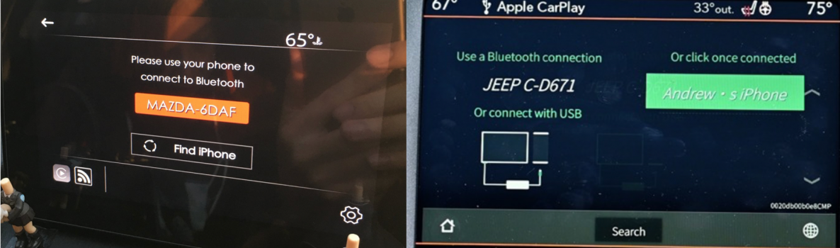

@zthepeetz Interesting... looks completely different than mine... how did you get yours (left) to not look like the default UI (right)?

UI is part of the firmware. Interesting that it’s changed. Could be a similar issue to the JoyeAuto firmware problem? Maybe it’s looking for a different filename (something other than u2w_update.img)?

So you both have the same 2020.12.25.1731 firmware with that ui? You might have a special build that hasn’t been publicly released… the last public dec build was 2020.12.10.1057….then it went to Jan 2021.

I prefer your ui than the one I have… so hopefully this is a preview of things to come… seems like that firmware was installed on accident… Have you tried reporting it via the built in webpage report form? Apparently that goes to the developers…

@whatgift -- so the UI is part of the hardware not the software image? that's a bummer. How long ago did you get your device? Do you have the same one as @zthepeetz
I don’t think it’s because the hardware is different, but that’s what I was thinking because it seems more than coincidence that our different UI seems to be having update issues.
