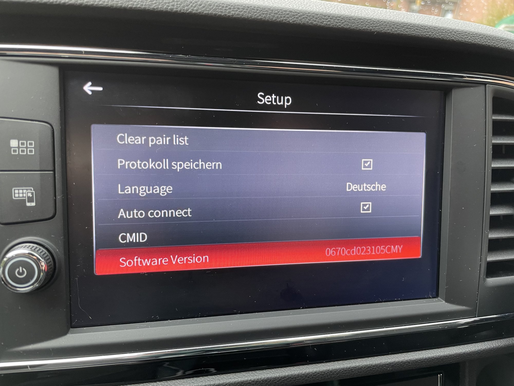

If leave the connecting screen on, and press settings it shows a few bits. I’ve unticked “save log” as heard uses some memory in case, hope that’s ok.

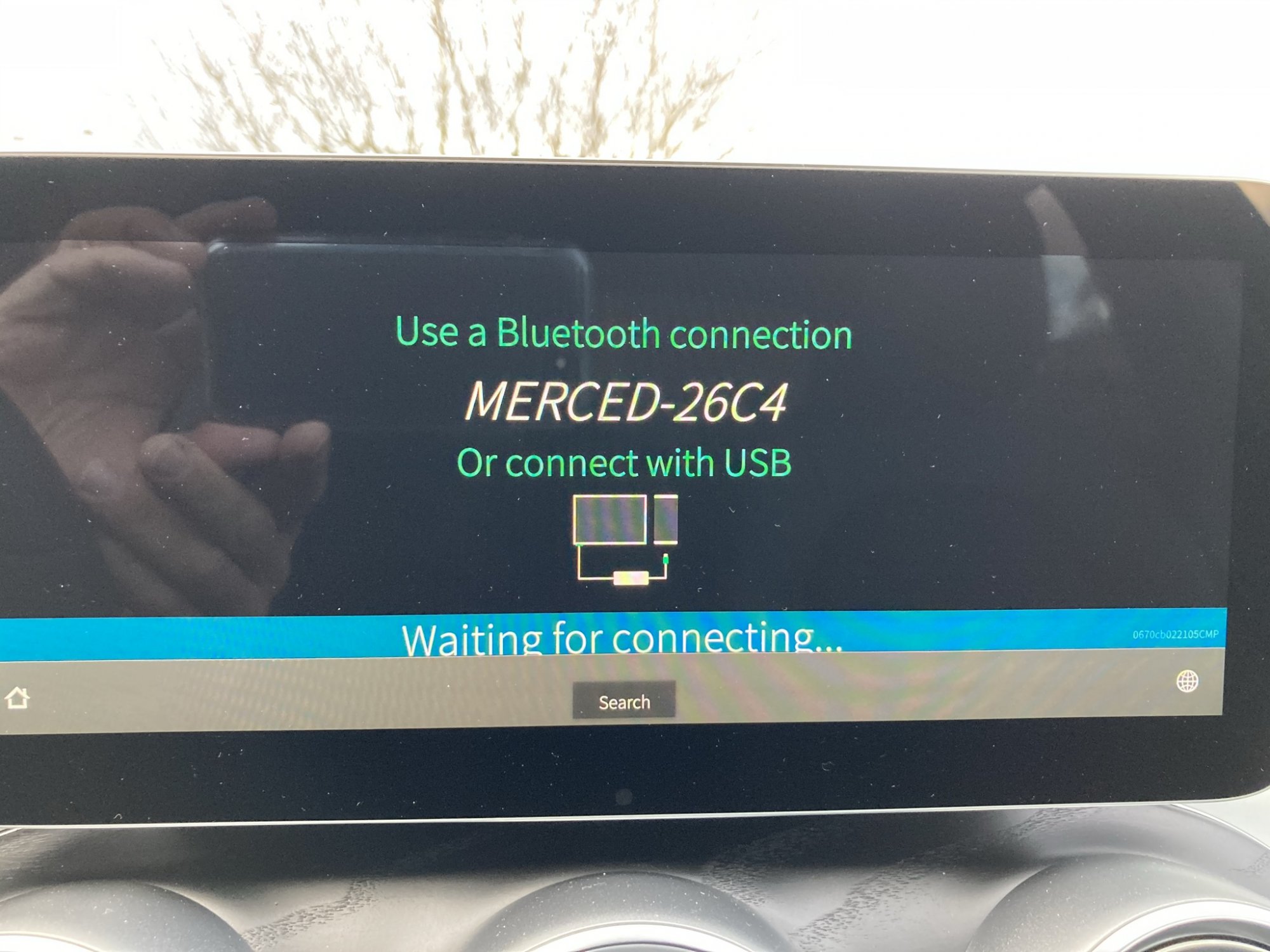

Screenshot - no different from my CarlinkIt 2.0 except that I run that in background mode so startup and entry into CarPlay is cleaner.
Strange. Here’s mine below. This was the £20 Amazon UK one. OTA of same version 2021-03-06 as well.

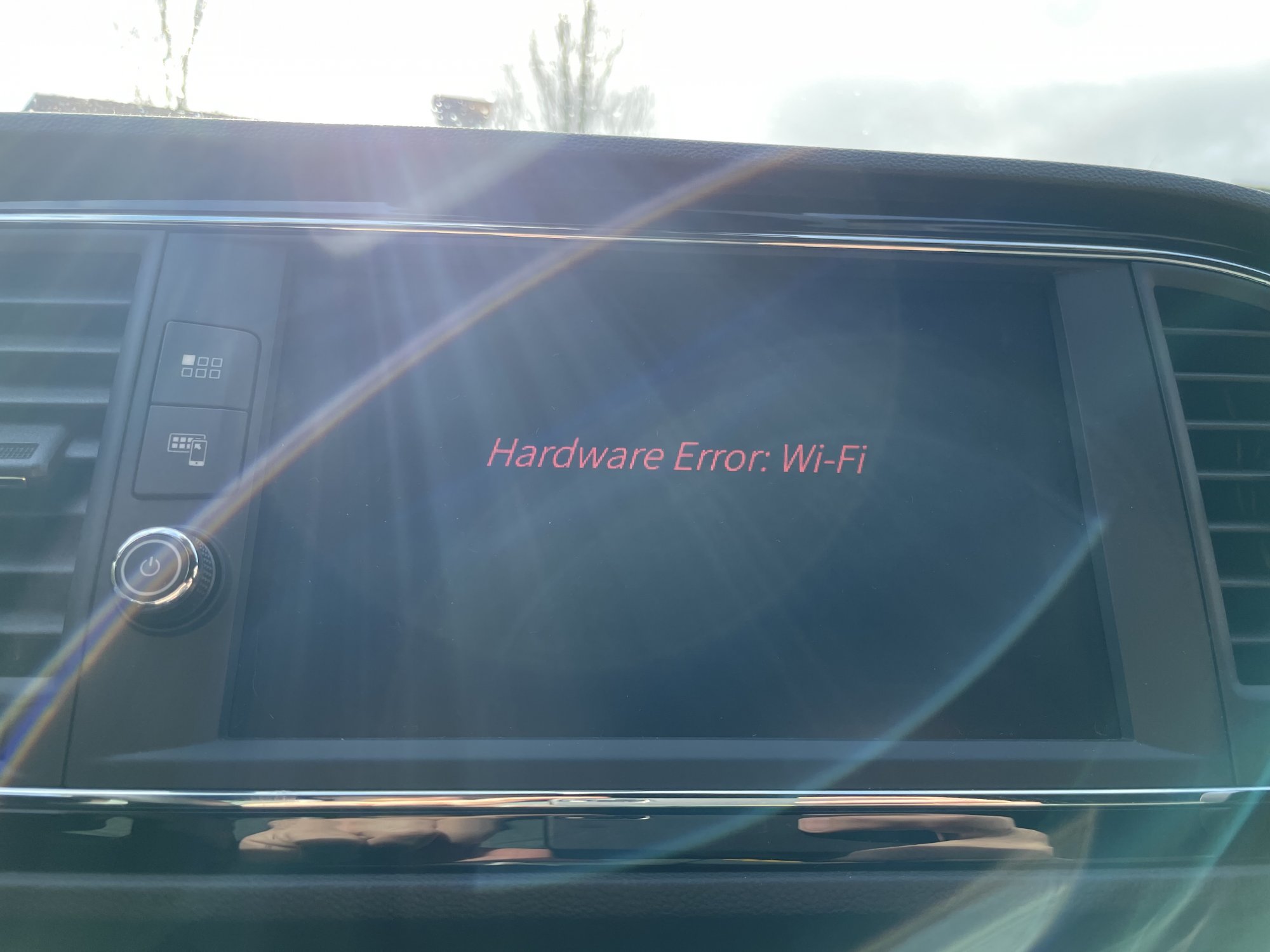

I just tried to upgrade my 2.0 to the newest firmware OTA. At the end there was an error "Update failed". Now I have a screen "Hardware Error: Wifi". Unfortunately the device recognizes no plugged in USD Drives. I tried different ones, but even before the upgrade there was no possibility to upgrade via USB.
Can someone help me with that?

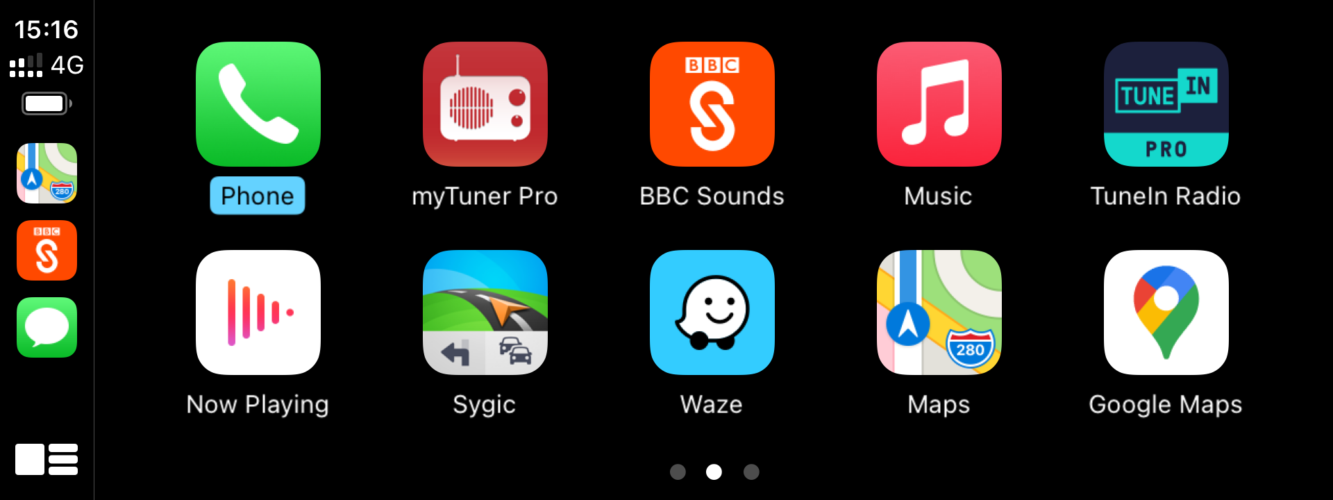

You get it full screen on your Mercedes? mbux?
NTG5.5 in a new C Class - new as in manufactured December 2020. The online Owners Manual would have me believe that it should be running MBUX, but it definitely is classic COMAND. Yes, full screen width on 10.25 inch display, giving five icons wide in the CarPlay display. Here is a previous example:
Have you ensured that your USB drive is formatted FAT32?
Maybe your filesystem on the device is corrupted?
@VLud on this forum maintains the customised version of the firmware and has detailed knowledge of the filesystem setup; hopefully he or someone can advise on how to recover the device.
Reactions: Kevbert
Got it to start up with cable connected in Car. But when I plug off the cable there is the problem with WiFi screen. Seems to be WiFi-corrupted.
i think would i be able to re-flash via USB it should be back. But the sticks are not accepted. Actually I’m on the screen for „Connection“ and connected via Bluetooth. The IP Adress is only available via Wifi 🤔
I had not realised that your device is not completely bricked. Just a thought: some people have problems with updating and clearing the web browser cache before connecting over wifi always helps. Worth a try to clear your cache, reconnect and try again to update?
Nice thought. Problem is that the Update Page is only available via WiFi and the Module quit working with WiFi, so I am unable to connect to it 😀
The best way would be by USB. Don’t know why none of my drives will be accepted. 3 Drives, 3 different sizes. Tried via macOS and Windows. The Device didn’t recognize them.
