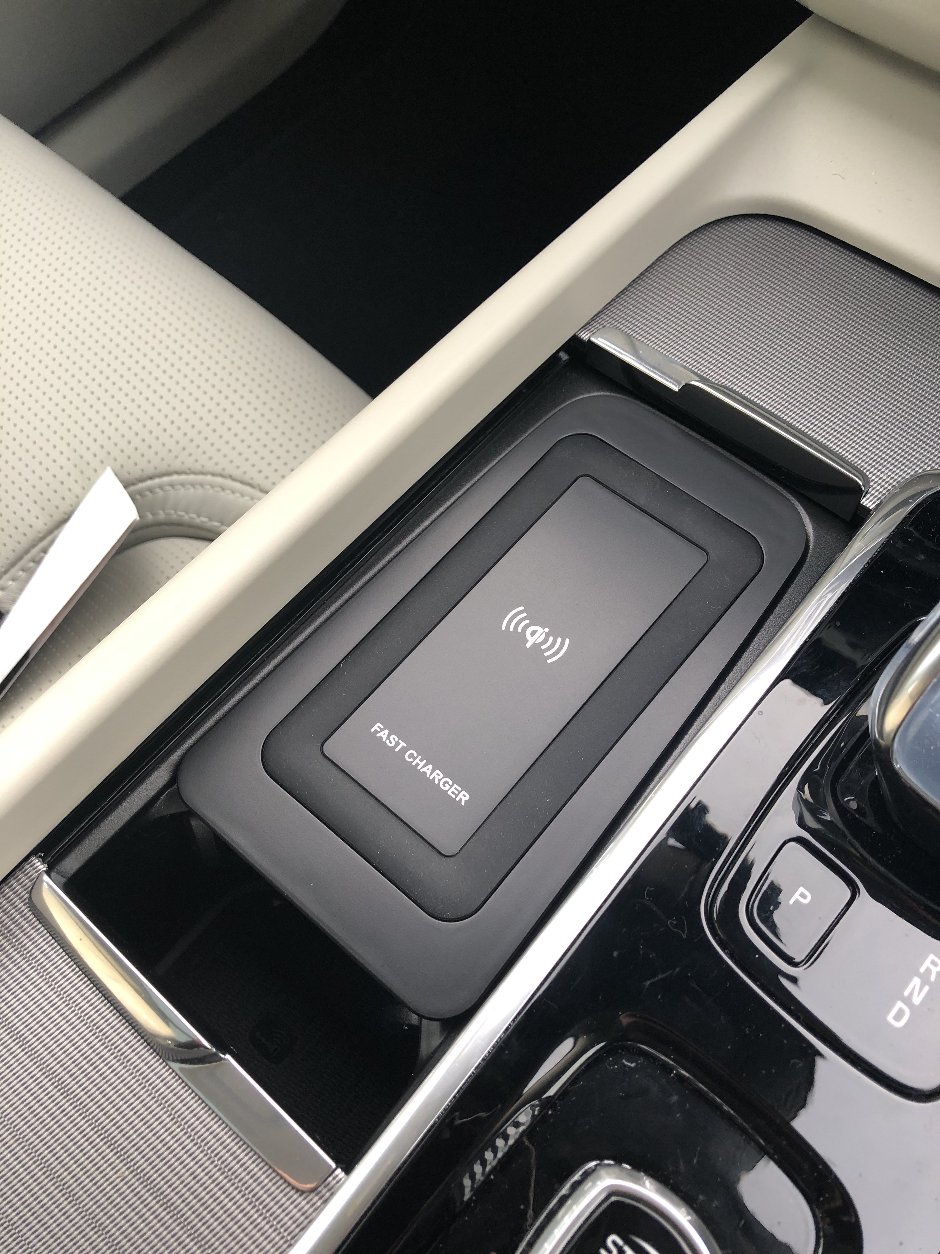

I'm designing a holder (to be 3D printed) that's similar to the Brodit (slide in) but will place a wireless charging pad on the back. To be mounted on the side of the central console or inside a cup holder. But this is for when I get my CarPlay2Air working!!!
Just get the one already made from Ali express or one of the magnetic QI mounts from amazon
