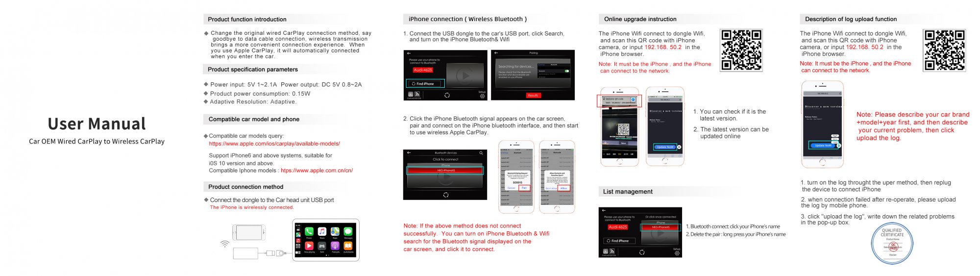

For those who don't know, their email address is sales@carlinkit.com, and the method to upload logs is to connect to 192.168.50.2 from your phone while connected to CarPlay. If you want to be even more effective (keep in mind there is a language barrier at play here), take a video using another iPhone/iPad/whatever showing you pressing the steering wheel button and the resulting crash.
