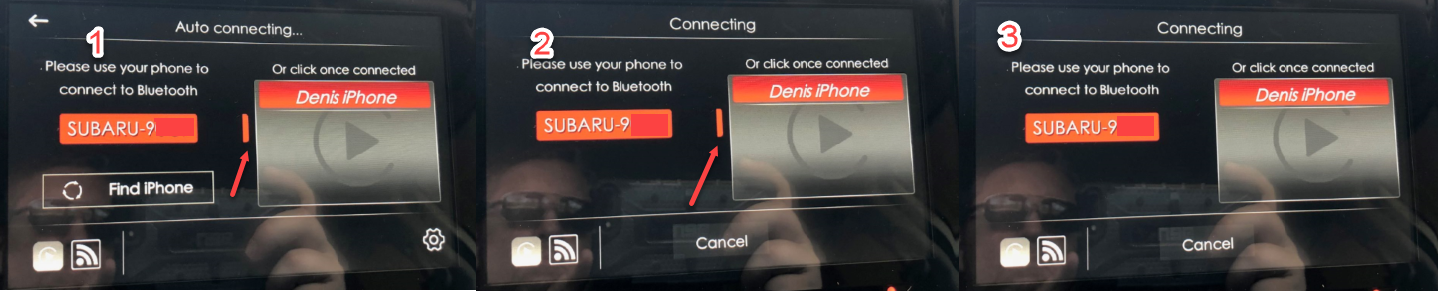

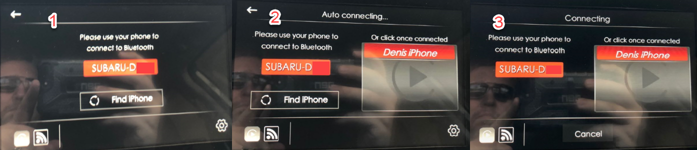

So I played with it some more. Long presses do nothing and it doesn’t respond to anything for the few seconds it is on that screen.
I did try plugging in wired to the box. It goes to the connecting screen but never connects. Left it on for a few minutes. If I hit cancel, it goes back to the screen where I can add and delete phones. It does not delete phones no matter how many times I click delete through the long press. I cannot try to connect to phones either by pressing once on them. I cannot search for new phones, doesn’t pull any up. I can add new phones through wired, but they don’t work either. Once they are added, they cannot be deleted. I can change language.
since it never connects, it won’t load 192.168.50.2

@DamEngineer (and @Kevbert ) I would like to call this progress, of a sort - at least you have the basic screen. Maybe someone here can offer further advice if you post your version number that is displayed on the screen, and identify your car.

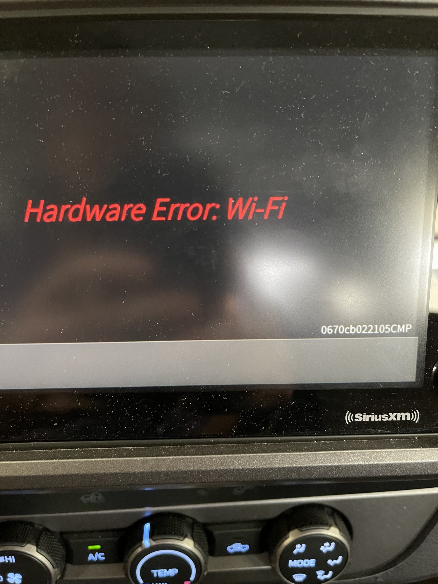

2020 Tacoma
FWIW I heard back from Carlinkit support and they referred me to some other support email address that’s @qq.com since I got it from Amazon. Spoiler alert, I had emailed that address about two weeks ago and never heard back. Safe to say we’re on our own here @CarlinKit obviously doesn’t care after the sale.

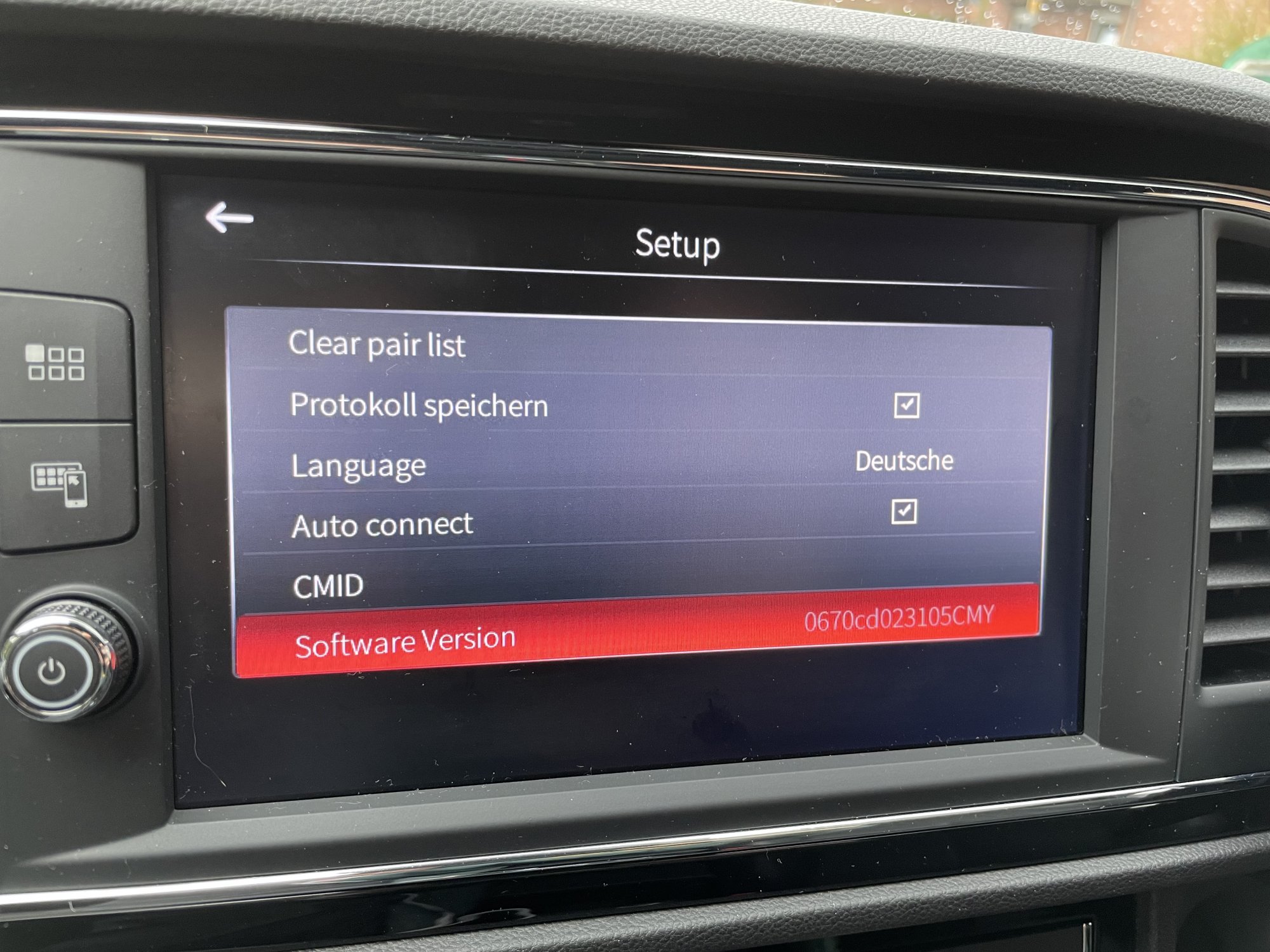

My screen is the following (Seat Leon 5F with MIB2STD Unit.
@DamEngineer Is your dongle even not recognizing any usb stick? Did you tried that already? Sorry if I missed it in this thread.
I tried a few USB sticks, none of them worked either. I’m not sure if I am doing correctly or if my USB sticks will work. I am using Rufus on windows to put them into fat32. What’s the correct file name for the original carplay2air? I tried all of them with no success, just a solid red light.
how do you get to that setup screen?
