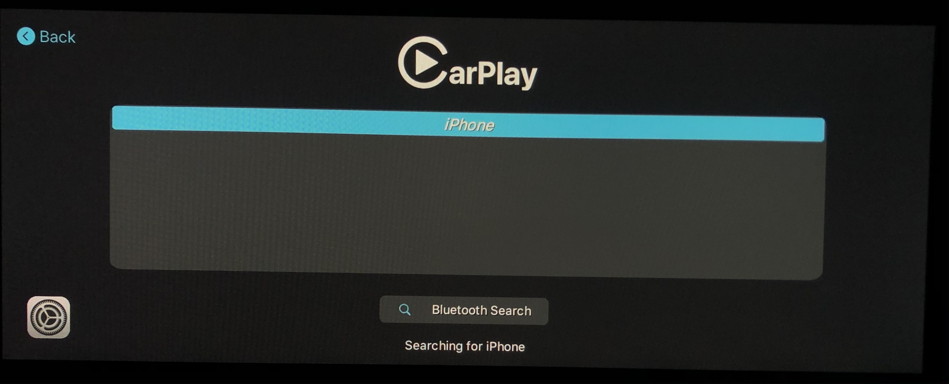

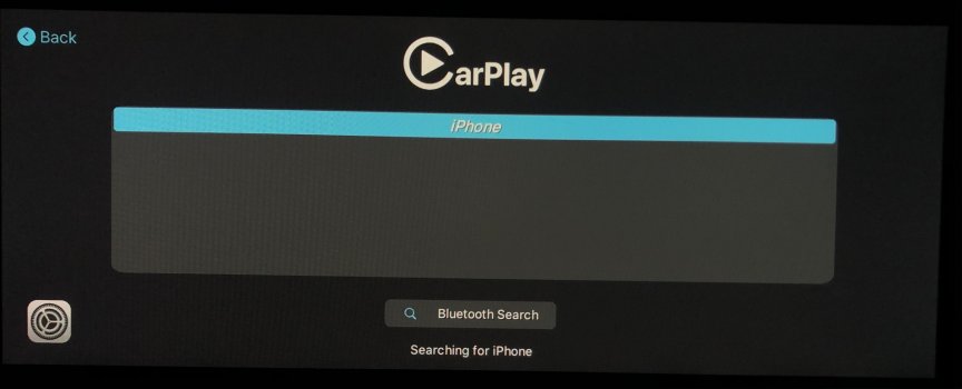

From my side I can say that the device is not sending any WiFi. Bluetooth I can see and connect with but it isn’t changing anything.
Will charge my iPad and check if there’s any WiFi with another device, but I don’t think so.
Maybe this is also useful. I recorded two short clips for the seller (he wanted me to to that to send it to the engineers).
Clip 1
Clip 2
I almost tried every constellation, there is no possibility to reanimate...
