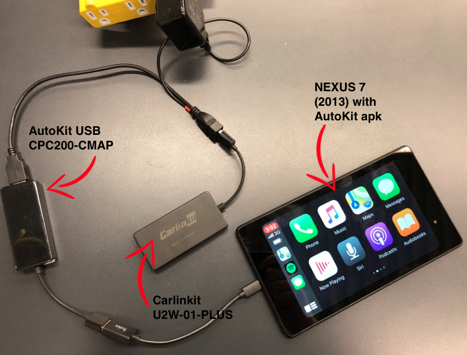

Before I had my Carlinkit working with my Sony AX5000 I was able to test different firmwares on an Android tablet.
It was connected to a 10w USB power adapter, through a USB power inserter and a micro-USB OTG cable to the Nexus 7.
Might be an idea for the guys working on the updated native-looking UI (instead of running out to your car to always test the graphics).
Good idea, but we job is almost done.
Brilliant! This setup will come in real handy...

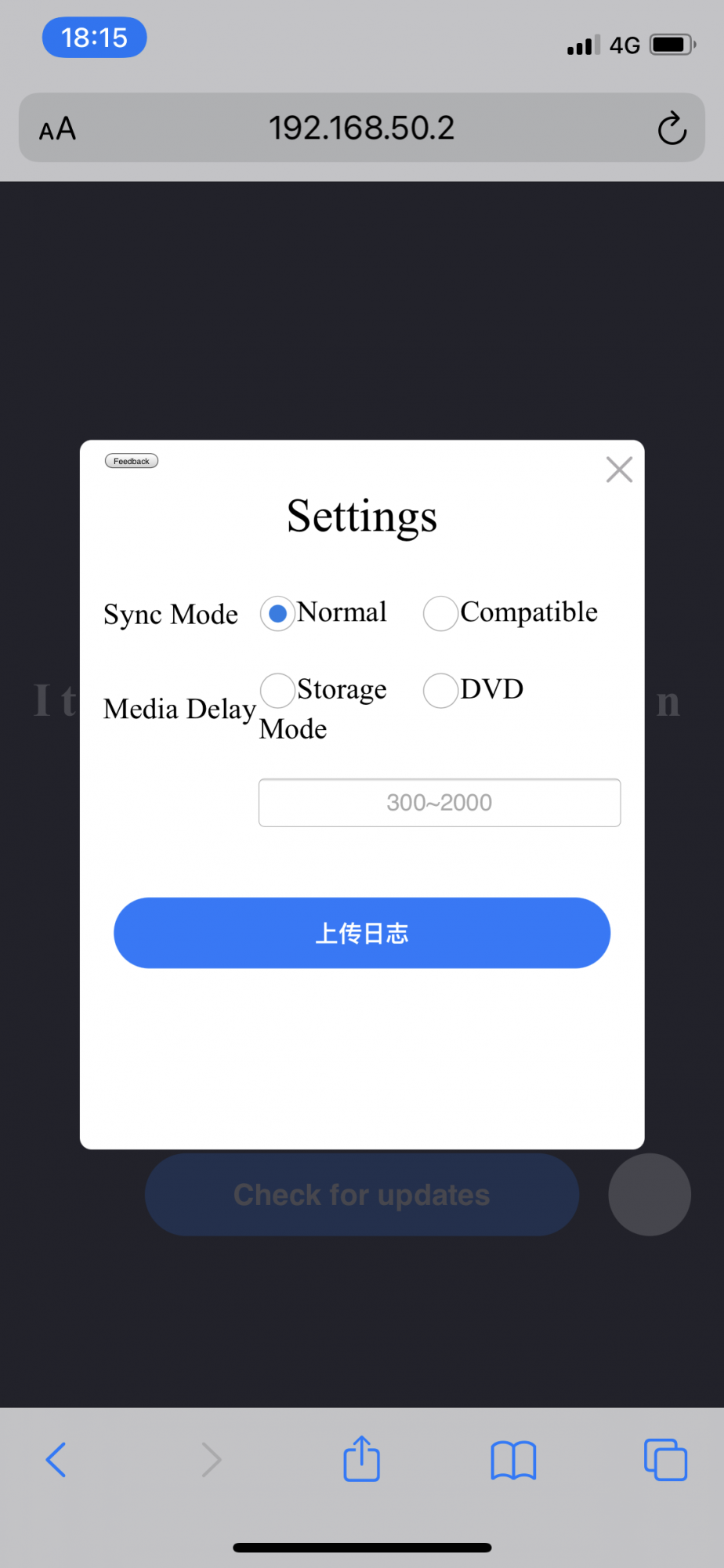

anyone having this issue have you checked the settings in 192.169.50.2 to see if there is a roll back option?
I upgraded to the March stock version but wanted custom so I went into the settings and was able to roll back to November 2020 and then upgraded to Feb Custom FW then to March Custom and then rolled back to Feb custom again.
