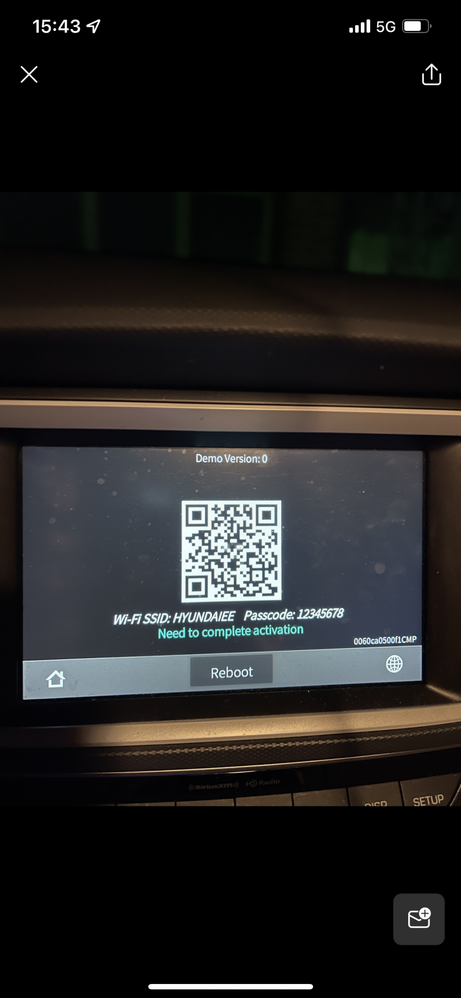

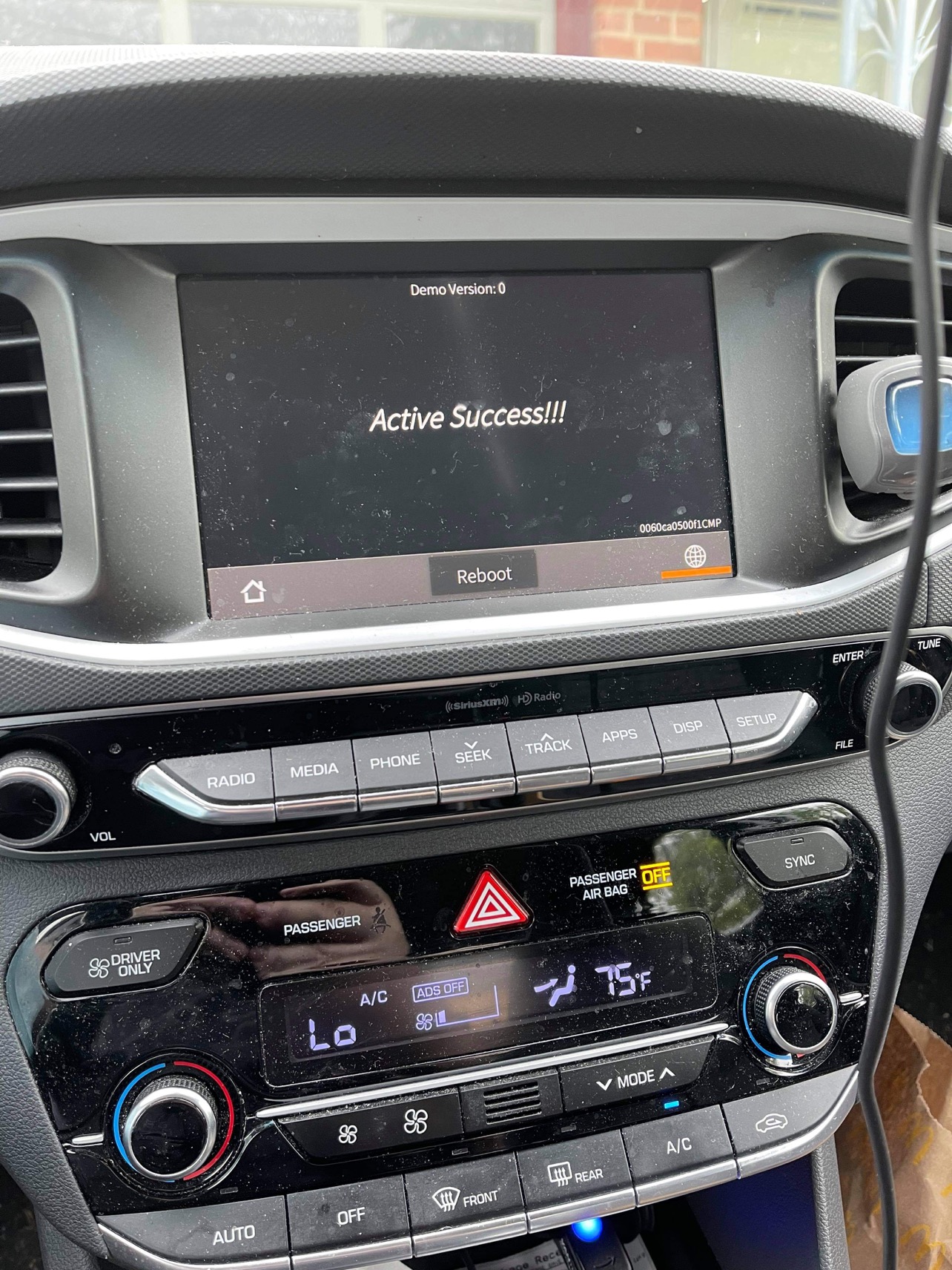

Wouldn’t activate. Wouldn’t update. Even after sending me the file to manually update. They had me try this, and try that. Nothing worked.
Heard nothing from them until the warranty expired. These guys are a joke. 2017 Ioniq.
