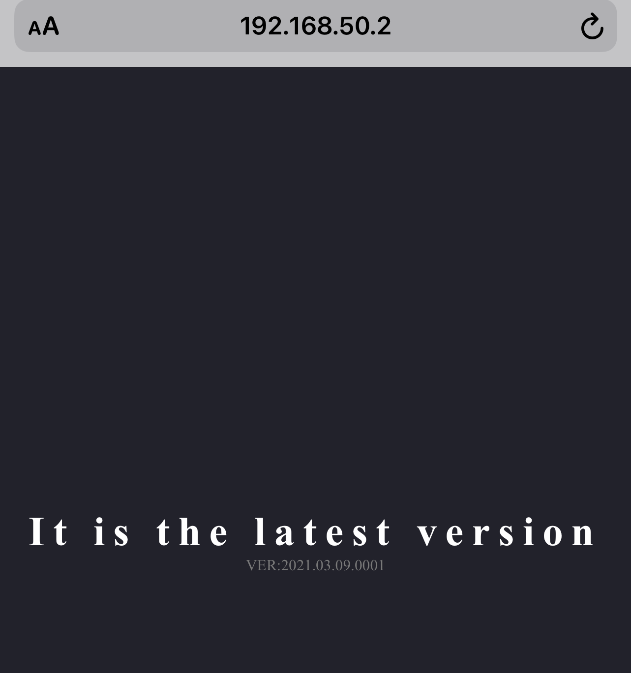

So I've been following this thread for awhile and am having a problem that I haven't seen a solution to. Everything was working just fine up until a week or so ago when my phone started saying the accessory wasn't supported. I hadn't performed any firmware updates on my device. My vehicle is a 2017 Chevrolet Silverado, and my phone is an iPhone 12 Pro Max.
I thought my device was trashed, so tried to update the firmware. The only CFW that I have been able to get flashed properly from a USB device was Downgrade_2021.03.06/ (with the necessary script files).
Of course my device (CarlinKit 2.0) is outside of the return window and the manufacturer wants me to return the item to China for a replacement.

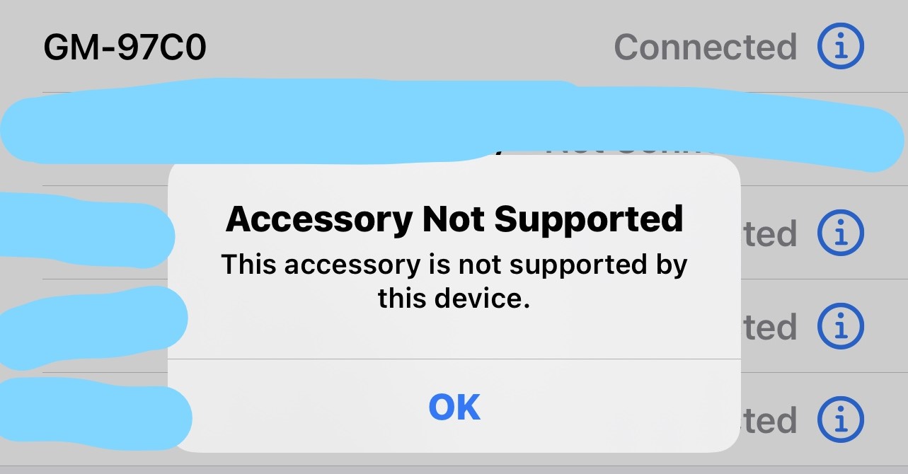

Isn't that a lightening cable MFi recognition issue?
1. Try a different MFi-certified lightening cable
2. Hardware reboot your iPhone by doing a quick click and release on the volume up, volume down, then hold the wake/sleep button until the phone reboots
I am able to connect my phone via lightning cable with no problem. It works with a couple of different cables, and I think I have been able to utilize multiple USB ports with a wired connection. The issue only lies when I try to wireless connect to the CarlinKit adapter. That error always pops up when I try to connect via bluetooth (GM-97C0)--the WiFi connection to the adapter (GM17 I believe) works just fine. In fact, the second screenshot I posted is what I see when I connect to 192.168.50.2 via WiFi in the car.
Edit -- I did go ahead and order some different USB cables to potentially alleviate the concern regarding the integrity of the current cable.
