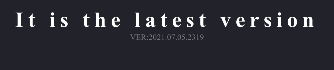

A new FW is available for red UI AUTOKIT:
Code:
${"filePath":"\/mnt\/downloads\/2021-07-07\/U2W_AUTOKIT_Update_2021.07.05.2319.img","fileSize":"10196366","fileName":"U2W_AUTOKIT_Update.img","version":"2021.07.05.2319","updateTime":"2021-07-22 16:06:16","updateLog":"Fix some bugs\nDo not unplug the box when upgrading, please wait for the box to restart automatically"}

Just updated, everything seems to work just fine...😎👍

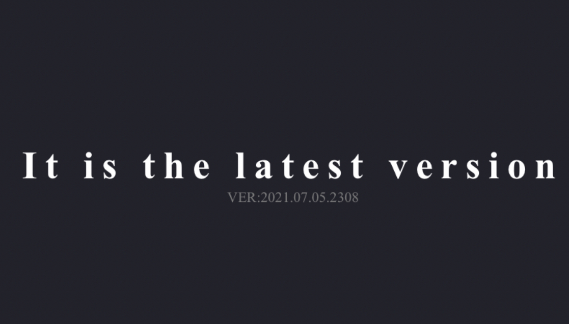

I have updated to 2021-07-05 FW. It is not described fix information details since it is just "Fix some bugs".
then I just used only one day. so it is not enough time, but I observed below
- Reboot after starting around 70 min . This is same phenomenon of 2021-03-06 FW. Not fixed yet.
- Apple Music, Google map, LINE, were no problem.
- I couldn't get any difference between 2021-03-06 and 2021-07-05 on my environment. so 2021-07-05 FW is no problem except reboot after starting around 70 min.
My environment
Mazda Roadster : 2019 / Nov in Japan
Mazda connect : 70.00.351 JP M
iPhone : iPhone Xs / SE(2nd)
iPhone OS : iOS 14.7
Wireless Adapter : Carlinkit 2.0 (USB-C)
- Firmware : 2021-03-06 ==> 2021-07-05
- Setting : Delay 500
- : Background mode ON
