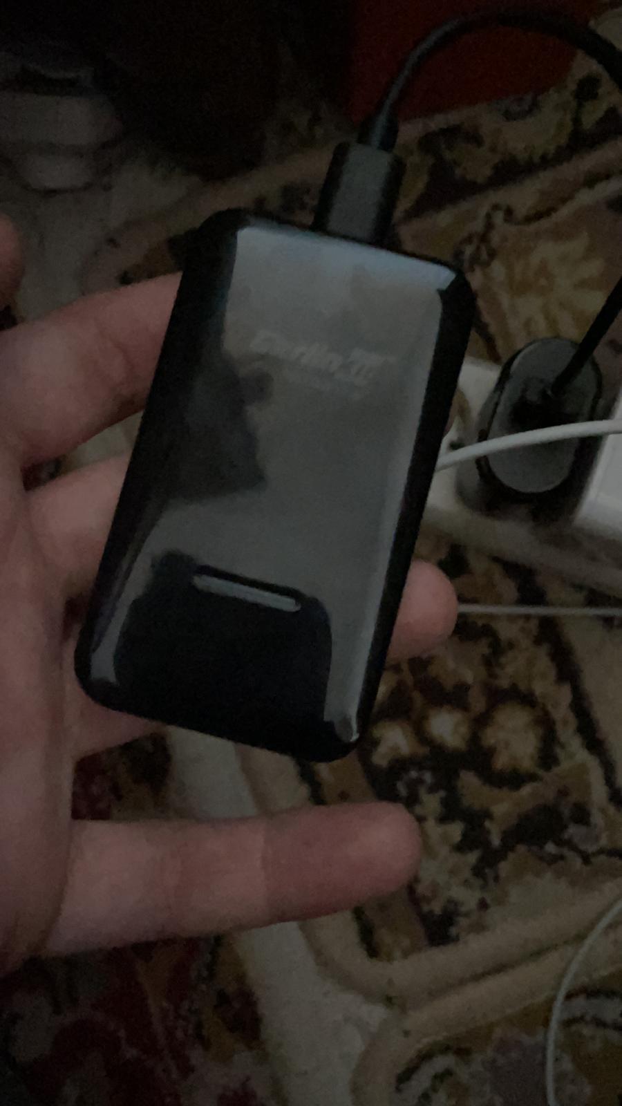

If you're using the Carlinkit with usb-c, a usb-c to usb-c cable won't work. I don't know why. In my Skoda Scala, all inputs are usb-c. I bought an adapter from usb-c to usb-a that is working fine. I have tried a usb-c to usb-c cable to get rid of the adapter which I hoped would fix some problems, but it did not work at all. Currently, I'm back with my adapter that is working.
Did carlinkit work on your type-c input car???
Didn't it work with usb-c / usb-c cable right???
Did it work with usb-a / usb-c adapter???
Your answer is very important to me. Because i will buy on your answer. Thank
I recall way earlier in the thread (last year sometime) someone had similar trouble with a 3rd party cable and eventually realized that the USB connector on it was just barely too thick for the recessed USB-C port on the Carlinkit. So when he plugged it in, it appeared to go in all the way but was just slightly short, so the pins were not making contact.
Can't remember now whether he solved it by looking for a different cable with a thinner connector profile or if he shaved down the one he had, but in any case just wanted to give you that suggestion to look into if you still want to ditch the extra adapter.
So did it work in usb-c car? Can you help me what should i do?

Yes, Carlinkit works on my car (only usb-c inputs). I have tried a third party usb-c/usb-c cable: does not work. It works with usb-c to usb-a adapter. software version 12/10 is very stable, but mic not working. Every version after march 2021: mic is working. However, it keeps crashing.
Thanks for reply. Which adapter are you using? I'll take the same.
Did it work before mic? Is it possible to make a phone call? maybe it can be fixed with software.
I bought a random adapter on Aliexpress, no brand. I think it was under $1.
With the newer software (march and later), the mic is working. However, the dongle has become less stable after that and crashes randomly.
