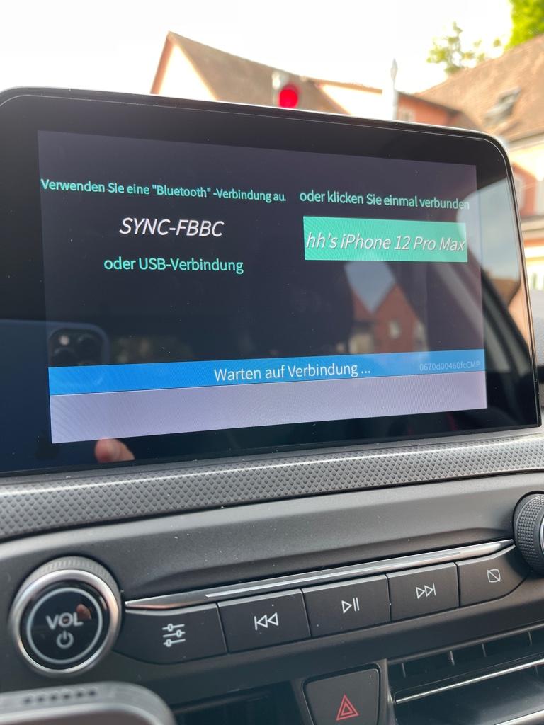

Hi @All,
i‘ve made the OTA Update 2021.07.05.2308 on my CarPlay2air adapter today and since this update nothing connect anymore, car display always only shows the CarPlay2air startscreen: connecting to iPhone 12 Pro Max and this returns in a endless loop.
Does anyone have this problem also and can help?
Hi @All,
What colour is the startup screen, what make / model car, and what is your iOS version ?
Have you tried deleting the adapter from the iPhone and the iPhone from the adapter, then restarting everything?
Startup screen ist blue and green and text with iPhone Connecting… is white, I will make a picture tomorrow.
I have a Ford Focus MK4 with Sync3, newest iOS 14.7.1.
No, I only put the adapter away from car usb and connect again.
How can I do this, restarting means connecting like connecting like a new adapter?

I have just tried all this like your tutorial:
1.
2. it’s not listed there anymore after 1.
3.
4.
but does not help, same start screen anytime for 20 minutes drive to work, both screens change every few seconds in a endless boot.
Is Wi-Fi enabled on your iPhone, and NOT connected to some other Wi-Fi network such as a hotspot in the car?
Are you using your iPhone as a hotspot?
CarPlay connects first by Bluetooth and then uses its own Wi-Fi network to stream the display from the iPhone to the wireless adapter. So if your iPhone is unavailable this would be one possibility. By the way, when properly connected for wireless CarPlay the iPhone will still be showing just a cellular connection (4G or whatever) because the CarPlay Wi-Fi network cannot access the internet - iOS will then be using both Wi-Fi and its cellular data connection…
Yes, WiFi is always enabled and also before this last Update WiFi is disabled on iPhone while it’s connected with carplay2air adapter.
No, i don’t have a WiFi connection from iPhone to car.
Sometimes i use it as a hotspot for my wife but not at this time.
Before this update everything works fine, only sometimes carplay2air does not start but after restart the adapter works.
