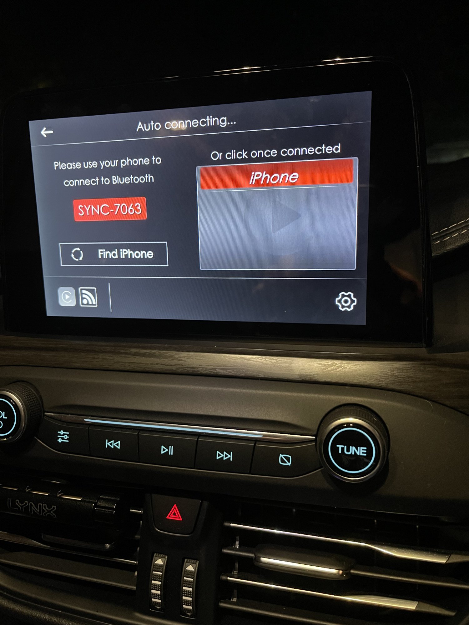

After using few more days.I have encountered connection failure several time. so I have rollbacked to 2021-03-06 now.
My personal impression for 2021-07-05 FW on MX-5,
- Good case : It seems connection is faster than 2021-03-06
- Bad case : My guessing for Carlinkit sequence is ... Power ON->Bluetooth connection->Wifi connection. However for 2021-07-05. After power on , Bluetooth connection seems no problem. but No Wifi signal broadcasting. So connection menu is shown, but it wasn't connected. Once it is happened. I have never recovered again even though I plug off for Carlinkit. It was required power off (Engine stop) for MX-5.
- Bad case was happened 40%. It was no problem at first connection by each day. then once power off (Engine stop) then re-connection again, This bad case was happened 40%. (My rough calculation)
So I think 2021-03-06 FW is best for my MX-5.

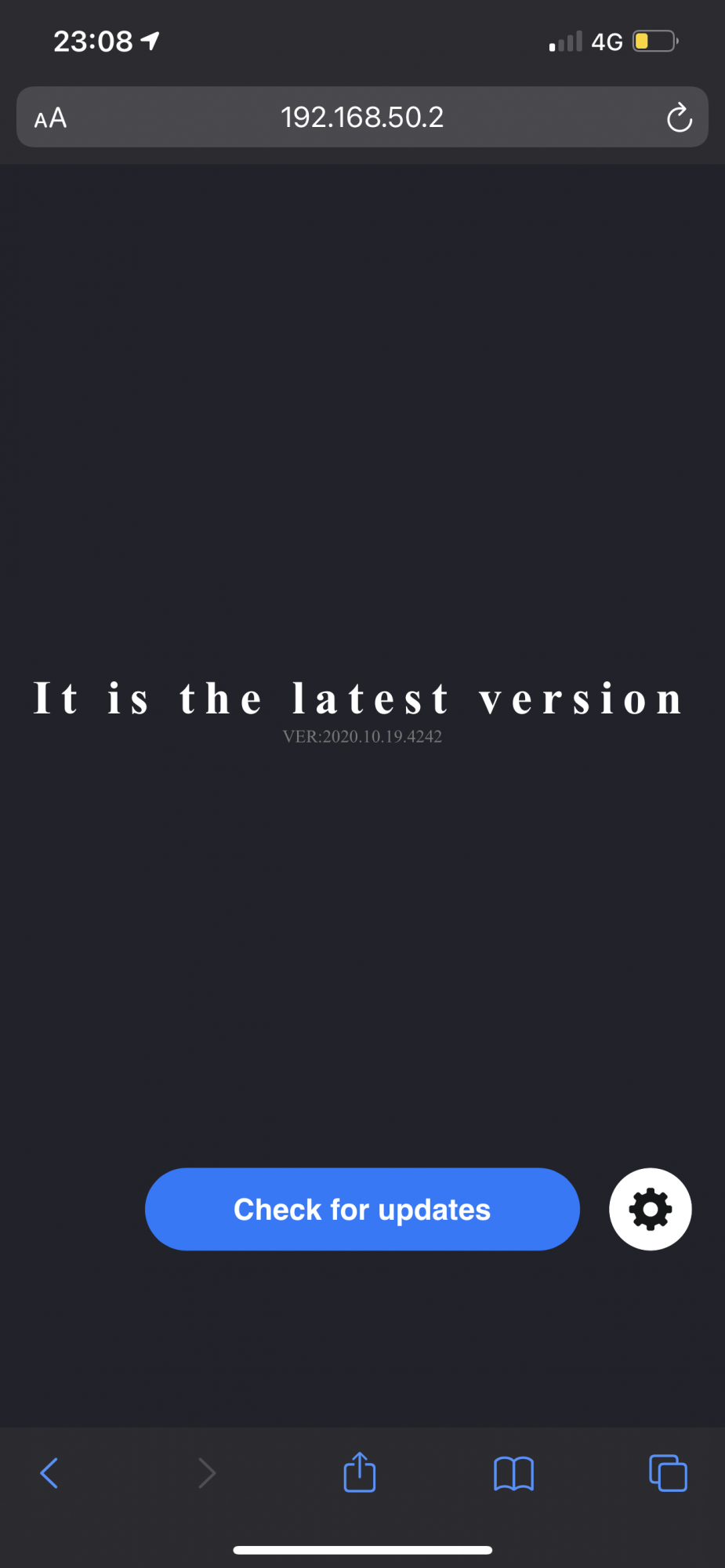

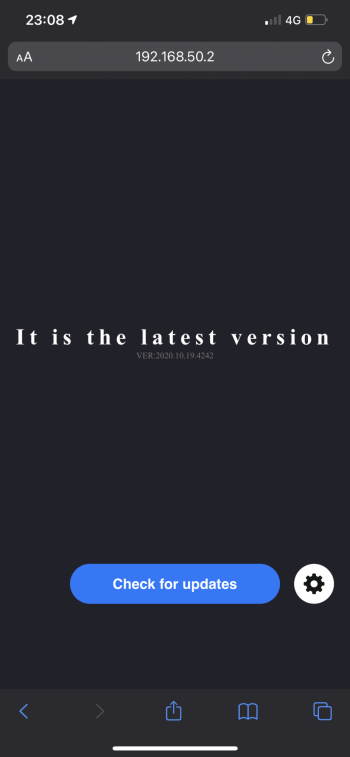

Hmm I’m really stuck too, I’ve got the usbc carlinkit, I’m on red ui custom firmware (below)
Id really like to try get to the July firmware mentioned to see if it helps with some issues, previously it woild offer me it OTA but after running the script on GitHub it just says I’m on the latest when I know I’m not?
What do I need to do from here to get to July firmware? It don’t seem to read file from USB?BA288F54-2E14-484B-AB6E-0661671DAF29.png
What do I need to do from here to get to July firmware? It don’t seem to read file from USB?View attachment 1816346
I suppose your dongle was Custom Firmware 2021-03-06, then now your dongle downgraded Official Firmware 2020.10.19. and you wanted to update to official firmware 2021-07-05. however it is not shown it via OTA. Is that right ?
I'm not sure it is allowed to update to latest one form 2021.10.19. but how about if you update next level by USB ? (2021-10-28 or 2020-11-10 ?). I suppose it is more safety.
See #1 message for instruction, and old firmware.
I have no experience Red UI since I have Blue one. but many user instructed to use file name "U2W_AUTOKIT_Update.img" instead of U2W_Update.img for Red UI. It is only difference between Red and Blue as far as I know.

Hmm have tried that no matter what I name either of the firmware it don’t seem to take it - have tried different USB’s too.
I’m not sure if I’m actually on 2020.10.19 - I ran the usb with the script and it read for a few seconds but nothing else happened, when I put the usb back into computer there was text document saying it had changed the version number but I’m not convinced it actually wrote the new firmware - was too quick

Ummmm, sorry for not resolving the issue.
Just in case, I would like to share #6323 when I did rollback from Custom Firmware 2021.03.06. It wasn't changed firmware at 1st step, but resolved. It was depended firmware version
Again, I have Blue UI. It might not help for Red UI.
To upgrade to >= 2021.03.06 from CFW, two solutions:
  • Put U2W_Update_2020.11.10.2138_ROLLBACK.img on a USB Key and rename it to U2W_AUTOKIT_Update.img if Red UI or U2W_Update.img if Blue UI, then upgrade back to official 2021.03.06. Only then you can upgrade using U2W_Update_2021.07.05.2308.img renamed to U2W_Update.img
  • Put this script (ARMimg_maker & U2W.sh) on a USB Key and U2W_Update_2021.07.05.2308.img and rename it to U2W_AUTOKIT_Update.img if Red UI or U2W_Update.img if Blue UI.
