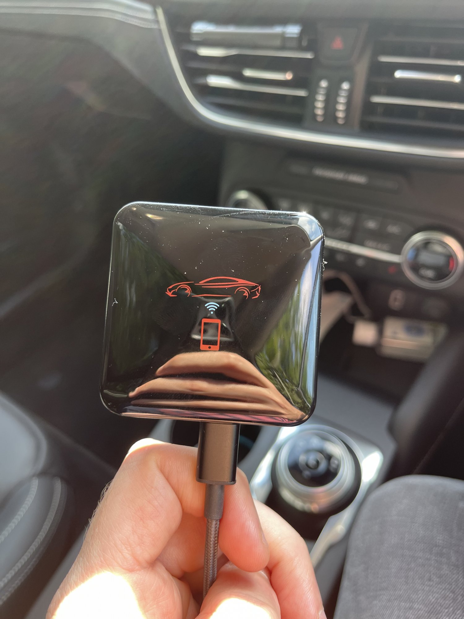

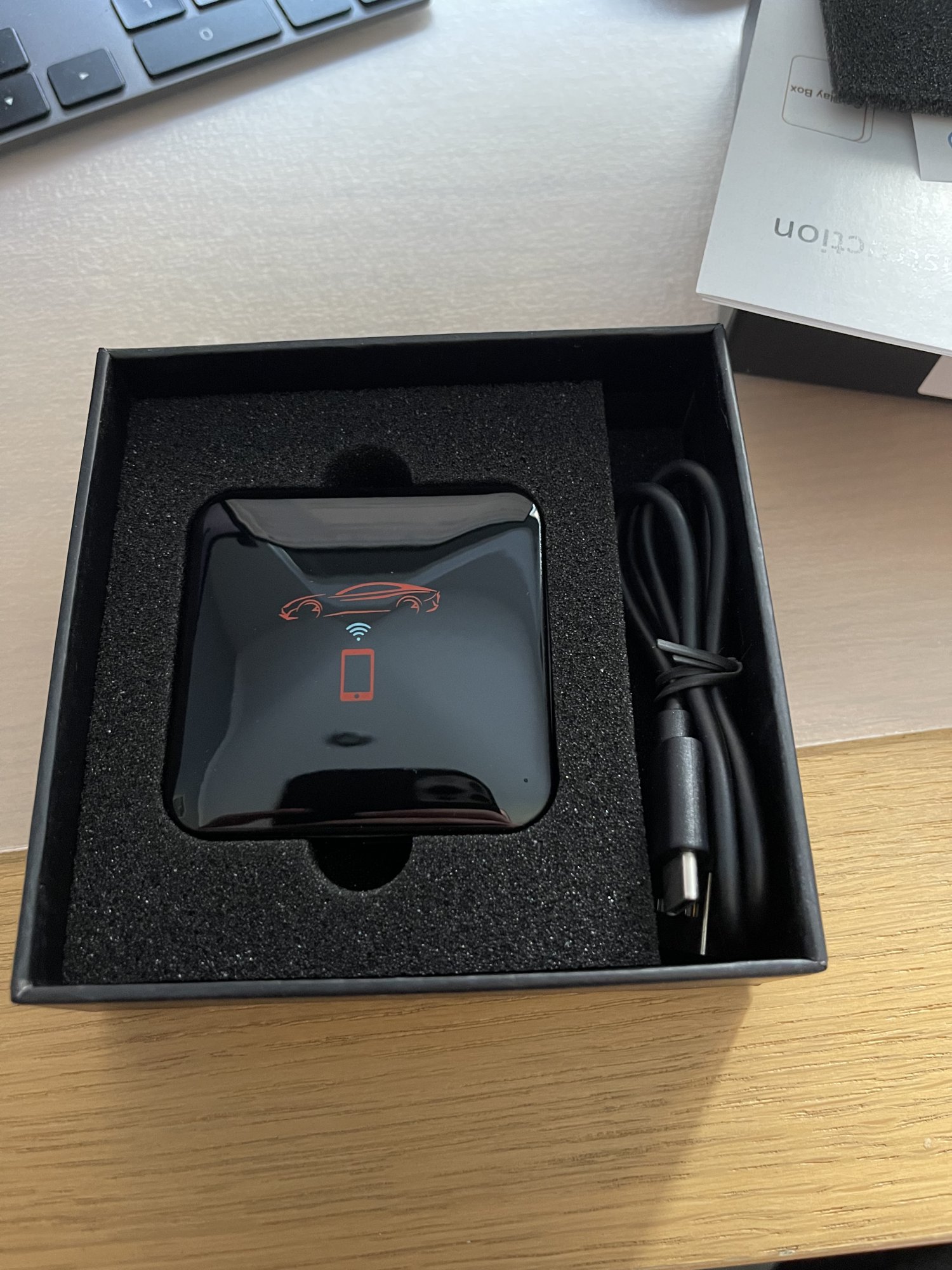

So I bit the bullet and ordered the £30 Podofo Wired to Wireless Carplay Dongle
I currently have a usbc carlinkit 2.0 - with this one advertising it having 5ghz WiFi it tempted me to see if I had an improvement in phone calls lag.

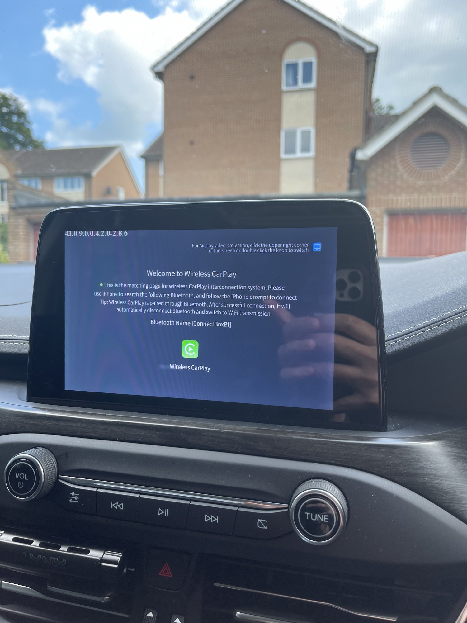

It only arrived this morning so not had an awful lot of time to test it, but I’ve managed to connect it up and all seems to function, it connected to my car fairly quickly once my cars media system actually started - will see how it goes over next few days! Haven’t managed to find a web gui to connect
To / change any settings yet, it don’t seem
To be the default 192.168.50.2
Included a video of it connecting at the bottom too.

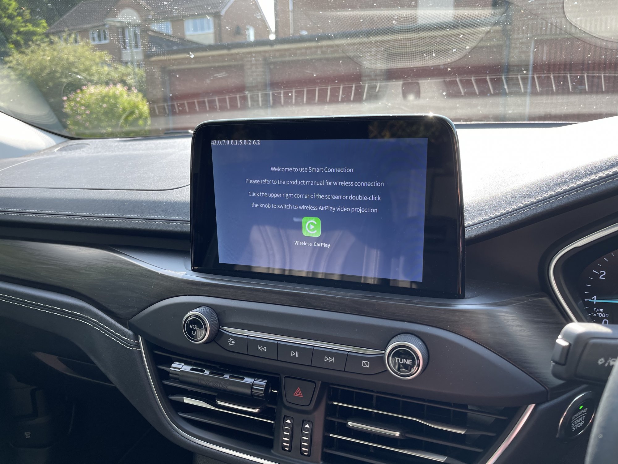

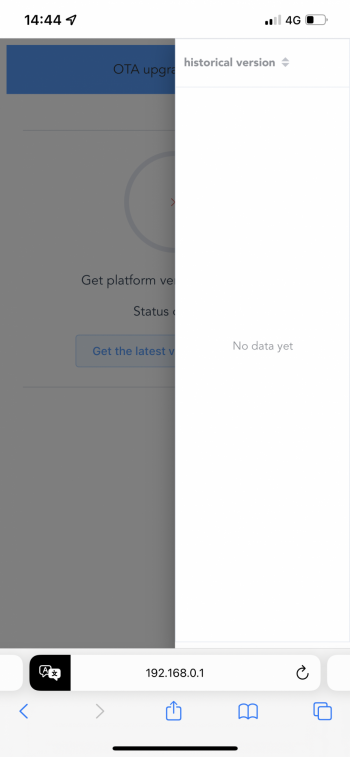

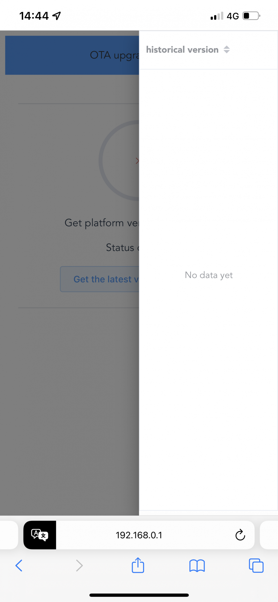

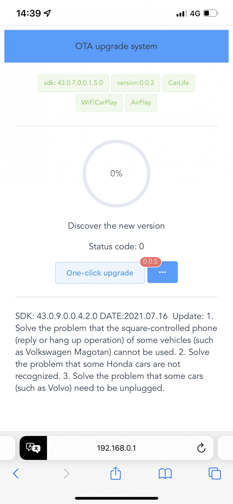

Managed to do a few more tests with it on my lunch break, overall I’m quite impressed actually.

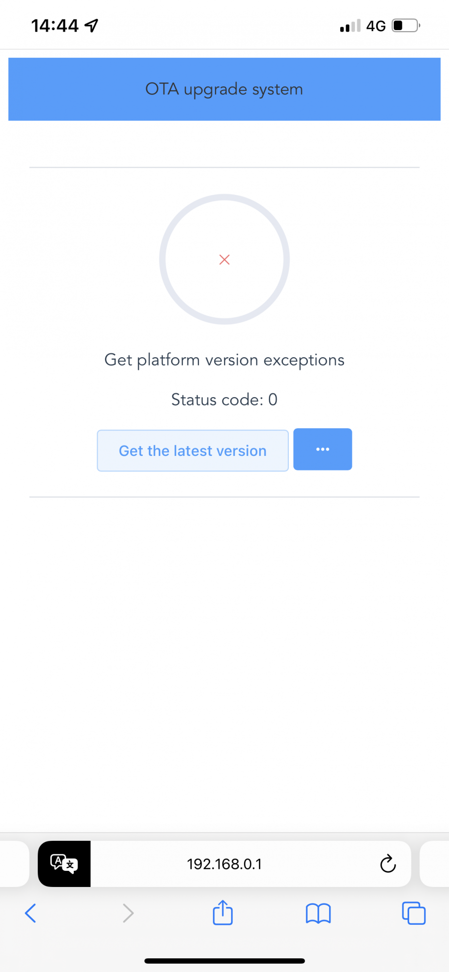

It’s web GUI is 192.168.0.1, I still can’t see any user changeable settings but it did allow me to update, sadly after updating the page seems to error, it did slightly change the splash screen though. There also seems to be a section to choose historical firmware’s but I can’t see that after the update - I will try get there again later. UI is all Chinese but safari translates it OK. The 3 dots was where before the update I could see what seemed like previous versions of software.
Music playback seems good - there’s a slightly lag with skipping songs but no worse than my carlinkit - seeking through tracks does work on my steering wheel which is an improvement over the carlinkit device.
I tried a phone call and I’m not sure if I’m fooling my self but the lag did seem a lot better - but it wasn’t really a solid test if anyone knows a U.K. based latency test number I can call to compare the 2 am happy to do so!
The UI on screen seems responsive, I’ve not taken it through its paces yet with driving / sat nav / music etc but so far am quite impressed with it.

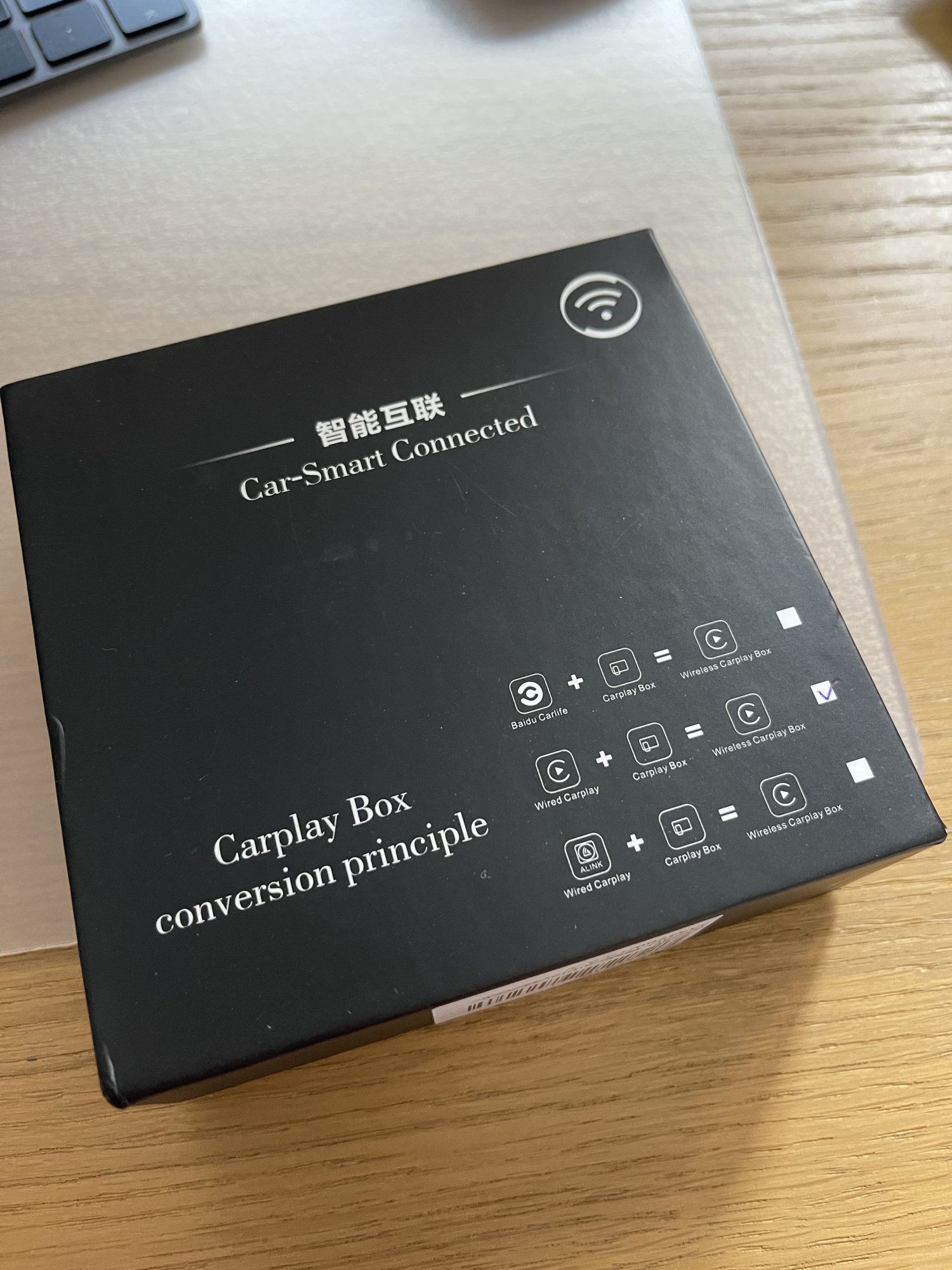

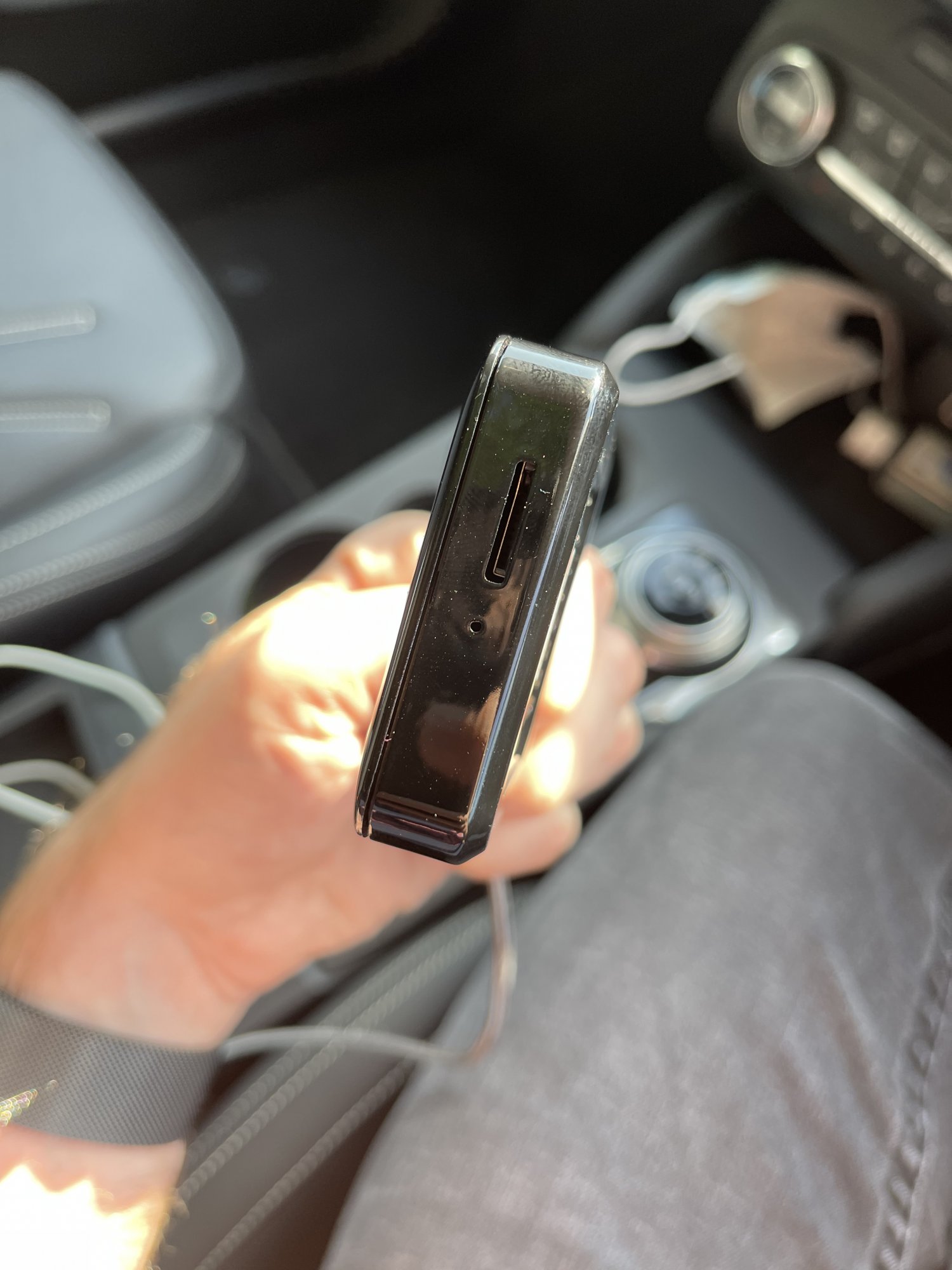

What is that on the side is it a MicroSD slot? WhT is that for?
Any instructions included for model number or anything, sometimes appear on Amazon UK using model number.
