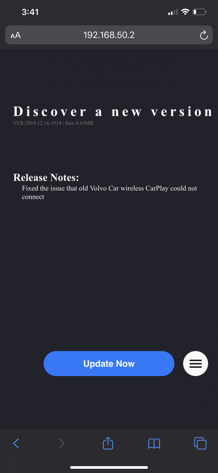

This just popped up in the updates. For anyone with a Volvo. Sadly does not help me and my Mercedes.

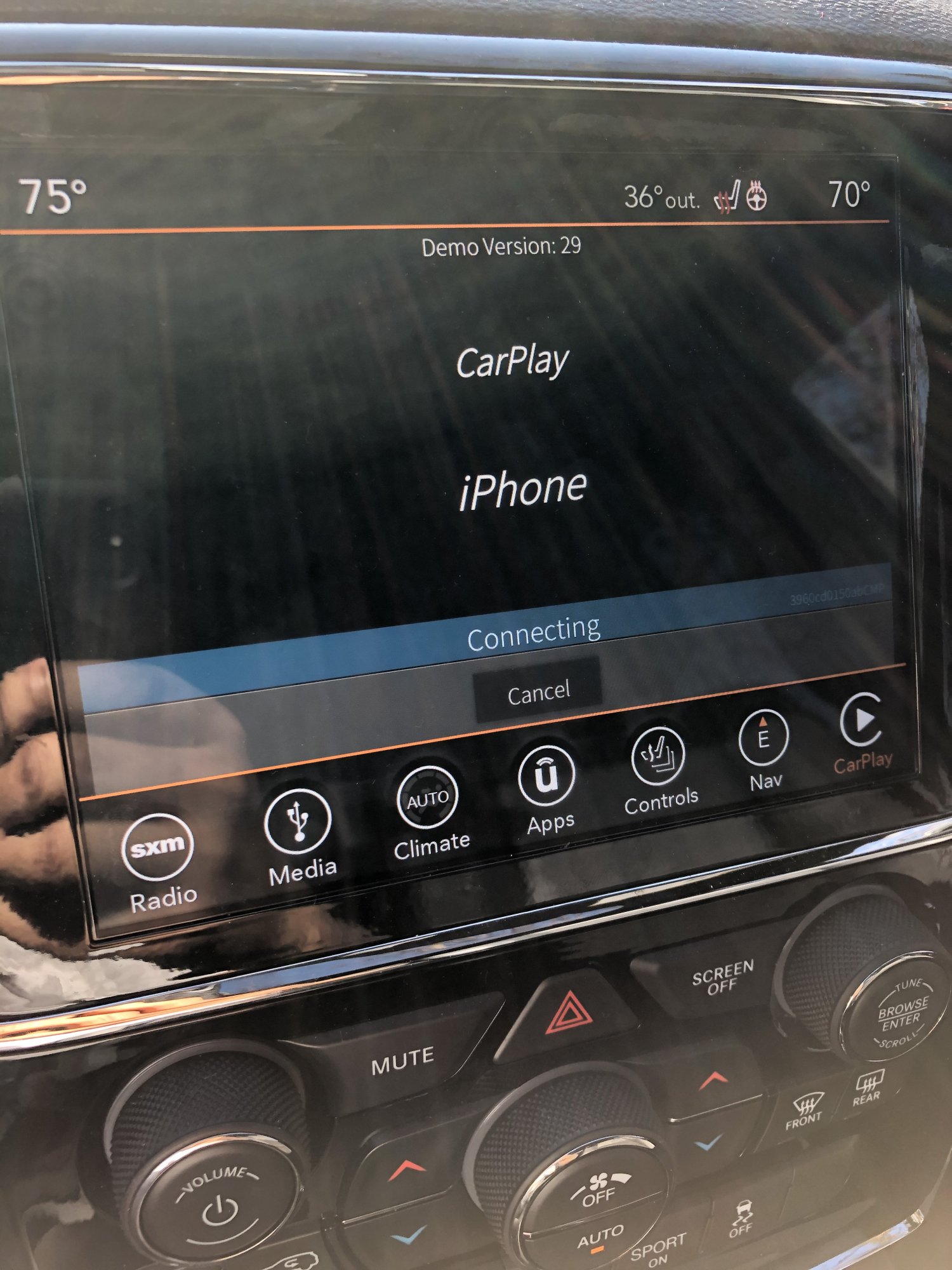

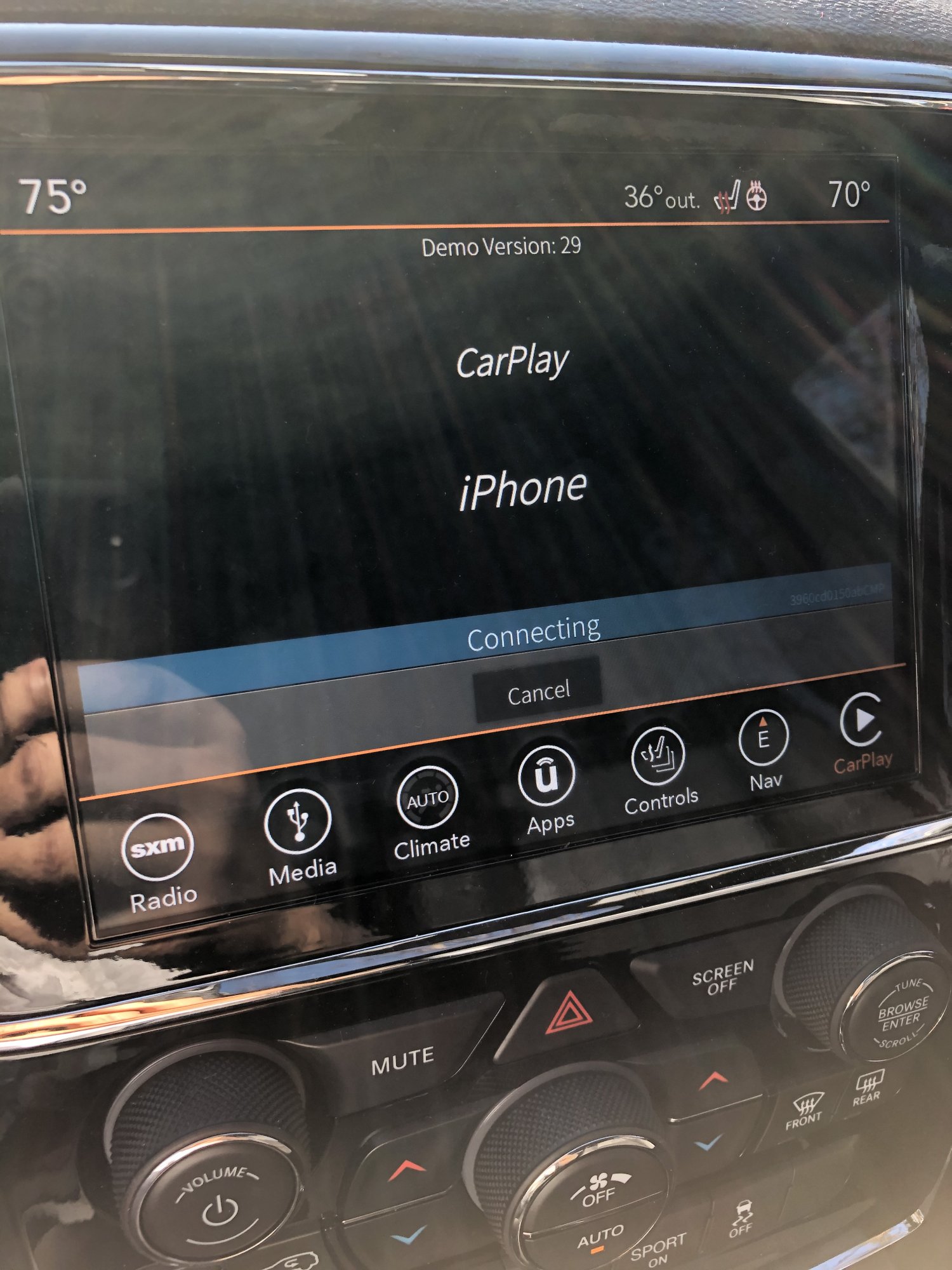

I have a Jeep Grand Cherokee 2019 And this does not work. Its stays on connecting screen and goes no where. Im waiting on a reply from the seller for a refund.

You’re lucky that yours even gets to that screen. My car barely ever manages to load that screen up. Once in a blue moon the screen appears.
While its on that screen unplug and restart (guessing you tried that) but just in case you didn’t.
Also delete the WiFi and Bluetooth connections on your phone and re-pair
My car uses the same uconnect system. When you get in the car don’t touch the screen. Wait a little and it’ll connect on its own and go to the screen.
To the uconnect people. Disconnect the dongle but make sure your not on the carplay/phone screen. Move to radio or something else. Then plug it back in and don’t touch the screen. Wait for a minute and see what happens. Here’s my video on this.

One interesting question: do you have a "Carplay" button on UConnect at all times or only when an iPhone is plugged?
On another note: no reply from "michael".... oh well...
CarPlay button is there only when a wire or the carplay2air dongle is plugged in.
Version 11.11 works well on Volvo XC60!
But heard phone calls etc were not good. Even though I had not actualyl tested this myself I decided to upgrade.

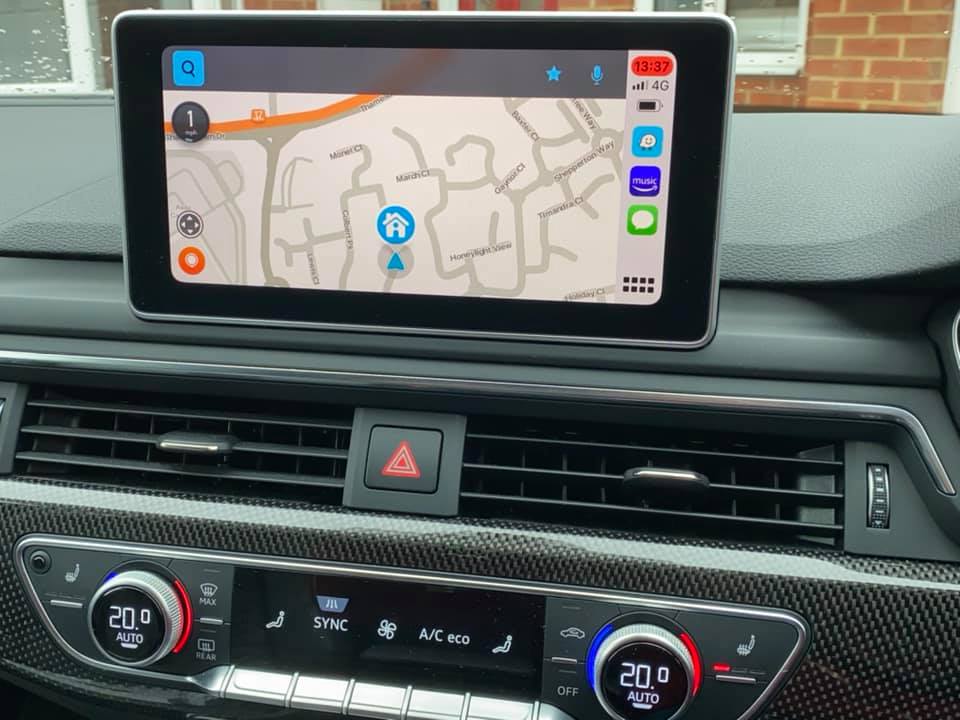

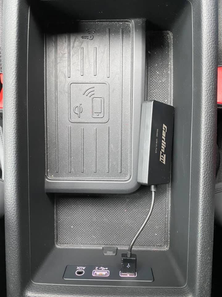

Greetings from the UK.... I found this thread a few days ago, whilst looking at wireless carplay adaptors.

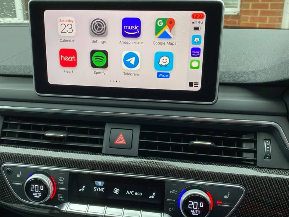

I bought a Carlinkit "wireless carplay activator" for my 2017 Audi S4 with factory (wired) carplay. I got it from Aliexpress - shipped to the UK in less than two weeks, and I paid about £82 GBP for it - a bargain in my view.
(Here's the link if anyone's interested: https://www.aliexpress.com/item/33046258222.html?spm=a2g0s.9042311.0.0.45674c4ddE2kfm )
It works very well indeed - I'm surprised at how good it is in fact. It's running the 2019.11.11 software release - not a hint of Chinese text anywhere (which I was prepared for!) and no issues, no problems, no lag (that I can detect), it's great.
Previously I've been running wired carplay for many months, which had obviously improved with iOS13 and the ability to use Waze, with dark mode and split screens etc. This Carlinkit dongle thing works exactly the same - it's plug and play and everything seems to work exactly as it did when wired. I can now use my Qi charger and just drop the iPhone (11 Pro Max running latest iOS 13.2.3 ) in the arm rest - perfect!

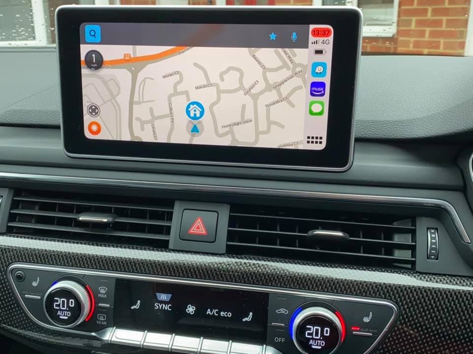

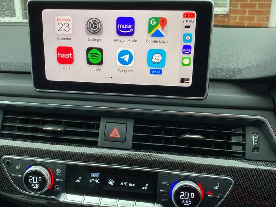

Here's a few pics from my car:
View attachment 879244View attachment 879245
